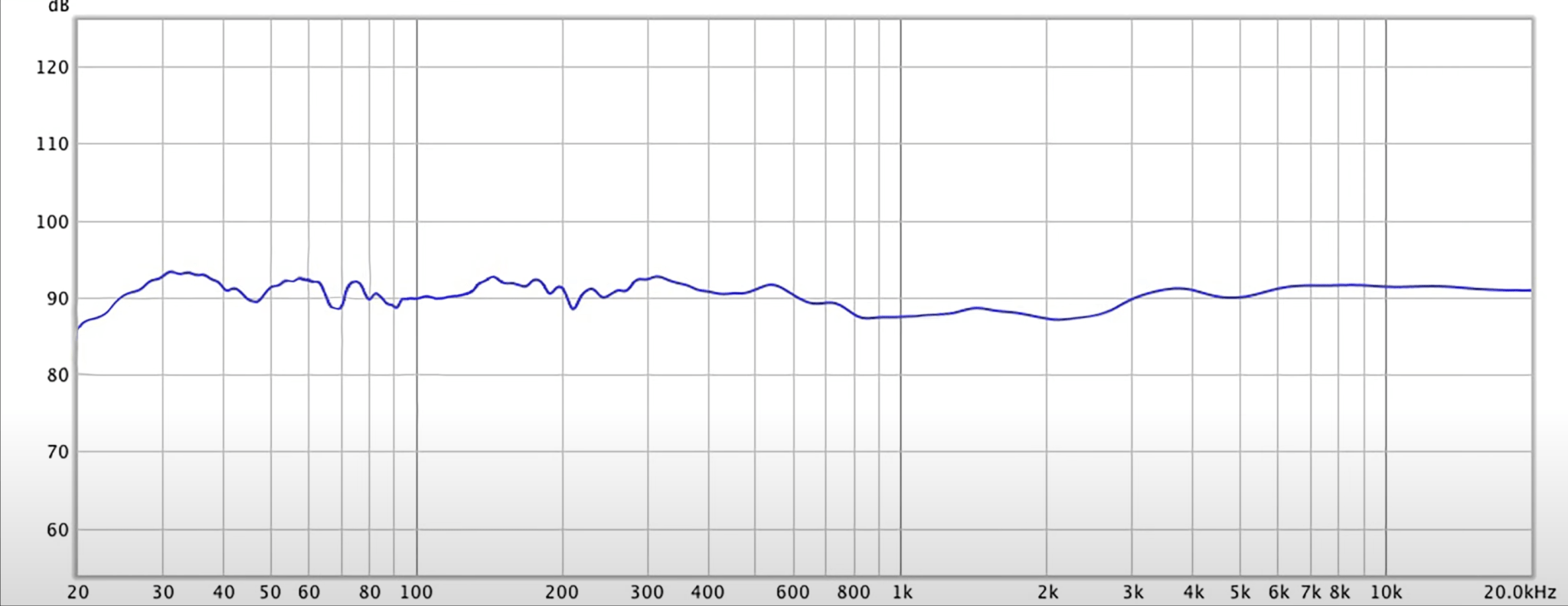

The Philosophy was to simply start by using the best driver that work well together that I could get.
For those looking for some plans you can find the Schematics, crossover design and drivers used in my Crossover Build Video part 1 at 7:35
Also Part 2 build shows all the construction.
The woofer enclosure is 2ft deep by 22inces wide by 22inches high
Midrange enclosure 9 inches widest diameter 7inches mid diameter by 22 inches
There is a possibility to adj both the Mid and highs by + or Minus 3db base on the Rall tweeters position also your room and taste
also some Adj with the Rall foams

One question I do have is, would you expect any type of drooping on the piece that is holding the Raal?
Whats the crossover point between the mid and lower woofer?
Can we see the THD measurements to match this FR measurement?
