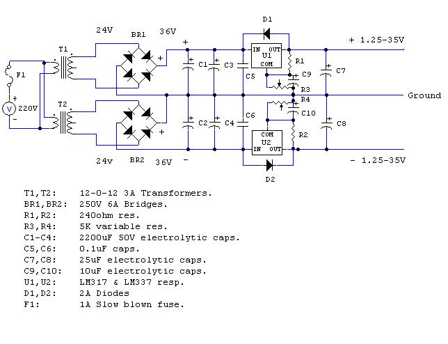

This will work perfectly alright.
And it will give you more than 1 Ampere output (max 1.5A)
if you only have the needed HEATSINKS.
There is not much more you can change in your circuit,
that would give a better operation.
Eventually you can add some little resistor
that can be used to measure the current consumption.
Can be a 1 ohm 2/5watt resistor, placed between the bridge
and the LM317 input.
1 ampere gives 1 volt drop over that resistor.

Hi Deepanger,
It looks good to me, and having been involved right from the start when you first posted about the transformer query, I am glad to see it come to fruition.
Well done!😎
Don't be surprised if you loose a couple of volts or so of max voltage output under full load. It will depend on the Transformer rating and its regulation factor, but in converting from AC to DC the multiplier is 1.414. (24 X 1.414 = 34 volts) and there is a loss of say 1.2 volts caused by the diodes to take account of too.
It will entirely depend on the transformer's parameters, and your local voltage supply, but if everything is accounted for, you should see a minimum of about 33 volts with the transformer fully loaded, at the reg's *inputs*.
Of course, there will also be a small voltage drop through the regulators too, which will depend on current drawn and temperature to some extent.

really glad to hear ur comments..
but what about the fuse?
ive placed a 1A one due to some calc. but amnt sure of it...
what do u think?

deepanger said:really glad to hear ur comments..
what do u think?
Apart from making some rudimentary calcs (like you have done) to get into the right ballpark with fuses, I rely on subsequent trial and error.
Fuses can blow in rather unexpected ways, I found years ago, and you have different characteristics with fuses, of course, to cope with different circumstances, like quick-blow, and time (or delay), or anti-surge, to cope with high switch-on loads.
Generally, with any new circuit, I will find the right area to work in, and then deliberately try the 'worst case' circumstances, to see if it will blow.
If it doesn't blow at all, I will try a lesser value until it does, and then go up in value a small amount, for the final choice.
This is the most practical way of arriving at the best overall result,
which will give safe protection, but not too many blown fuses which are an inconvenience.

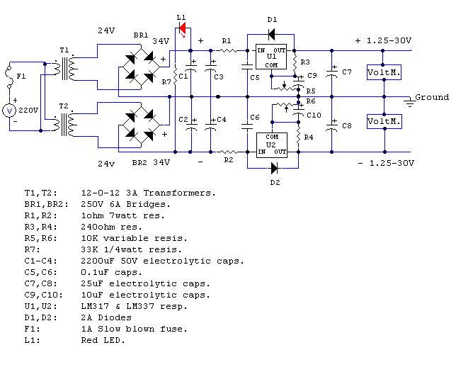

Re: Final Schematic
A BIG, BIG problem is WHERE to put the LED.
It is this question that makes the GOLDEN EAR AUDIOPHILES (you know which ones I mean 😉 )
sleepless at night.
I would put it just after the rectifier.
Use one 33kohm(1/4watt) Resistor and a normal RED LED.
Put them in series from +36V to -36V
gives about 2 mA in the LED.
This will serve as an ON-indicator.
/halo - can NOT HEAR this LED - but here are people THAT COULD !!
- that's for sure 😀 😀

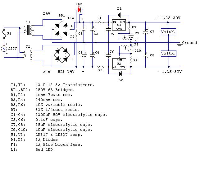

Now,deepanger said:here's the final schematic for anyone intersted..
but plz review it and post any corrections, recomm.,..etc
sleepless at night.

ive to know the resistance of the LED to calculate the other
resistor value. but ive tried to mesure it with my AVO but get nothing,imean bigger unknown value than 2megaohm!
so whats the LED resistance?

I do not measure resistance of LED.
A LED is a diode. It has like a diode a typical voltage.
At some few mA (2-5mA) it is about 1.50-1.60 volt
over a Red LED.
I test it with diode-tester.
So if we put 72 volt over a 33kohm+LED
there is 72-1.5= 70.5V over the resistor. And 1.5V over LED.
70.5V/33k = 2.13 mA will flow.
over a Red LED.
i wanted this! 😉
thanx..
You might want to change the direction of that LED. I would also put it after the regulator so that you see when the regulator fails to no ouput.
UrSv said:You might want to change the direction of that LED. I would also put it after the regulator so that you see when the regulator fails to no ouput.
sorry, i always ve a wrecked brain with those basics
btw icant place the LED after the reg. since the output volt. is
variable, in the same time ill know if something goes wrong from
the voltmeter..

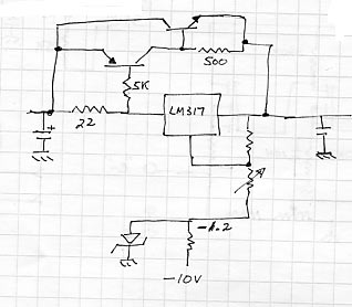

this s a current boost circuit?! i see it somewhere...jackinnj said:try this, pasting together from Nat Semi's website (I actually use this in a POOGE'd Heathkit IP27 power supply.)
what r those transistors?!
