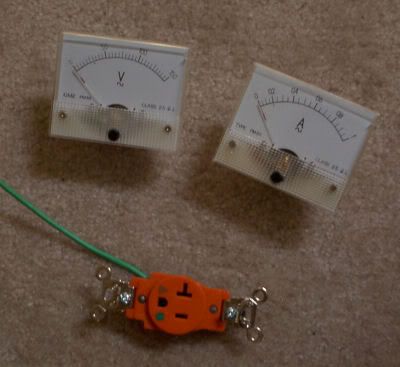

Leviton 8310 Isolated ground outlets and Panel meters to measure AC Volts and current. I tested the voltmeter on my wall socket 125V rock solid 🙂
Of course a project of this magnitude can't be worked on alone.. Here's Cassandra inspecting the panel meters to make sure their operating correctly.

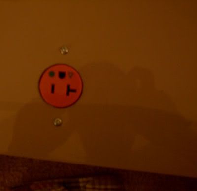

Test mounted the first socket, the hole was cut with a 1 3/8" bi-metal hole saw...
Looking pretty good so far, I'm still waiting on the filters which should arrive tomorrow and then I'll hopefully have one working socket to test 🙂
