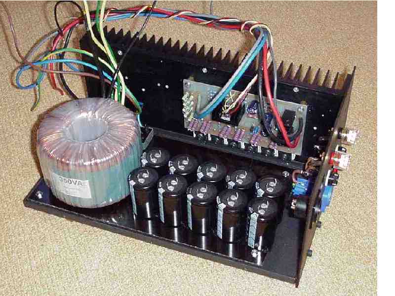

My baby is hot ,very hot too hot for me.
I can't even touch her.
Perhaps she need a bigger......
...heatsink??
OK anyhow:
¸TEST A5 monoblocks (without exotic parts- resis., semiconduct., caps.ect) in sort-of test enclosures.
- PCB own design
- Heatsink dimensions 30 X 12 X 4 cm
PSU:
- 2 X 35A/200V Bridge
- 2 X 27 V 350W Trann. + CL 70
- 2 X 50kuF this moment without Pi filter ( 2,2mH)
- 2X 36 V Rail
Power Mosfet resistor:
- 2 X 2,2 Ohm 2W Noninduct. parallel ( 0,575 V )
Output resistors:
- 8 X 1 Ohm 1W Noninduct. parallel.
Tomorrow I will check HS. temp with termometer and find possible oscilation with scope!

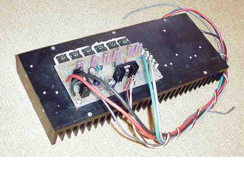

sinks do look a little small... put a fan on them or find a bigger
sink. FET spacing looks to small too. It would be nice if you had
2 more sinks just like that... split your fets between them with
more spacing...
the quality of your work is very nice though!
heat sinks... can never be too big!!
good luck,
m.

I would split up those devices and double your present heatsinks.....at least.....

On some tests I did last year on heatsinks I found a fan would improve the heatsink perfrmance by a factor of 6. Yep, six times as good. I have dumped as much as 350 watts
onto a 100mm x 100mm sink with a 90mm fan going full blast, but that was really the outer limits.
Yeah, of course. Fans are awesome. But more importantly I see a lot of designs on this site with the transistors all in a line. This is a huge waste of the heatsink's ability. Space them evenly on the surface of the sink, and you will get much better performance.
The transistors in the picture above are WAY too close together. Most of this heatsink is wasted.
jwb said:Yeah, of course. Fans are awesome. But more importantly I see a lot of designs on this site with the transistors all in a line. This is a huge waste of the heatsink's ability. Space them evenly on the surface of the sink, and you will get much better performance.
I did some testing with thermal calculation software and there almost no difference in placing the mosfets when you have thick enough back plate (>10mm will do) . There was only a 4 degree difference between the mosfets in placing them in line and all spread around... hardly worth the trouble in wiring, buy more heatsink to compensate this!
I did some measurements on my running Aleph 4 and there is almost no difference between the left, the top the back and bottom when all is in balance after 60 minutes of running... All is hot! 🙂
Ofcourse his mosfets are a bit too close and his heatsink look too small...

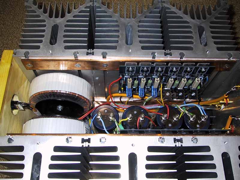

I myself did a aleph 5 with more sinks here is a pic
only two of the sinks are getting hot by the fets.
the final temp is about 50ºC or so, after a few hours.
too bad its too small.
I would explore the fan possibility, since your amp is so cute!!

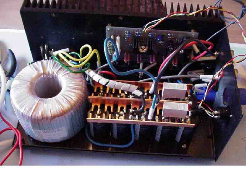

Hot baby!!
Guys, thank's for ideas and suggestions
I would explore possibility to substitute transf. with new one - intent to use for A3.
Than I will pull-out 2pcs. Power Mos. from PCB and replace:
- Pow. Mos. resistors with 0,47 Ohm.
- R17 with 1K5 Ohm
- R19 with 47K5
- R 21 with 820 Ohm
Similar like a Aleph3 value.
I intent to keep Balance input configuration.
I HOPE 😕 that Heatsinks than will be suitable.
Pls for coment!!
Thanks in advance,
jazzy
