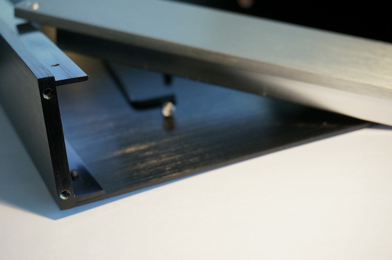

Considering the "2205 preamp chassis" on ebay for this B1 buffer preamp build -- what do you think? (you can just type that search string in quotes above on ebay, to see it).
It's $40 from china, full aluminum. Black top, sides and back, and silver aluminum faceplate. It's 220mm x 52mm x 191 mm (external dimensions).
Has anyone had experience with these enclosures? Worth getting? Seems like a really good price and they look nice.

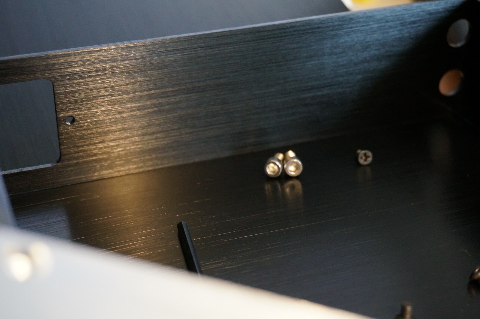

try to find a pic of what the "holes" look like where the front and rear are screwed to the side panels.
Some are just a "U" shape in the aluminium extrusion, with a thread cut into the U.
A round drilled hole with a thread cut after is a far better fixing for the screws.
I have this exact chassis 2205 right on my desk. I had my good buddy buy and carry over straight from China when he was there visiting. They go for about $10 US a pop plus couple bucks for domestic shipping. Kind'a like a steal.
Decent quality and good looking, but definitely nothing capable of taking abuse. Andrew has legitimate concern about the structural strength. The threaded holes on the side panel extrusion pieces for mounting the front and rear panels are indeed full threaded holes, but they are tapped into the thin material. I would allow my cat to sit on top of the case but not much more than that🙂
The top, bottom, and rear panels are all 2mm sheet work, not a problem except the rear panel feels flimsy, WILL and DOES flex when you plug/unplug cords. You would certainly want to put in some angle alu to enforce joining the real-bottom and the rear-top. You will need to drill holes and tap threads, and countersink the new holes on the top panel for flat head fasteners to go flush for good looking and not scratching the behind of a cat.
