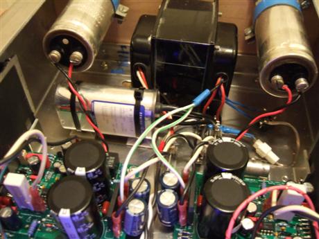

more supply cap
I guess I can post this here. I just added these stm caps, 6800uf. They were the total ps caps of a 400 watt phase linear amp. I
a-b'd the channels with the same input and there is an improvement,a fuller sound,better defined bass. Early days yet, will try bypassing with different values metal poly caps.
cheers
doggy 😀
