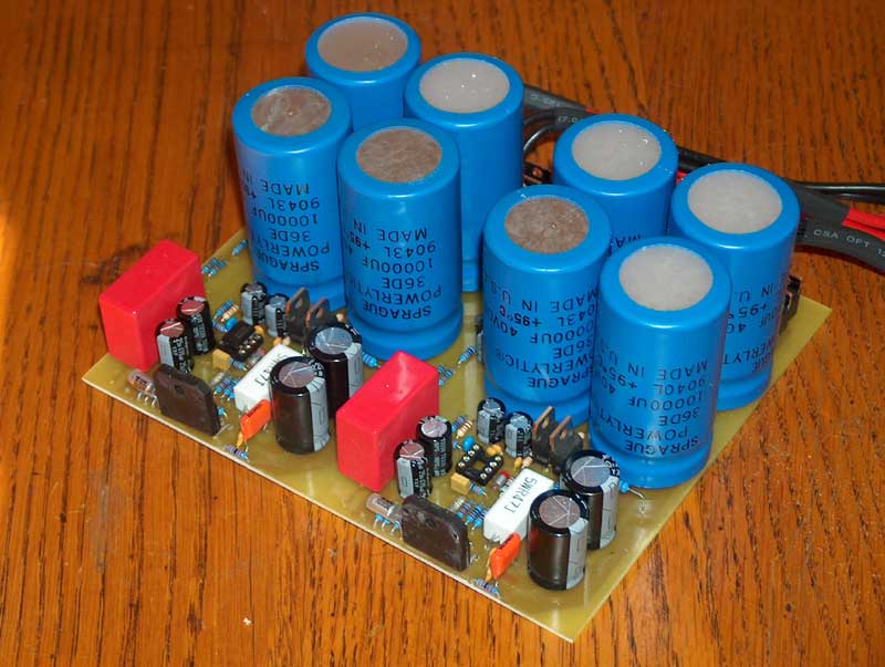

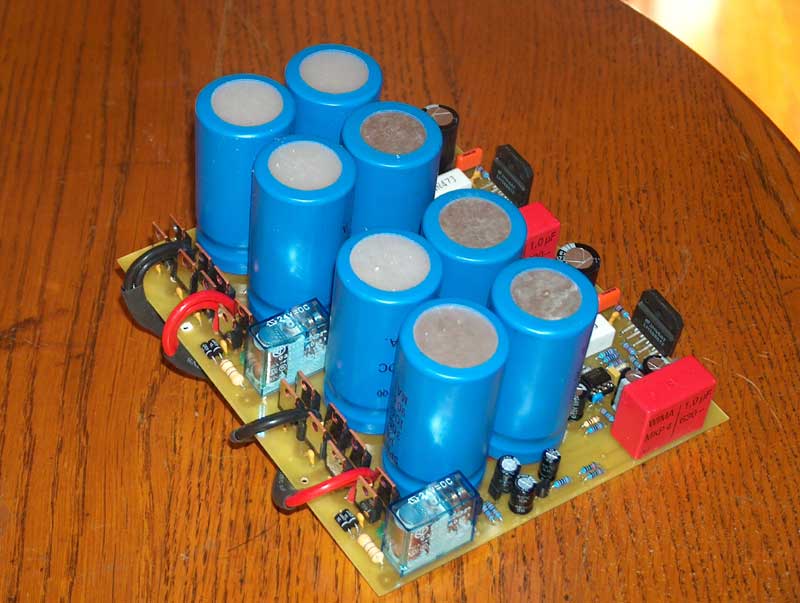

I just finished mine last night...giving it a little time to settle before any serious listening; but if first impressions mean anything, it is going to be stunning. Powering a pair off a 25V 400VA transformer...plenty.
Just wanted to give a big thanks to mauro and the twistedpear crew for doing all this!
Happy holidays and happy listening
--Scott
Congratulations Scott! If its anything like mine it sounds great from the first moment it turns on. It appears its a pretty robust kit, at list through the building stage.
Post a photo of it if your get a chance to add to the Penasa MyRev collection.
George
Well i have the X-Calibre (the MINI with a V8 engine :devilr: ) running and first impressions.
Very, VERY Clean. Soundstaging is very good. all over. AWESOME very close to being there, just thought I would let you all know 😀
