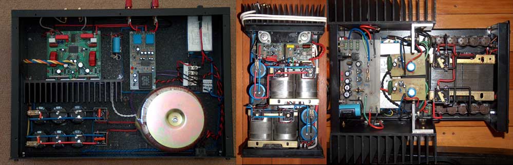

interesting powering scheme
Rudi,
What is the type of thinking behind the scheme. What is the advantage expected from crossing between the two trannies?
Did I understand it correctly that you did a dual supply scheme for the two channels? I would expect that you introduce crossoning effects between the two channels again?
Thanks for sharing your thoughts
Regards
earsandeyes
Rudi,
Regards
earsandeyes
Rudi,
I appreciate very much Your findings, and I have noted from the beginning Your true dedication to this nice design. Also the fact that you are producing your own boards for it, but in accordance with the original design. Bravo! And what you find is interesting without doubt.
But, please, don't repeat any more "those noisy zeners"... Please, go and look up carefully the findings of Christer in this regard, and You will see that actually the lowest possible noise reference [yes, lower even than green / red leds] is a 12V zener, measured & confirmed many times by Christer.. The noise of an 7818 with 100uF output cap is several order higher. Also, the dynamic resistance of the 7805 is lower, so can not even filter it out afterwards.
Read also the pdf here
So, You can well have better results by changing something in such a complex configuration, but surely for other reasons than the noise, if you have better sound out with much worse noise on the supply.
The other thing which is not logical for me, that why do you not separate totally the power supply with two transformers? Also here, what you did is including one more element, the diodes, in the common path for two channels, which was separated before..?
And also the transformers remained in the common path?
I would understand this, if it would be a necessity, because you have two transformers with half AC voltage. But then it's not a tweak, it's a local patch?
Or did you have special reason for doing that?
Otherways, a much interesting report, thanks!
Ciao, George

hi earsandeyes
well first of all you are seperating everything. you do not have X talk between positive and negative.
you do not have interactive forces within the transformers seeing that they only supply one specific rail each
the dual bridges seperates it even more.
but i can be completely wrong, i am just speculating and there is alot of different opinions out there. I am only sharing my experiences and what i found to sound best.
cheers
Rudi
cheers
Rudi
Rudi,
Pardon me, it was not up yet your scheme when I started to reply.
So what I said about diodes is not valid. Do you have any idea why it can be better this way than just two transformers?
Ciao, George

Hi George
other than the fact that you have a no interaction between the two transformers, i have no idea. if you have a trafo per rail the sound is less open.
it is the same thing that NAIM had with there power supplies. they run the one secondary out of phase with the other and they get better bass this way. i have tried it and it works. but nobody can explain why
cheers
Rudi

power supply question:
Rudi: do you think that 2 center tapped trafos could be used with the same effect as trafos with dual secondaries?I am still learning. how could the center taps be wired?
cheers;
doggy
cheers;
doggy
doggy said:power supply question:
cheers;
doggy![]()
Short answer, no not really, not unless you did some trafo mods(which would not be too hard) and made your center tapped trao a dual secondary trafo. 🙂
Honest answer though, try it as it is first, I doubt you feel the need for the mod, but if you do, at least you will have a reference, but to be honest unless you can do a direct A/B test it will be tough to guage the change.
Remeber that the trafo quality itself can color a test quite a lot. Also Toroids will give you different results than other types of trafos. For example with all the speakers I have tested and a singfle 300VA toroid per channel I have crystal clear mids and I have never heard tighter bass(even down lowwwwww) 😉. Now remember that is with a PCB that is not the same as Rudi's.
I actually fully trust Rudi's review and he has been very straightforward and reliable in the past, I just don't think he is listening to the same amp I am because mids and bass are very much strong points of the REV_C monoblocs I am listening to. Now Rudi has some very cool speakers, mine may indeed not be as sensitive as his, but they are no slackers. 😀
I would like to see what the other beta builders think as well, but I dont see how any mod could get you significantly better performance (I have tried). Sure there are certainly small gains to be had here or there at the cost of more components and greater expense, but there is always a point of diminishing returns.
Remember that we hobbiests tend to color our opinions a lot by the amount of work we put into something. I certyainly find that to be true. It is human nature. It is very tough to be totally objective. Some would say impossible. 🙂
So please don't take my word for it (or anyone's really), my opinion is just that. Find out what yours is, but it is good to start with some baseline, and then compare to things at the same time. A/B tests(particularly blind) can be very revealing. 🙂
In any case all this discussion is excellent, and great food for thought. If you read a lot earlier in the thread you will see Mauro's characterization of his choices for PSU components, agree with them or not, they have proved very sound and they are based on very sound engineering. I think this has really been demonstrated by scores of happy builders. 🙂 You can take the freely available PDF and etch it and have yourself one heck of an amp.
I was actually very very skeptical of the zener regulators, but I find that I was dead wrong now that I have tried 78xx/79xx and 317/337 combos I can say that mauro hit the sweet spot of simplicity with excellent performance, sure they used less current, but the audio performance was not improved substantially(some listeners thought it worse some better) so I was left scratching my head. I will try the seperate trafo mod as it is easy enough, but would I expect a huge improvemnt... no. Some... Yes! Does this make it worth doing sure!!! To some people like Rudi and I even little incremental improvemnts can be very rewarding, even if only a select few ever notice them. 😉
Nothing will ever keep me from experimenting 🙂. Thats what DIY is all about. So those of you who are doing these kinda of mods, I love it! It helps keep things alive and interesting. 😀 We all just have to keep in mind that your milage may vary. 😉
So cheers to you all and happy modding. 🙂
Russ
