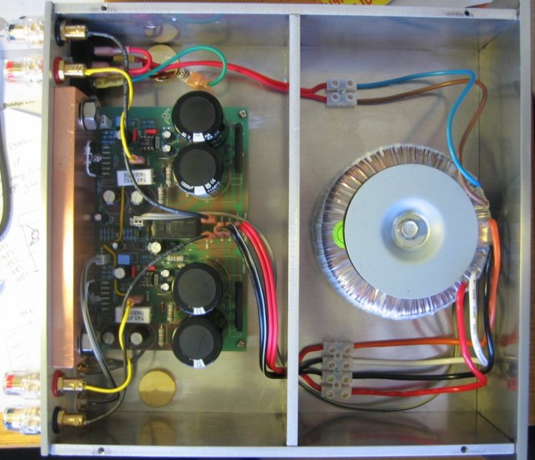

Construction finished
Well, I have finally finished it!
I'll have to search what the best method is to test it, but I think the standard practice is to test mv with shorted inputs, and if that checks low, then let her rip? 🙂
Piccy for prosterity. I've used medium hookup for the signal cables and 1.25mm enamelled cu wire for the speaker connections.
I was not able to solder any of the fastons, they are just crimped. What do people normally do?
Happy with the result, my only concerns are:
Should I split the signal wiring and twist it?
Should the signal input lengths be the same? (one channel is a lot longer than the other here)
The speaker ground wires are about twice the length of the signal wire. Will that have any effect?
Well that is a very neat layout. One concern is I don't see a fuse on the primaries. Is there one?
As for the ground leads being longer, that is nothing to worry about.
Edit: My suggestion if there is not an integrated fuse in the power receptacle is to replace the two terminal primary strip with a 3 or 4 and put a fuse inline there. You have plenty of room and it would be a simple mod.
But once again, EXCELLENT execution!... Please let us know how you like the sound.

Thanks for the feedback 🙂
Yes, the primaries are fused - the IEC socket has an integral fuseholder, and there's a 5A Slowblo about to go in. Having interested kids around means I do things like remove the fuse until everything is complete, just in case someone decides to plug it in when I'm not around...
Oh yes, I'll defintely let you know how it sounds 😀

Ok, it's running, sounding sweet!
I've been listening for a while at reasonable levels, and the back panel is warm, not hot to touch. Those resistors inside are pretty hot though 🙂
Initial impression is that it's slightly drier than the other amp, but not unpleasantly so. I'll let it burn in for a few days before I get critical... It sounds very good to my ears.
It's pretty quiet with no source until the volume gets to about 75%, then there's a bit of hiss. This is with Russ's Freebird in standard configuration, things are quite loud enough at 25-33% on the dial.
I'm getting a bit of hum directly from the tranny (not through the speakers though)
Michael

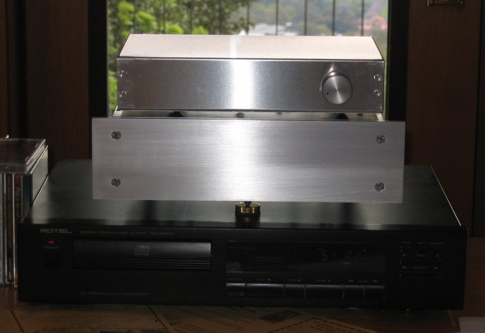

Pic of the front panels:
