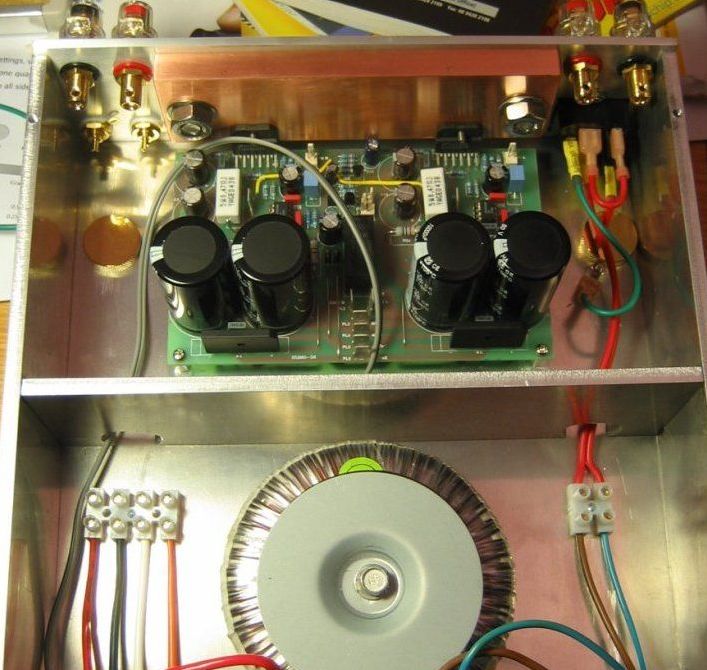

Ok, that's it from me, it's starting to come together. See pic.
Toroid cabling check question:
I have this toroid:
http://www.altronics.com.au/index.asp?area=item&id=M5525
On the My_Ref PCB, there are 4 connections:
PL3 Gnd
PL4 Gnd
PL5 24va1
PL6 24va2
The toroid secondaries are paired Red & Black, White & Orange.
I see that PL4 and PL5 (Gnd) are on the same PCB trace. Should I connect:
Red = PL5
White = PL3
Black PL4
Orange PL6
Thanks,
Michael

Michael, you are correct. Wire as you said.
That Toroid should work great.
Cheers!
Russ
