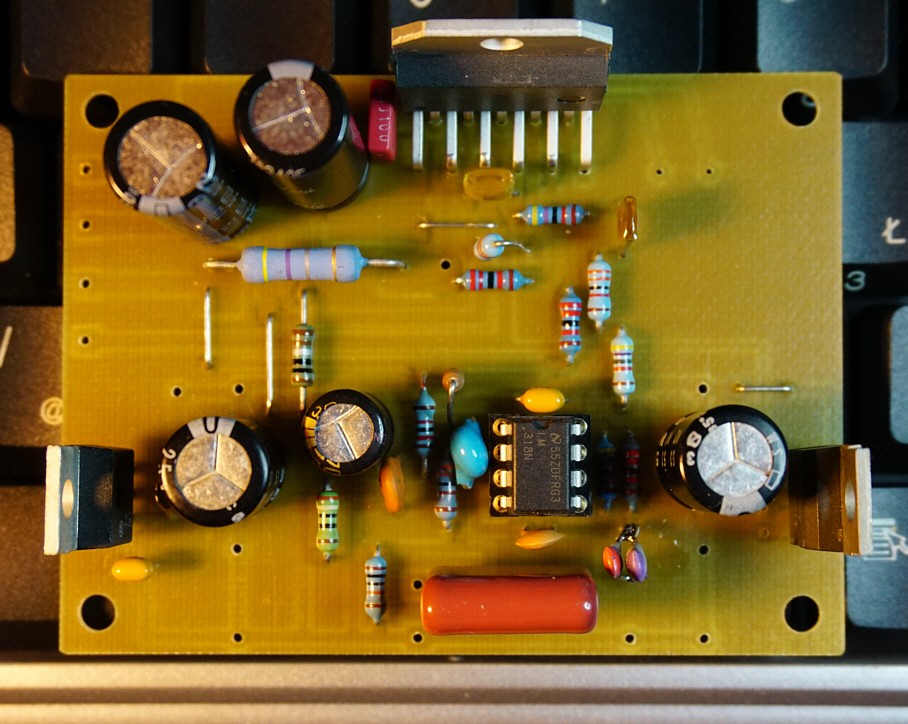

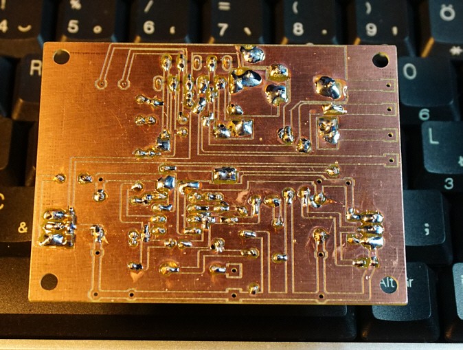

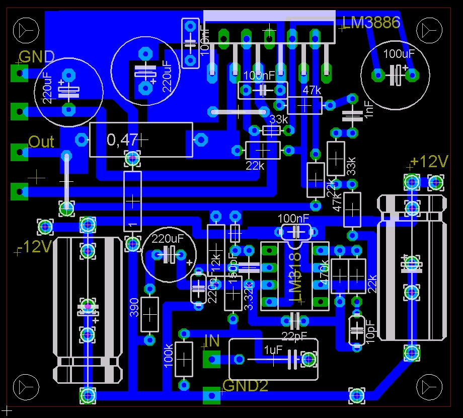

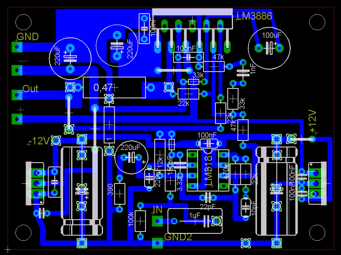

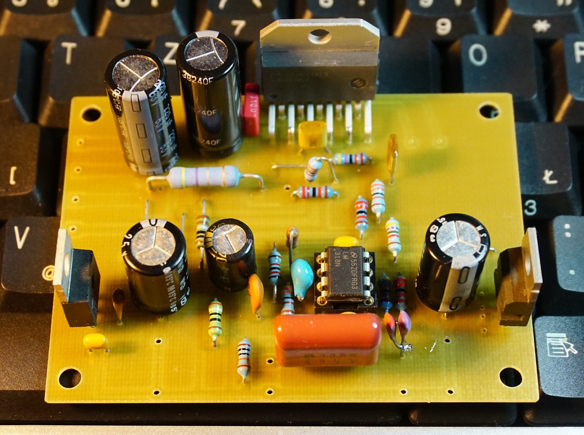

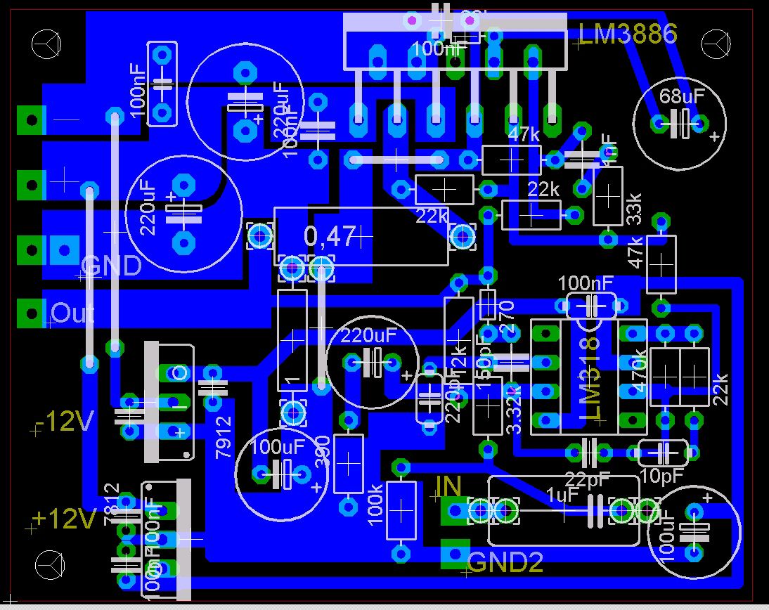

Second version
Hello,
I made a second version of the amp. A small and dense board.
Tested it, the 1W THD is -84dB. With a 2x35V supply, it delivers 45W. This is still a single sided PCB with 4 jumpers.
The left side two jumpers have to be replaced with zener's if the supply voltage is above 35V, also if you are in to audiophile capacitors, you can replace C13 with a jumper and place the larger cap in the vicinity of the input connectors.
