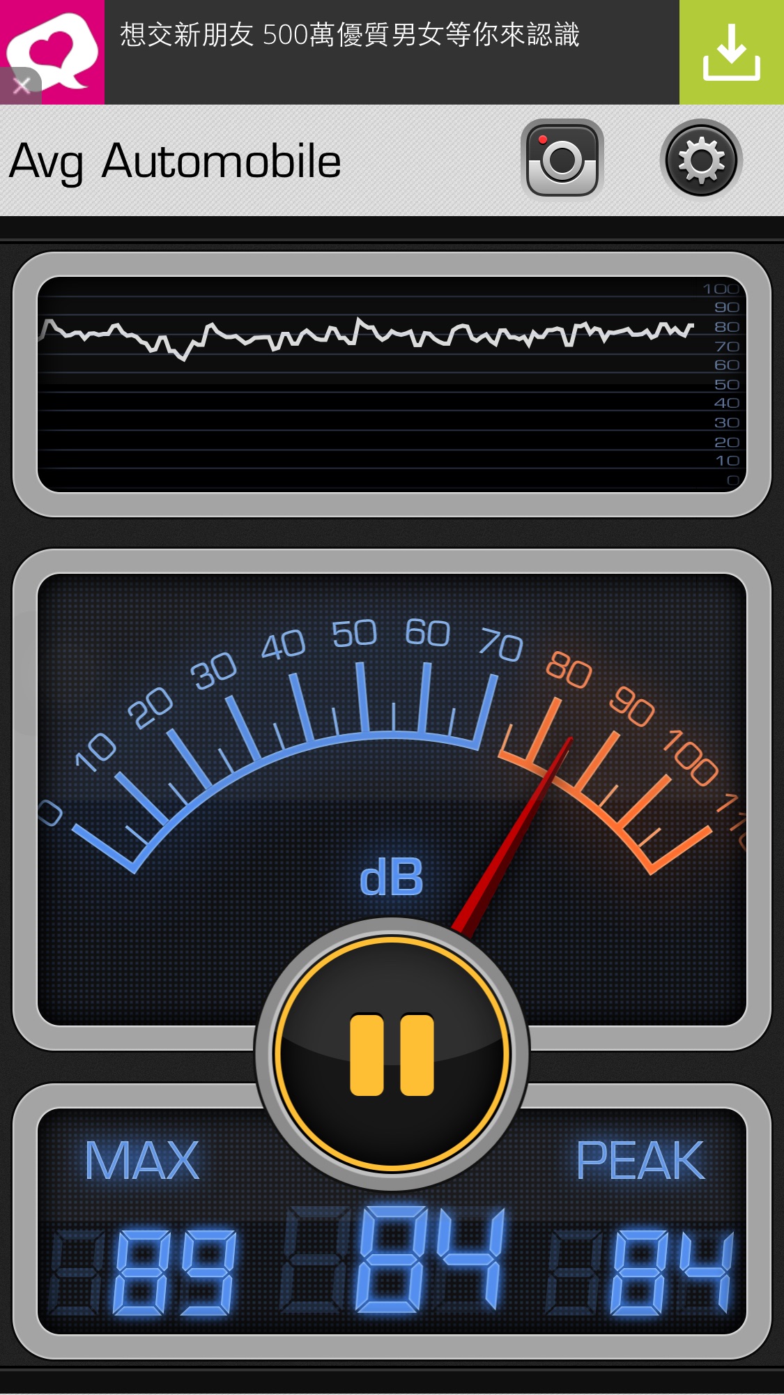

Distance also influences how much power you need. For example, the speakers in my avatar delivers this at about 3meters. Depending on music type, it can go higher. Room response is also another factor
