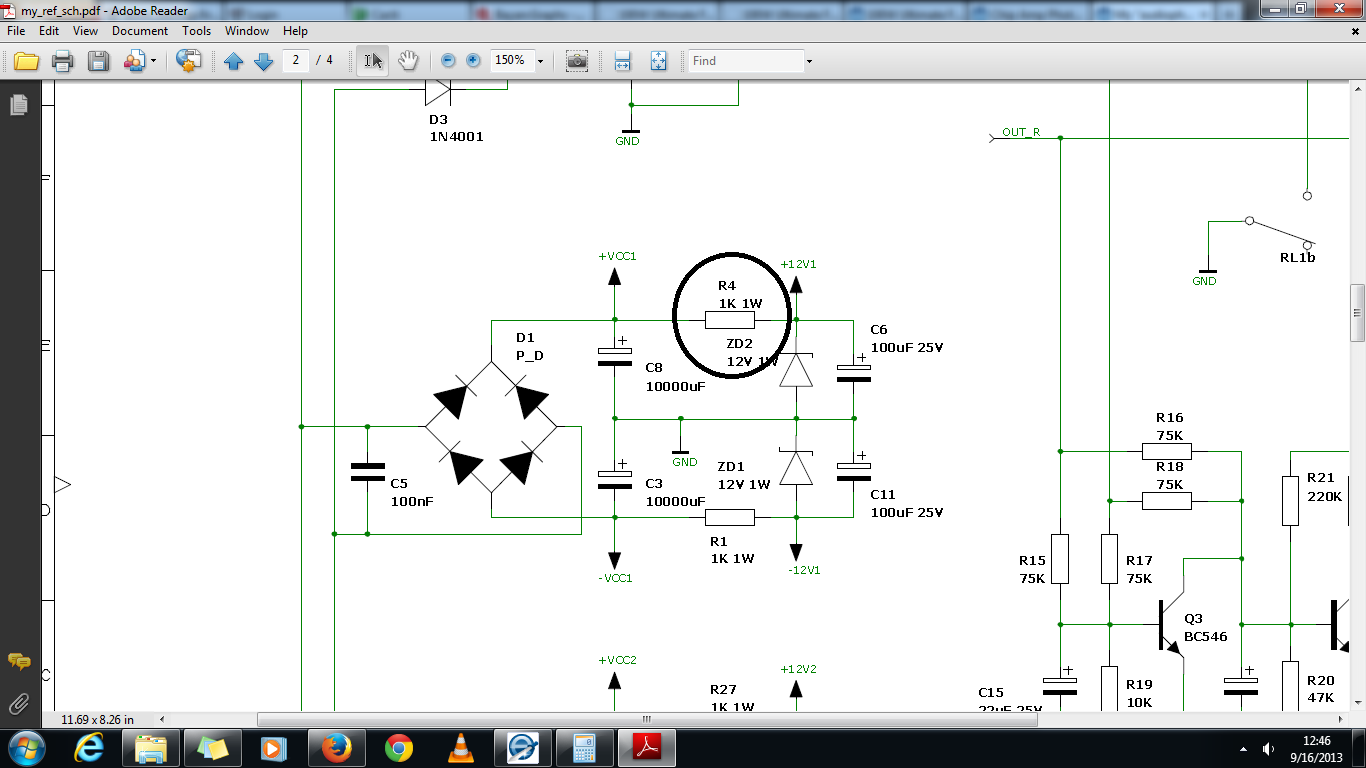

Zener in ZD2 on one board reads 12.5v. ZD1 reads 12v. LM3886 in that specific board gets hot (i have disconnected heatsinks). Led in that board flashes for a brief moment seconds after power down.
Zeners in ZD1, ZD2 on the other board read 12v. Lm3886 stays cool. Led is always off.
Been there, done that. Check R11, the 1 ohm ground lift-resistor. If it's open, replace it and check - there's a 50:50 chance that all will be fine with just this fix.
If the R11 is fine, and the relay doesn't click, check all the rail voltages, then replace the LM318. Beyond that, further troubleshooting will be required to narrow down the failed components.
R11 visually seems ok on both boards. Checked it with multimeter and i get 1.8ohms and 1.3ohms in each board respectively.
OK, R11 seems not to be the problem, but if you want to be doubly sure, just measure and select one closer to 1 ohm and replace the one that reads 1.8 ohms.
The LM3886 that's heating up may have bitten the dust, but it's best to check the MUR8xx, zeners and LM318 first before attempting to replace the chipamp. If you have to replace the chipamp, cut out all the leads and desolder each lead individually instead of trying to wiggle it out. This will sacrifice (the presumably dead) chipamp, but save the PCB pads, which is more important.
Thanks for the tips Linuxguru. I replaced the LM318's today and still nothing. I will replace the diodes next and every other ic, leaving lm3886 last.
