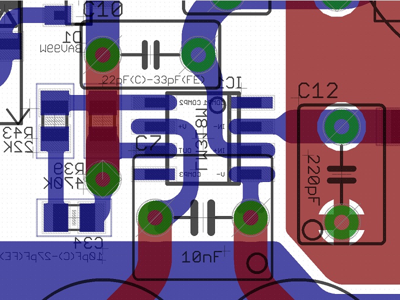

Taking the C7 traces out to a location next to the end of the LM318's case, as in the last PCB image I've seen, most-likely significantly degrades the decoupling effectiveness at higher frequencies, with possible effects on feedback effectiveness and, among other things, transient response accuracy, which could directly affect imaging.
That cap also performs HF bypass duty, to prevent HF oscillation and ringing.
For both of those purposes, the total distance from pin to pin, through the cap, needs to be absolutely as short as possible. Adding 2 mm is considered to be significant, there, for example. (And a socket would certainly muddy the waters.)
Is there some reason that optional more-direct traces cannot also be provided, on the bottom of the board? A layout that was both through-hole and surface-mount-compatible, for that optional cap location, would be ideal (check footprints for 470 nF X7R surface-mount types?). (Through-hole might be "interesting", but might be possible if installed before the LM318. Or, a through-hole part could be surface-mounted.)
In that case, the existing traces and mounting location could be kept as is, and could be used for an optional physically-larger parallel decoupling cap, which could provide benefits in the medium and/or lower frequency ranges, and further opportunities for optimizing the amplifier's response.
And, separate from all of the above, have you thought any more about AndrewT's suggestion of decoupling each pin to ground, separately?

The LM318 section uses rail-to-ground decoupling with electrolytics C6 and C11, and rail-to-rail HF bypassing with film cap C7, respectively. Early on, it was empirically observed that a rail-to-ground HF bypass of the electrolytics with small film caps actually made the audible sonics worse. I'm not sure why this is the case.
Subsequently, Dario empricially found and others independently confirmed that C7 was critical to audible sonics. A smaller value in the range of 5nF to 22nF, and the highest quality that would physically fit in the space provided, empirically seemed to improve the sonics greatly. The best results have been found with film/foil types like FKP, FKS, FKC, ER0 KP1837, RIFA PFE225 and similar.
There have been two approaches to mitigating the the trace inductance of C7, apart from keeping the leads short.
1. Use a ground-plane on one side and treat the traces to C7 as microstrip transmission lines.
2. Use multiple thin traces in parallel to reduce the combined L, which also benefits from opposing magnetic-field cancellation between the thin traces.
(Both approaches above can also be combined, which I've tried in the V1.4 PCB for the MyRef).
However, not much can be done about the lead inductance within the package of C7. Stacked film-foil has an advantage here compared to cylindrical wound types.
In SMD, the choices are limited to C0G ceramic and Panasonic ECHU (which is stacked film-foil polyphenylene sulphide) for C7. However, since C7 is rail-to-rail, the more common 16V-rated ECHU is inadequate and 50V parts are required here. The good news is that 22nF/50V is available in 1210 size, and this may also work well at C21 (optional HF bypass for C9).
No problems about it... ;)
In the FE the path is the shortest possible with TH parts:

An SMD part would not make a great difference on traces lenght...
Regarding sockets I do agree they can make a difference in the effectiveness of the decoupling/bypassing (choose your favourite name) but I can't see a more effective way to compare among different parts... suggestions are always welcome ;)
I do agree but the Twisted Pear monoblock design it's not mine...
In fact, as you have already seen in the previous picture, I've designed a new board also for this reason.
Using an SMD LM318 a TH C7 can be arranged not much differently than an SMD one...
Hi Siva,
this is not exact, while the FE makes large use of quasi-microstrips it's not the case of C7.
