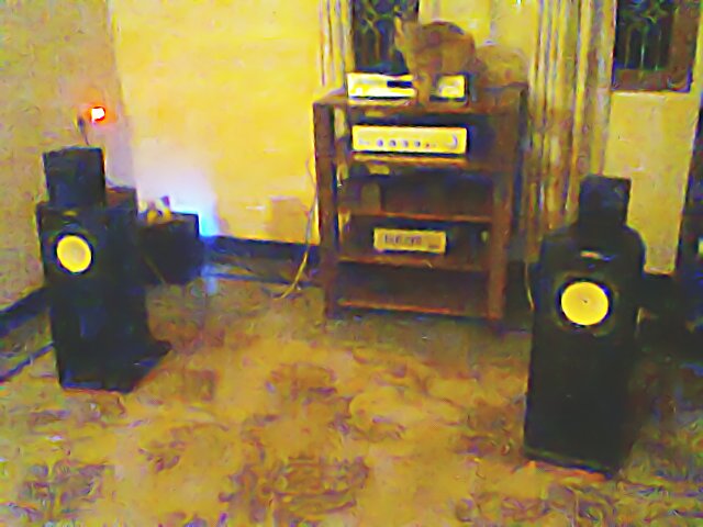

1. Fostex FE206 in a custom bass-reflex cabinet.
2. Jamo Compact 60 2-way bookshelves (3.5" mid-bass driver and ~1.5" tweeter crossed with a 4.7uH 1st-order capacitive crossover, for evaluation of mids and highs only).
Both are shown in the grainy pic below (taken with an entry-level camera-phone, excuse...) at a local DIYer/audiophile's place. There's an additional powered sub-woofer that's used when listening for fun (not evaluating) through the Jamos. There's a pair of 47 Labs Shigaraki DACs on the 3rd shelf (barely visible) which were used in some of the evaluations.
(My audiophile friend's ginger tabby prefers the warmth of the Marantz 6002 CD player. I can't disagree...)
