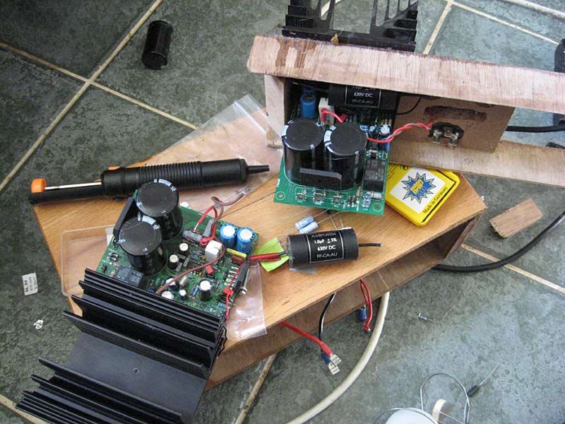

I've build up 2 mono blocks of myrevC and now I have a problem:
When powered up, there is Music playing already, when relais clicks after a few seconds, music signal decreases to almost silence. 😕
Same effect vice versa when Amp turned off...
-didnt change any parts
-soldered anything 'fine'
-it's on both channels
-used 2 transformers each one 24v 500VA, wired to 24v 0V 24V (also measured)
Can anyone give me a hint where to look please?

You can hear music coming through before powering up and after powering down?
A closer pic of the XLR connectors might help to verify they are wired correctly. Has anything else in your signal chain changed?
Your trafos look like they are wired properly. As a confirmation test, if you measure AC between AC1 and AC2 on each board, you should get ~48V.
Also, you might want to shorted your power wires and route them away (as much as possible) from all of your signal leads. You may pick up quite a bit of interference from those EI trafos in the middle of the case.
Have you tested each channel outside of the case, one at a time? This might help point to the problem. Also, verify that your signal + and GND are connected to the correct pins.
