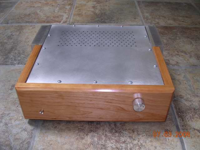

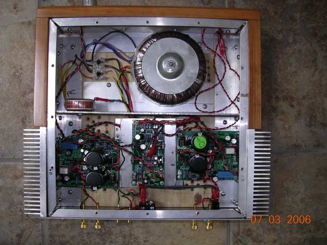

Thats a nice amp man. Very cool having everything integrated in one nice chasis.
I like it! 😀
Cheers!
Russ
I like it! 😀
Cheers!
Russ
thanks Russ,
In fact I think the painting of this chassis took up more time than the electronics.The graphite metallic paint would never really dry hard and would mark easily even after a week.Redid it three times!

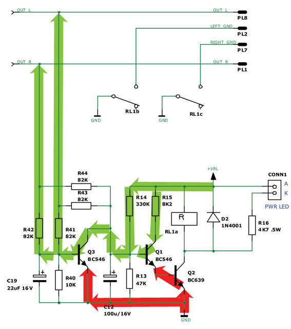

After playing around with the amp too much i accidentally connected one of the ac to the power ground.
I replaced both op-amps but i am getting -36 V at amp output -13v at both the inputs of the lm318 and + 11.7 at the output of the lm318.
All power supply voltages are ok and everything else seem to measure ok.
Any ideas?
Thanks.
Any ideas?
Thanks.
Check the feedback loop
You may have opened up the feedback loop. Check voltage at C9. Should be plenty if threre is -36 volts on output.
George
George
Probably Q3 is dead, maybe all three of the to-92 transistors. They have a leg sitting on GND, and rail voltage, and are tied to the 3886 outputs (DC monitoring). When you put AC on the GND, it prolly killed one or more of these, and they are now conducting rail direct to output. Just a guess.

BrianDonegan said:Probably Q3 is dead, maybe all three of the to-92 transistors. They have a leg sitting on GND, and rail voltage, and are tied to the 3886 outputs (DC monitoring). When you put AC on the GND, it prolly killed one or more of these, and they are now conducting rail direct to output. Just a guess.
Thanks Russ,
I thought of something like that too.I took out q1 q2 and they measure well hfe etc.Q3 seems to be measuring ok on the board at least with the mm diode checker- so not shorted of couse.The voltages i am getting are with q1q2 removed.
So I think it is something else.
George mentioned the feedback loop .I have measured the cap there and it is ok so i will check the voltage while on.It would be strange though if a feedback resistor opened or even a track on the board don't you think?However looking at the schematic since i measured -13v at the -input(3) of the lm 318 then there should be -13v on the positive side of c9 as well since they are connected.So I am still confused...
