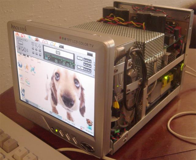

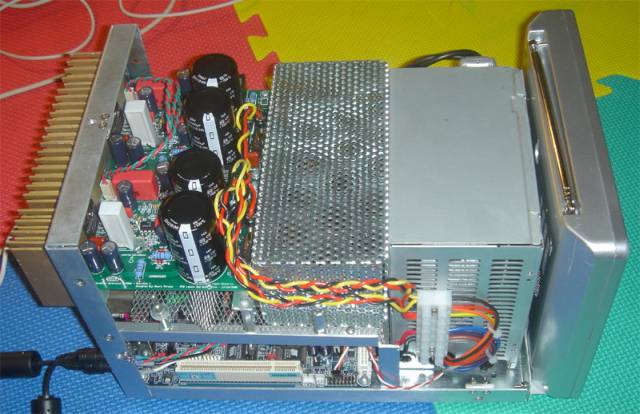

KOHTOPA said:Solid state MyRev in my solid state media PC 🙂
Hey man that is very very cool. 🙂
I looks like there is a trafo in the metal box just behind the LCD. It is well hidden.
Very celever.
How does it work? Sound OK? No issues we all those digital signals and such?
Thanks for sharing!
Cheers!
Russ

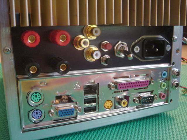

Thank you guys!
> Do you use a switched power supply?
> If yes, what voltage do you use?
Yes I do, but only for computer and monitor. Both of them are 12V.
See two connectors on the right side (new attachment). Analog
part has a dedicated power. First I used just one 12V brick for
computer and monitor but power was so noisy that I "saw" 60Hz
on the screen 🙂 Even now when I use separate power supply (with
separate ground) for monitor it's noisy because power wires go
through the whole box. I should use shielded twisted pair.
Hopefully that should help.
> It is well hidden.
To be honest, I borrowed that idea here:
http://users.podolsk.ru/boga/DAC.html
The box becomes a little bit warm. Probably I have to drill some holes on the top 🙂
> signals and such?
This is still work-in-progress. Right now I can get audio output
only from the computer's LineOut, which is not a good source just
because it has a common ground with computer and it has some
kind of internal amplification already. That's why it's hard to
estimate RevC - garbage in-garbage out 🙂
Right now I'm trying to design a unit which will be a combination
of USB DAC and preamp for volume control (remote). Preamp will
be almost the same as your Kookaburra 🙂 just without output
buffer because it will go directly to RevC. That empty perforated
cage in the middle is intended for that device.
Noise is the main problem in this design. That's why I've
isolate computer and audio grounds. They don't have common
power supplies and audio will be supplied through USB which is
digital differential signal and that's why noise should not come
through this way. I also won't use USB power from computer.
Perforated screens and shielded cables should help to prevent
EM crosstalk. We will see.
> It is well hidden.
> signals and such?
