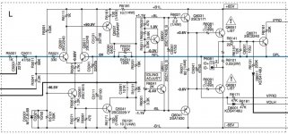

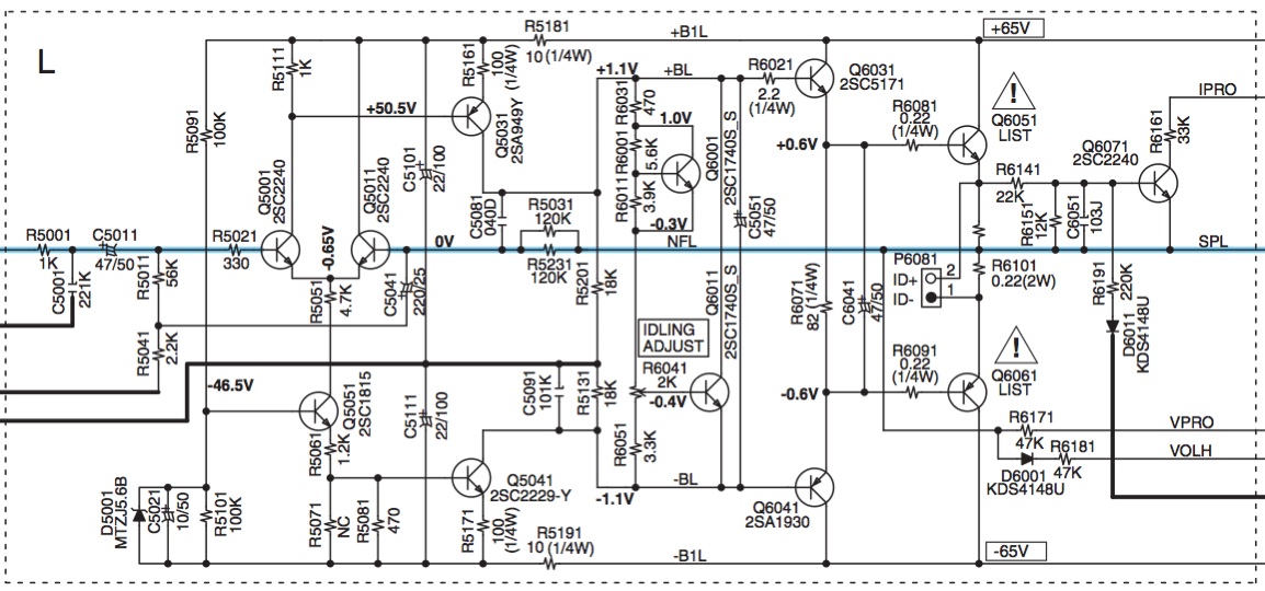

I plugged them into my Onkyo receiver and they don't distort even on extremely high SPL. The amp in it only has 1 output pair per channel and runs off 65V+/- would that exceed the SOA of the output transistors? Why can't I run the HRII amp off 50V+/- this amp runs the amp off 65!

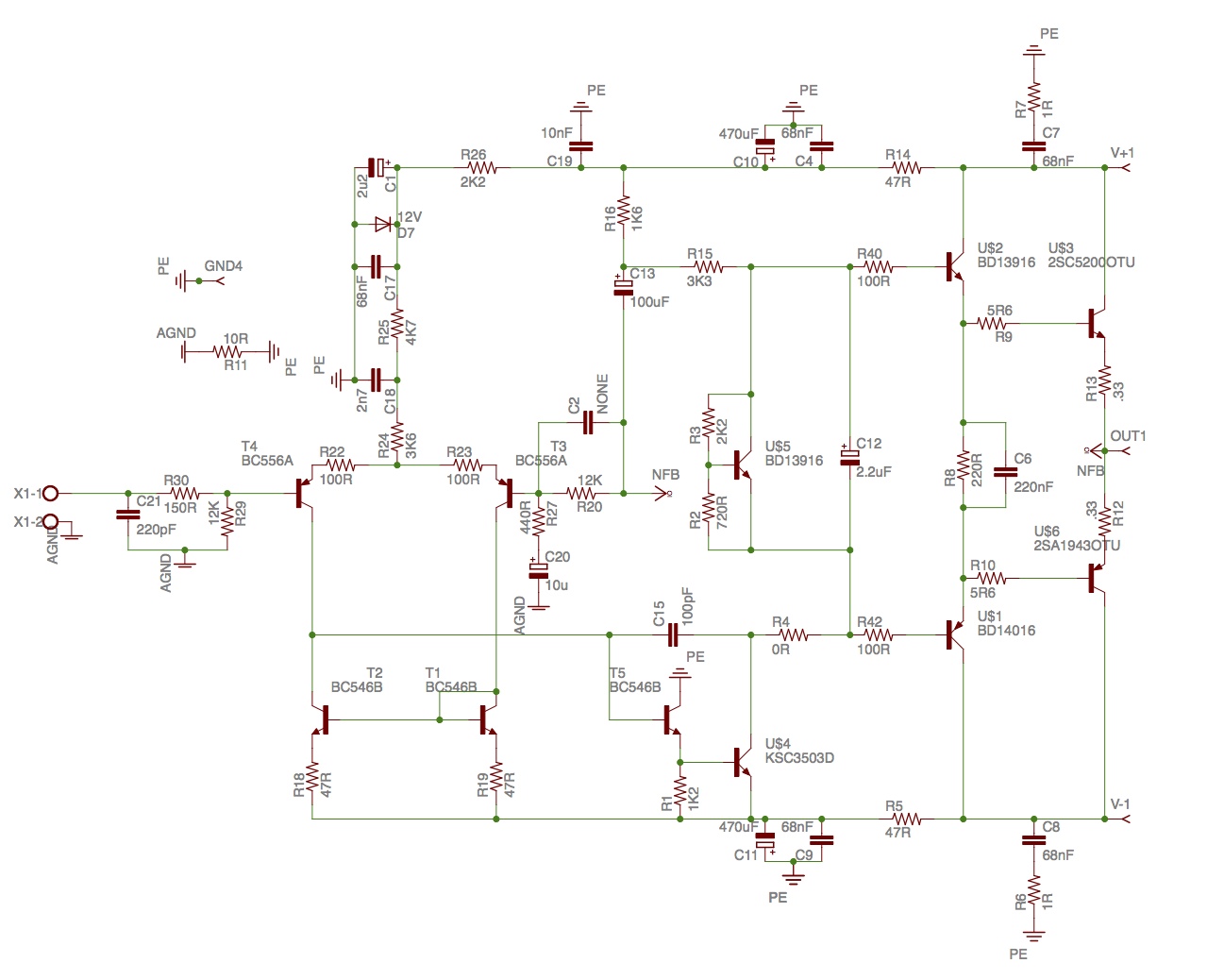

Benproiii, try this remove c7/c8 r7/r6/ and c19..replace c10/c11 with 100uf and c4/9 with 100nf. c20 up it to 47uf.
add a 10uf bp at the input of the amp...
@benproii:

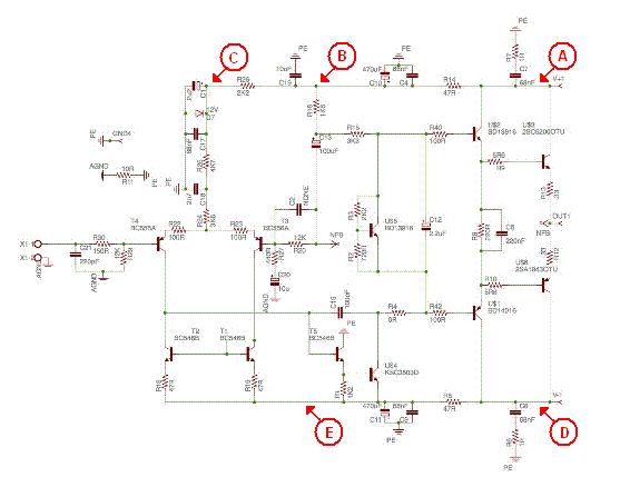

Nothing obvious, although it is different to the HRII schematic I found on Greg's website (so FWIW, my earlier comments about zeners don't apply here).
I suppose the first thing to check is all the supply rail voltages, as shown below.
@amptech:
Why? Changing C20 may improve the bass and adding an input cap will reduce the chance of DC offset, but none of those changes will fix the actual problem.
@amptech:
