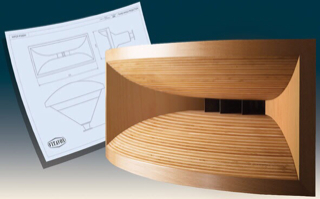

Started drawing up Yuischi 290 bi radial.
Have Altec 805b multicell. They don't soundstage, and sound metallic.
Considering constant directivity wood horn?

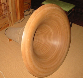

Have a wood round 300hz tractrix half built. Just a bunch of cut out rings, but missing a lathe to finish.

Finish the tractrix they are much much better sounding
than multicells. The multicell may be better in the 1k under due to the size other wise you can sell the 805's for an absurd price and be happy. I think a lot of people like the multicell for it's appearance and nostalgia thinking they will get hifi but not even close.

Do you have a picture of your tractrix?

#1. Are there better more modern designs like constant directivity horns that are better than a biradial?
#2. I've read that a true tractrix reduces horn coloration, is this true of only round tratrix?
#3. Which one would you build?

The 300 tractrix will give you pure tone and sweet sound. In your small room combined with the altec it will be hard to find better sound. You should crossover between 600-1200 Hz and probably can add a tweeter around 4-5K. I have 805, 1005 and 203 altec cellular horns and in a small room they do not sound like "music" they sound like multicell horns listened to too close - above around 1/2k you get a sensation of the sound coming from multiple sources along with honk and mangled sound. The tractrix does not do this at all.
