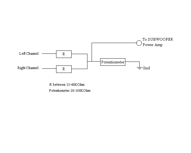

You can do it without active components as well (opamps, transistors, diodes, etc). This approach will probably not sound as good because of lower impedances on both input and output, which will (might) strain your cd-player and power amp. But since it is soo easy to try and virtually free, go ahead and do it. Just remeber to turn the potentiometer (or rotary switch if you prefer) to its lowest position (least resistance). This will make sure the subwoofer amp and/or sub isn't blown to bits. Gain will always be lower than one with the passive solution. And yes, the triangular thing is an op-amp (just about any will do).

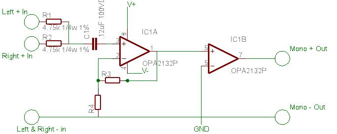

Sorry, I don't quite understand what you are saying. Do you have a pre-amp with sub-out or don't you? If you don't you will need to extract the low frequency information from both left and right channels. A way to accomplish this would be like the picture I attached in post #18 (there are several other ways, just do a search on google.com). And in that case your OPA2132s are PERFECT for the job. You will only need to use 2 of your OPA2123s since they are, as you stated, a dual opamp. The part after the Active Eq (in the picture), goes to your stereo amp (for the sub), just make two connections from the Active Eq to the left and right input of the stereo amp driving your subs. Now each JBL will have a separate amplifier to drive it. I can't make it any clearer than this. Maybe someone else can?

So if you use the rear out as a sub out just use the Summing block (Stereo -> mono) as can be seen in the picture in post#18. This means that you only need to use one op-amp of a OPA2132 to accomplish this. Hope you know how to hook up a op-amp (you need +-rail voltage, + decoupling at the op-amp, see datasheet for 2132: http://focus.ti.com/lit/ds/symlink/opa2132.pdf). Make sure you get the gain you want. Look in the picture in post#18 and you will see how this is acheived for an opamp with positive feedback.
So just feed the output from the Summing block to the left and right channel in to Blaupunkt PA2150 and use a channel for each JBL. The out of phase connection is acheived as Ferdi in post #2 says, by reversing the polarity from the output of the Blaupunkt PA2150 to the JBL (connect the red output of one channel to the black input of the JBL and visa versa and you have it). Do this on the one you want phase shifted! That should do it.

You should remove IC1B.

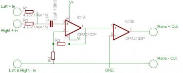

Regarding the attachment:

Nice to know that I get it right. Then I need to work on the summing block now. I think I will use IC 1b as a voltage follower. Anyway let's make the off topic subject to other forum.😉
