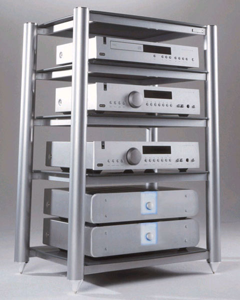

The Aleph 60 uses 200 watts of power, so use 400 va mininum.
Have you previously built class A or an Aleph.
Unless I mis understand you, are you planning to store you components as per the image?
The narrow shelving would make natural convection relatively inefficient.
I say this gently, but without knowing more about your situation I think some practical application is in order so you can appreciate the nature of the class A amplifier.
Pass designed his amps free standing because it would be largely impractical to stack them with other equipment due to heat and weight.
Unless you have major waaf issue (the wife problems) with decor it may be easier to implement another approach without far of failure
regards
ian
No no no, I was talking about voltage rating...in VAC.
Actually, the amps will be side by side on the top of a furniture. I've only used this picture because I love the rack and it had two amplifiers that could be modified.
However, these amps won't lie there forever...what would be the mininal clearance above each amp (one amp per shelf)
regards,
Gabriel
P.s: That rack is 600$US so it's highly impossible that my two aleph will end up there.😛
And the man behind the curtain said:
Good ventilation is vital to the proper operation of the amplifier ..... You should leave at least six inches clearance on the sides and top. The amplifier should not be placed in a closed cabinet which does not have forced air ventilation.
'Nuff said !
