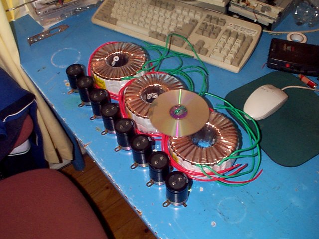

do you guys think 32,600uF per rail will be enough for my amplifier?? or should I buy some more capacitors?
heres what I have so far... except there will be 2 rows of capacitors, one on either side of the transformers... :xeye:
yes, thats a CD sitting ontop.. 😛

Fuses
Why is it wrong ? By switch up high inrush current blow this fuse ( if have correct size ). If is oversized, is it for nothing, because by failure of amp all charge of capacitor " flow " without any limitation. Correct is fuse on primarily side of transformer and second fuse before voltage rail ( behind main capacitor ).
I doubt that in the case there is a large DC voltage on the output, fuses inserted in the rails of the amp will blow quick enough to prevent the demise of the speaker, or at least damage. However some people do it anyway, maybe more for psychological peace of mind. I do not like to put fuses in rails or speaker lines (this is also common in some amp designs and serves exactly the same purpose - to prevent the speaker blowing up on high amounts of DC at the output), so I avoid it completely.
In any case, putting a fuse in will definitely limit the kind of currents that pass through the output stages, in case of low impedance speakers the fuse can go off in the middle of the session, even if all the other components are capable of correctly handling the transients. A well-designed amp should have enough room to handle transients, and quite a lot more.
Catastrophic failure, say like failure of the output transistor will probably ensure the speaker dies before a fuse can blow. A better way to correct would be to use active protection. Increases complexity, but if you want protection it's better to be well-protected.
As for the primary, the fuse should always be of the correct rating, but should be a slow-blow type to prevent fusing at switch-on, particularly for toroids. Upupa is right in saying that fusing the secondary AC is not advised, because the caps on the supply can pull some serious current, upto tens of amperes. Putting a 15-amp fuse on a gainclone will neither protect the gainclone, nor its speakers, nor the amp.
