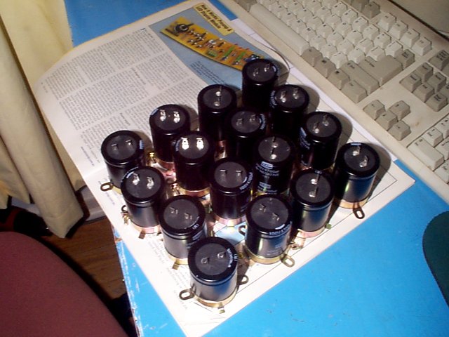

Just a progress report and a chance to put my ideas down somewhere... plus... I am tired.. depressed... bored... lonely... and I figure I should do something...
anyhow... I have the filter capacitors... sixteen 4700uF 100 volt chasis mount, even though I am only using +-38 volt rails... or so... My transformers have been ordered and should be here in a week... I am getting three 250VA transformers and connecting them in series... should give me enough power to run the amp to its fullest into 8 ohms... and give a fair whack of power into 4 ohms.. 🙂 but now.. I gotta find heatsinks... I have looked.. and it seems I'm gunna be slogged like $130 for heatsinks...
but so far, all I have spent on all the other parts... (transformers, capacitors, amplifier ICs 😉 ) is $75... but now.. heatsinks... $130!?!?!? common!!!..... lol I mean.. its still a cheap amp... lol anyone made some PCBs for this chip yet? 🙄
I think the LM4780 could be the perfect power-opamp. Two channel 60 Watt in one package.. or a 120W bridge amp .. I received them this morning. Since the have a relative large number of pins and small too, a PCB would be perfect. maybe someone is interested too. 2xLM4780 and a PCB = simpest 240 Watt stereo ever! 😀
