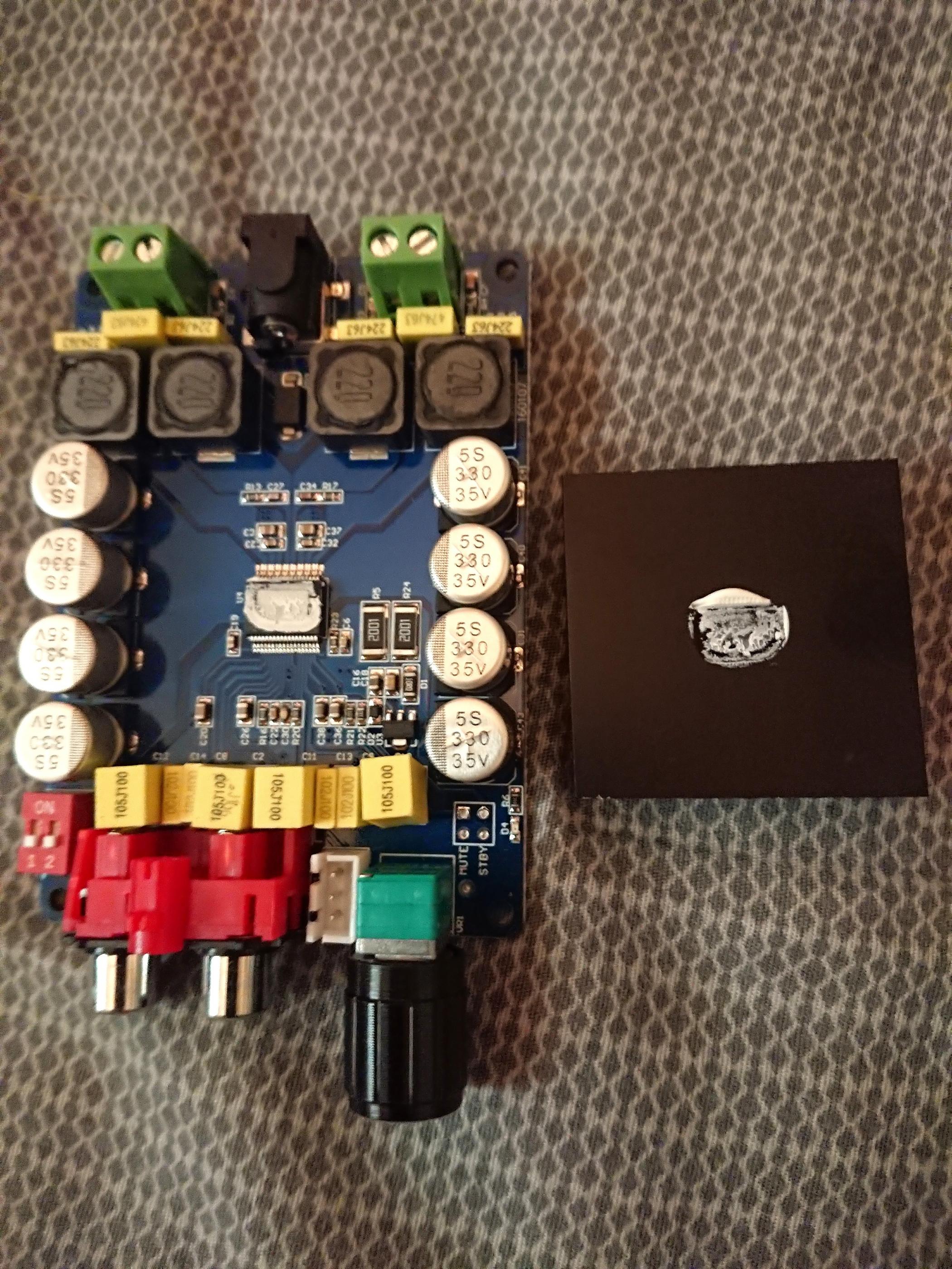

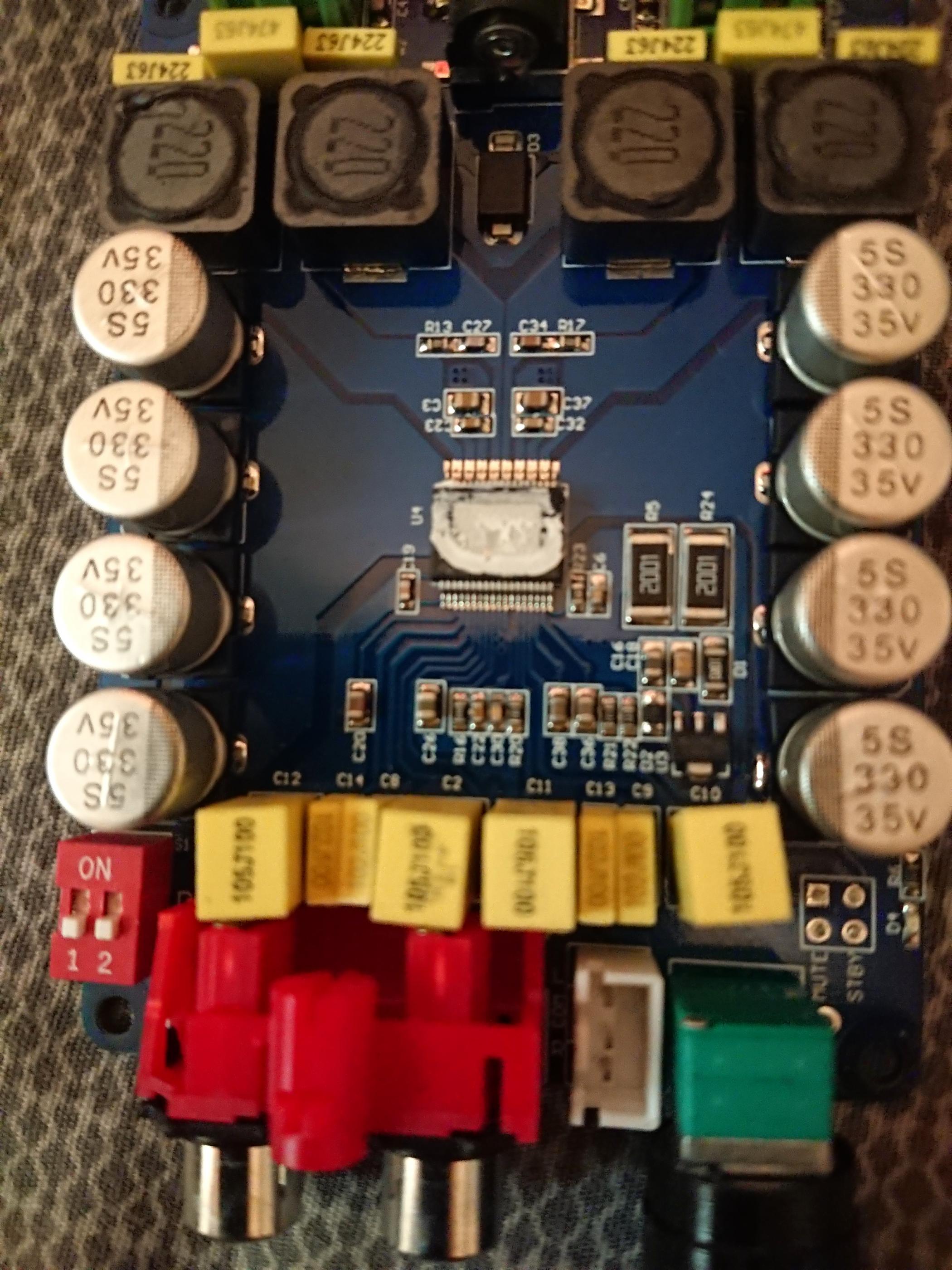

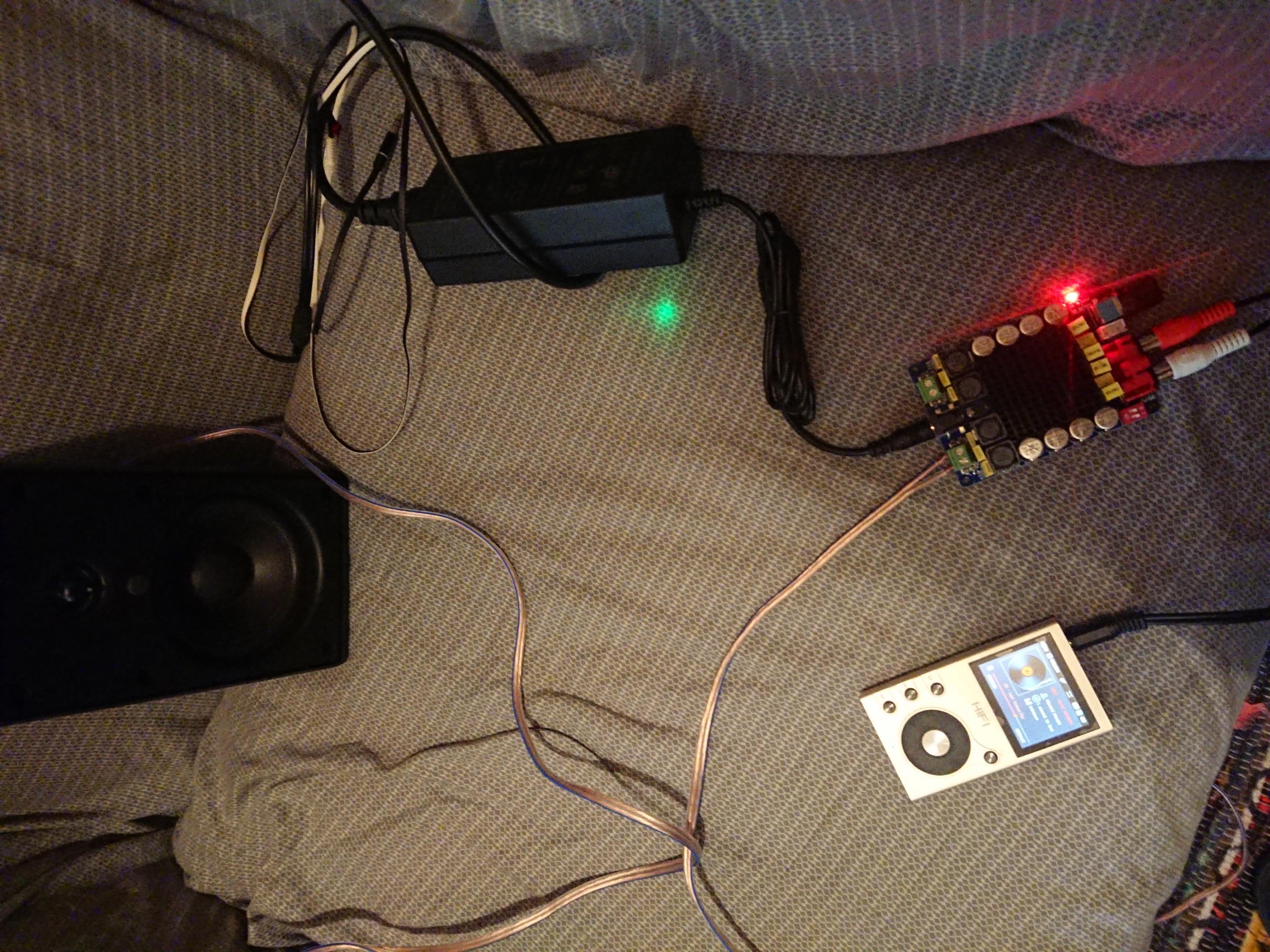

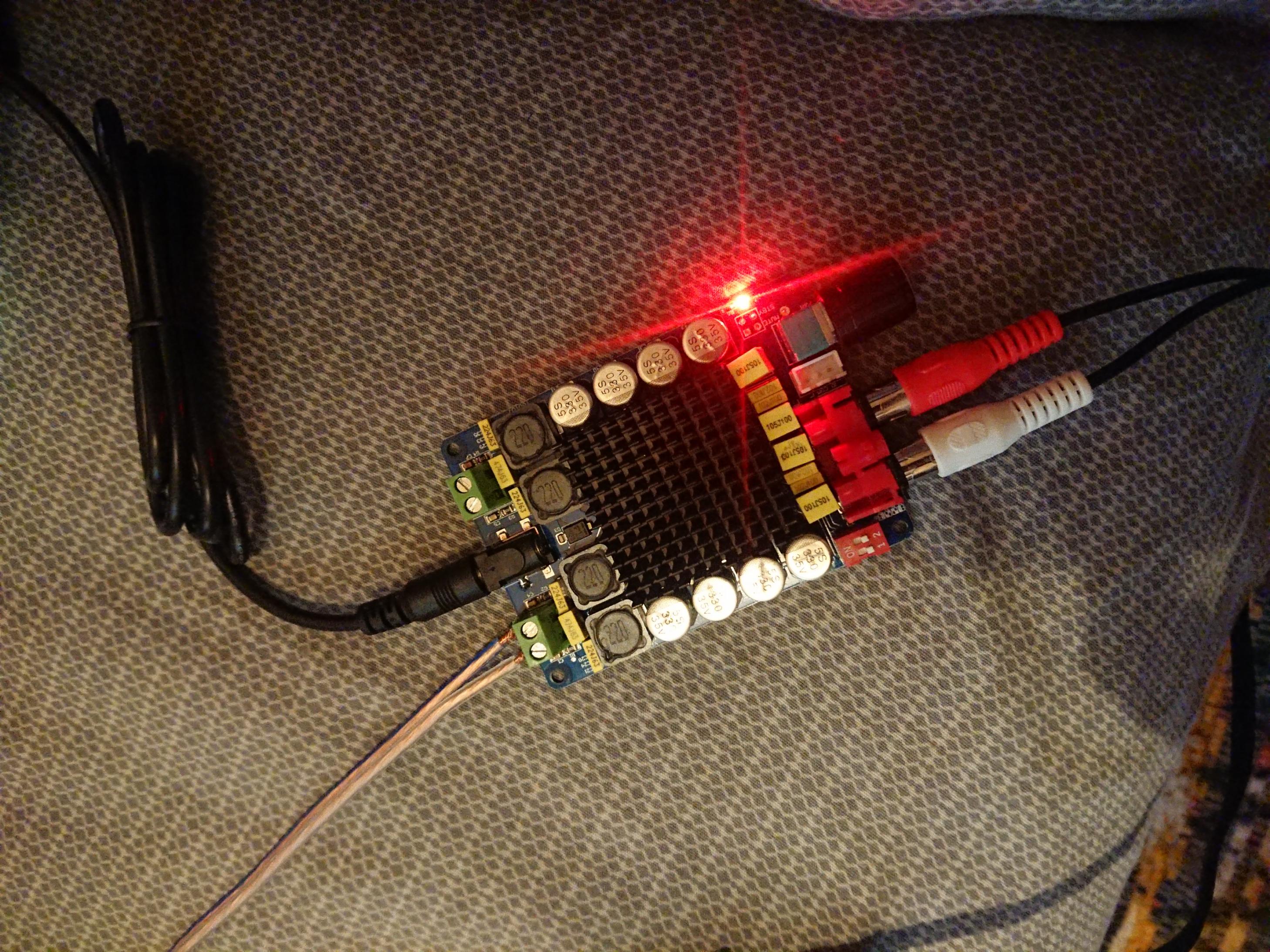

Bump. I see the 7498 chinese thread is closed, I thought I'd ask a question here. I bought this amp awhile ago and never hooked it up. I played it and it worked at first and then I hooked it up again and no sound. Anyone know if it's fixable? The light still works, but no sound. Been over a year so can't send back. Here are some pics. Thanks for the help.
We just have the same problem with what is believed to be a TDA7498E amplifier. I read somewhere that people have found TDA7498 chips in boards that should be TDA7498E.
What is your supply voltage?
It might be poor quality cooling-paste that migrates in-between the legs of the chip and causes interference. A problem with the TDA7498E chip (probably also TDA7498 chip) is that it is extremely small in size.
Hi FF! Thanks for the reply. I'm using a 24 volt. I also have a 32 volt. Here is a closeup of it. I detached the heatsink so you can see. I don't own any patse and where to get it. I've seen some PC videos where they repast it. I sent the seller who is away till next week to see if he can help. So did you fix yours?
