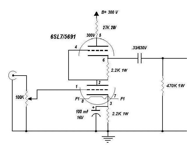

Brett,
Here are some questions regarding your original responses in this thread.
What is your thinking on this? Is there enough of a benefit to offset the fact that you need a bigger coupling (and less good sounding) cap?
I'm going to wind 2 bifilar 2.5VCT secondaries on to a small toroid from which I've stripped the secondaries. Any suggestions on where I might find material suitable for an electrostatic shield? I've only found adhesive backed copper foil at hobby shops. I'm worried the adhesive might catch fire. The good 3M stuff is impossible to find at retail here and too pricey anyway.
Brett said:- grid leak is a bit high in value. I'd try 1/2 to 1/4 of this and adjust C1 up accordingly. An IT or a grid choke would be <i>much</i> better.
- Mains trans should have an electrostatic sheild (EI core), or be of dual bobbin constuction. A seperate ES sheilded filament trans would be nice.

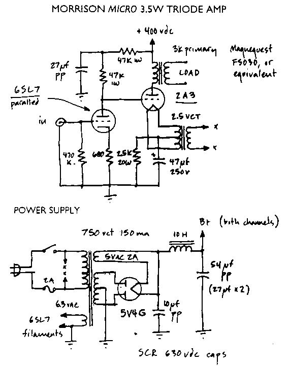

Jef et al
2A3 grid leak:
The RCA data says: For cathode bias, no more that 0.5M ohm.
So I would be happy with that on an RCA valve.
I wonder whether the other brands are as stable?
If it were mine, I might chose the next value down, for safety.
Coupling cap:
Could be a magnitude smaller at least. Having an excessively high value can make for unpleasant artifacts at overload.
ES shields on torroids:
I believe some ES shields are just a thick winding (or a number of), with one end only earthed.
Perhaps you should have left the original secondary on.😉

Toroids and E/S screens
Tricky. It's as well to remember that transformer manufacturers consider an E/S screen to be a safety feature that prevents arcing from primary to secondary, rather than an RF screen. Thus, as John suggests, they will quite cheerfully wind a layer of wire, connect to one end, and call that an E/S screen. As far as you or I are concerned, their screen has holes, and is connected via an inductor.
I don't see a fire risk with copper tape from a hobby shop. After all, you weren't intending to let the transformer get significantly hot were you?
A problem I do foresee is the winding of tape becoming a shorted turn. You might want to use kitchen foil to cover one side of the toroid and the circumference, then run a strip of insulating tape all the way round the circumference of the toroid, then use foil to cover the other side. Solder that works on aluminium can be readily bought, but it contaminates the tip of your iron, so keep that tip for aluminium jobs.

James, I'm having trouble finding reference to slew rate other than being device dependant. In other words, active devices (opamps, etc) with a quoted V/mS. I've never seen that value given in data sheets for any tubes. Am I looking in the wrong place?
I would assume that the device's slew rate would be the starting point for any further calculations.😕

Thanks Frank, but since I've already defined the term twice, and posted the same formula you just did, I obviously don't need an explanation.
Let me put it a different way: where do I find the calculated slew rates for various tubes? Because isn't this critical to the formula I=C*Sr?

Hmmm.. well, I actually have seen specific transistors with quoted slew rates, and it was not mentioned in the context of a circuit.
Anyway, just playing around with some numbers I seem to get wildly different values than you did.
Taking my 71-A amp:
at 20kHz, with an input swing of 80V pk-pk, I get a required slew rate of 10.05V/mS
So, using I=C*Sr, with an input capacitance of approximately 8pF shall we say, I get a current requirement of .00008mA
