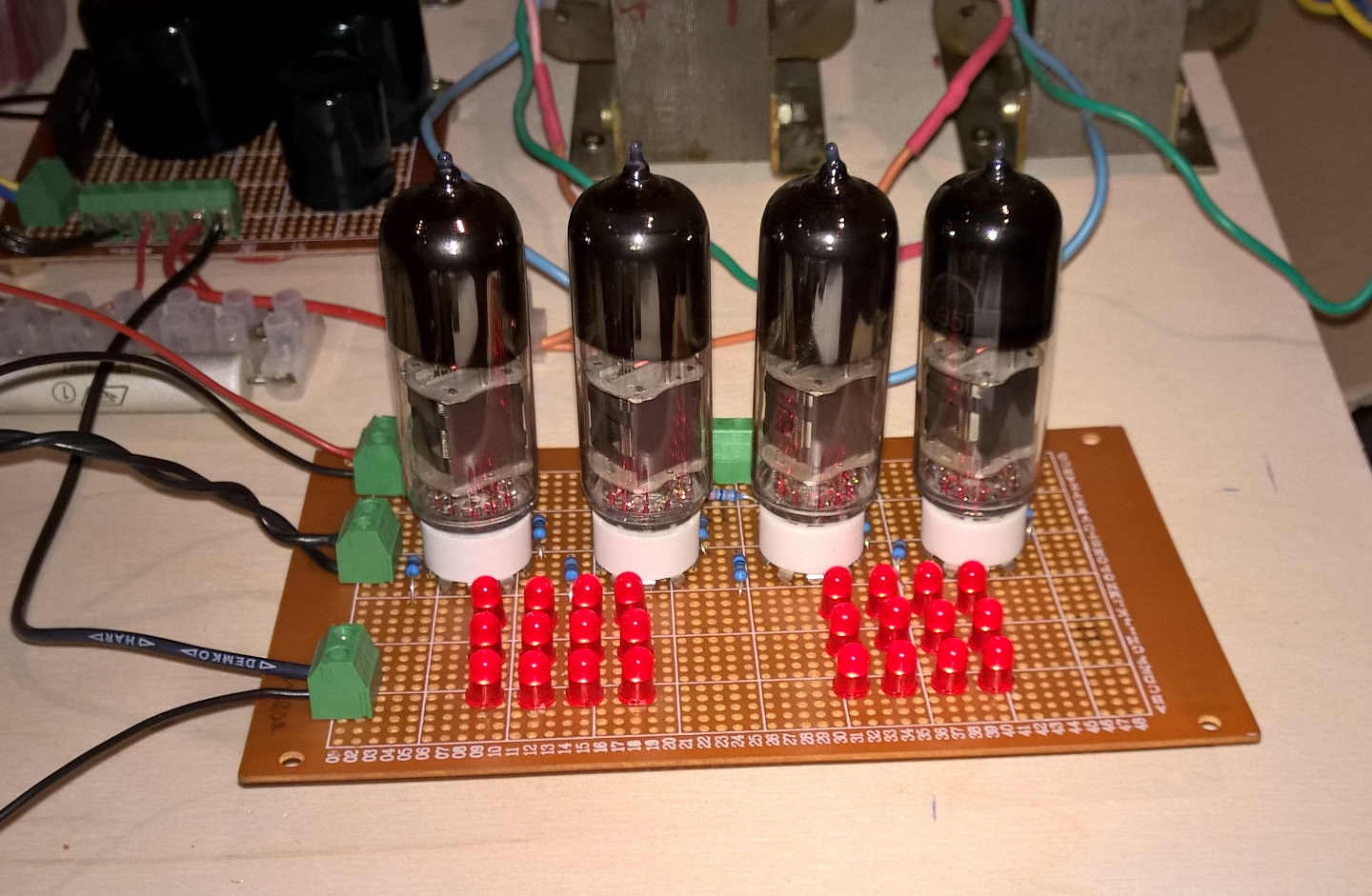

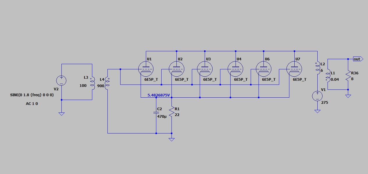

and this is my latest version:
9W (like 300B) of very pure audio.

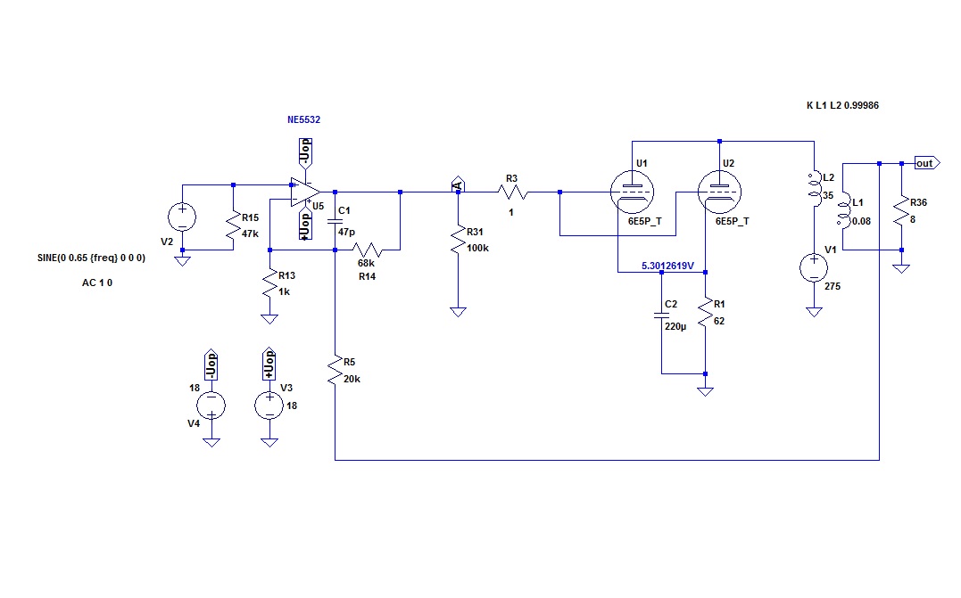

and schematic:
Wow Thank you very much for sharing. Look simple and very nice. However for me 6 watts A2 is enough. I prefer your 6 watts version.
Anyway the 9 watts version is superb. Thumbs up!!
6 watts A2 version use 3.5K OPT but 9 watts version us 600R OPT, Why OPT need to be change so much value?
The first inter-stage transformer is 100 : 900 (1 : 9) What is the value of Henry and DC impedance? Thank you.

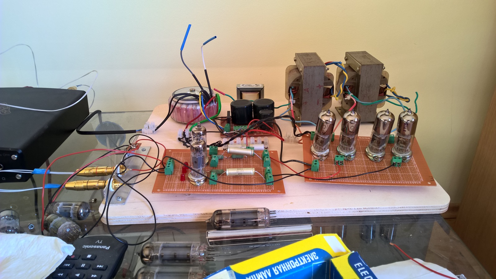

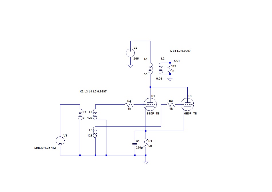

and schematic:

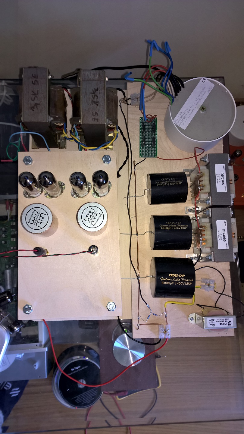

Lot's of interesting versions of 6e5p amps. What's the chassis of the latest one made from? Not the wood top but the rest. Got any under-chassis pics of it? I'm always interested in construction methods that are atypical.
I have some 6e5p tubes that I bought a while back but haven't tried them in anything.

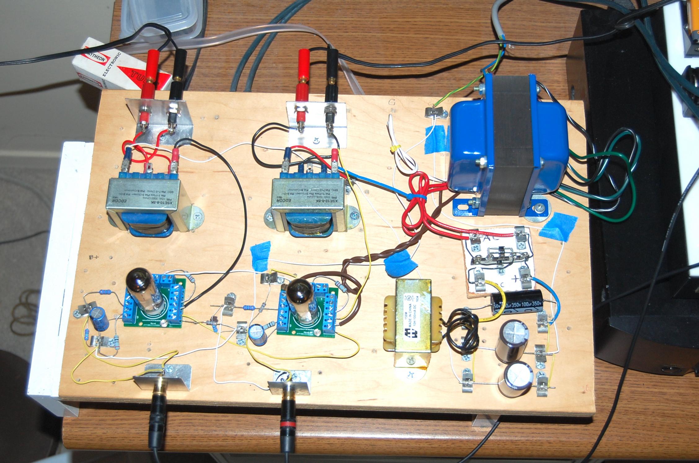

Strictly speaking, if it can't be used with only a line level signal it's not really a SPUD.
As I mentioned in that other thread, I've never set out to build a SPUD, but it turns out that I inadvertently built one.
I modded a little Voice of Music SE 6BQ5 amp that normally uses a 12AX7 input tube that's mounted on a separate chassis. I eliminated the connection to the 12AX7, along with the global NFB, so that I could use the amp section with whatever preamp I wanted.
I left it in pentode to maximize the power output and added local NFB. I have no way to measure the power output but I assume it's probably in the 3 to 4 watt range. Whatever it is, it's enough for me using speakers that are probably ~92db.
When used as I intended, with a preamp, I would not consider it to be a SPUD.
What surprised me is that the amp works very nicely with no preamp - either a "passive preamp" (simple volume control) or using the volume control on my computer to stream to the amp using an Airport Express.
I would not have thought that a 6BQ5 / EL84 could be used to build a SPUD but it sounds wonderful.
I use for output transfmer what i have on hand. This 600R is wired to 4, and speakers are 8ohm. So it acts like 1200R x 6 - every tube see transformer like 7200Ohm.
Input transformer ratio is 1:3 (impendance is 100:900).
I use for source cd player connected to DAC ASUS Xonar Essence One. I use DAC for volume control. It is much better than any pot.
1200R OPET is about 10Henry on primary, right?
6E5P Anode resistance is 8K ohms
parallel 6 tubes 1.33K ohms anodes of 6 tubes
1.33K ohm / (2 x Pi X 10Henry) =21.21 Hz -3db
if we lower OPT from 1200R, will the frequency cutoff will be lower such as 10hz -3db?
With so many tubes connected in parallel, do you have trouble with oscillation?

1st question:
- for 2 parallel of 6E5P tubes the OPT is 3.5K : 8 (each tube see OPT like 7.K)
- for 6 parallel of 6E5P tubes why the OPT is 1.2K : 8? (each tube see OPT as 7.2K)
Why need to add more 0.2K when add more 4 tube.
2nd question:
2.1 Instead of using OPAMP why replace by Step-up 1:3 interstage transformer?
2.2 I think nowsaday many people use "gyrator" to driver tube in replacement of 1:3 interstage transformer. If capable of using gyrator with tube to drive 6 x 6E5P what tube and MU need to drive them at 9 watts.
1st question:
2nd question:
1 - Ogonowski selling transformer 600:4 (1200:8). Maybe he could wind for you the transformer 1.166,66666:8.
But when you will build 10 or 20 different amps, you will see that with tubes even 10% diference does not mean nothing.
2 - I have transformer in stock and no opamps. And I have only 1 day to build amp.
Of course, you can use anything you want.
