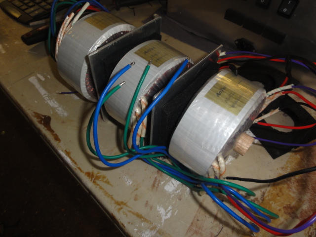

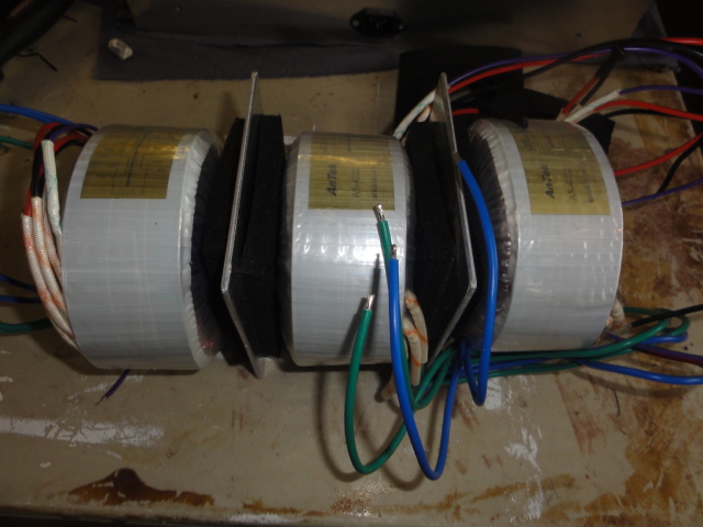

This is roughly how I plan to mount the toroidals.
As you can see I have a 12mm rubber/3mm Alloy/12mm Rubber sandwich setup.
There is a 25mm Dowel running through the center and so a 25mm hole through each layer.
Will this setup prevent EMI between toroidal's. What is the minimum distance/shielding in this case.
Dean
