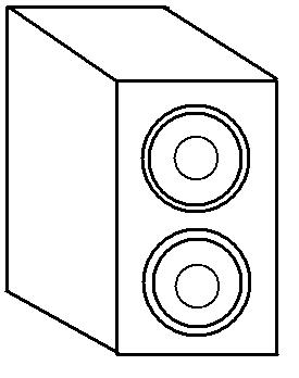

Not at all, I want you to install both woofers like this :
__
Both firing in the same direction, one above the other.
If you want to go with isobaric, then the first design is better, the second design you posted is not good, thermal problems and worse air coupling.
Here is another drawing...
Put both woofers, both on the front baffle.
