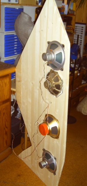

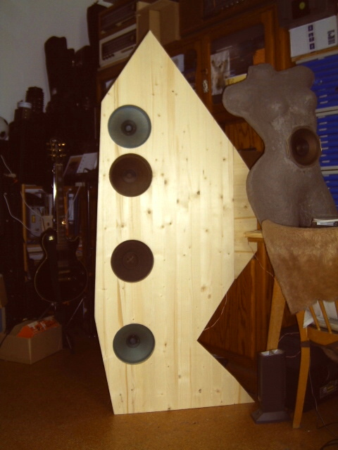

I like to show you my (little different from other) open baffle project.
I make some "crazzy" tests with edge simulation software. Than I built this baffle and I can tell you: "It sounds great!"
I can enjoy rockmusik, classic and jazz without missig anything! Never hear jazz before! I hate that! With this speaker it´s ok!
Only for deep-low frequenz, like Soundtrack: Titanic it´s not usefull! Maybe, I added a Dipol-Sub for that; time will see...

Hi sreten,
first it seems to be not so good, that the speakers are near to the corner of the baffles.
So, if you put the speaker in the middle of the baffle, you get a little bit deeper frequency, but you also get a 2dB peak at 450 Heart and a 2dB hole at 1000 Heart. (see on picture)
Than you have to built a network for compensation! I don’t want something like this. The form of baffle with the position of the speakers is the acoustic-eq!
I do not need any network for correction.
To make a 0,5 system: Than I don’t get what I want! I know what you mean. It cut some mid and high and it seems to be a bigger deep frequency. But not lower frequency. The speaker and the baffle can’t play under 50 Heart. It’s a mechanic problem. And it’s really only necessary, if you hear music from cine with deep low freq.
Sound’s very good, in this constellation; I take a lot of different chassis to check, witch combination works well together.
I make a lot of test with baffles and other kind of speakers: closed, with and without bassreflexion; rear loaded horns; back ventilated; and resonance box. and now I think: “this will be the one I like, for a longer time!”
The best´s so long the best, since you find some better thinks!
