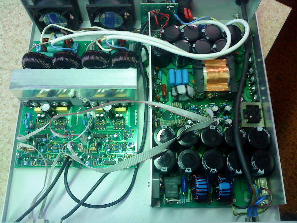

Looks like a lot of people have copied the QSC and Crest SMPS schematics.
sam
Well, using an LC or LLC tank over the output transformer is a well known technique that you can see on any reference book, I dont think that the following brands are simply copiers by doing just that:

Being involved in Andy's project, I cannot let spread such bad publicity. Yes it's a SMPS with resonant tank but hey it's a very common topology that QSC did not invent (for the little story, QSC first SMPS was done by an external freelance engineer, not by QSC team).Looks like a lot of people have copied the QSC and Crest SMPS schematics.
sam
Schematic, PWM frequency, protections, parts, layout, everything is different in Andy's project. Andy's SMPS features also MCU, PFC, thermal tracking and floating outputs that are not present in QSC nor Crest. The true is that Andy's SMPS was build from scratch with very specific requirements, not to copy someone's job...

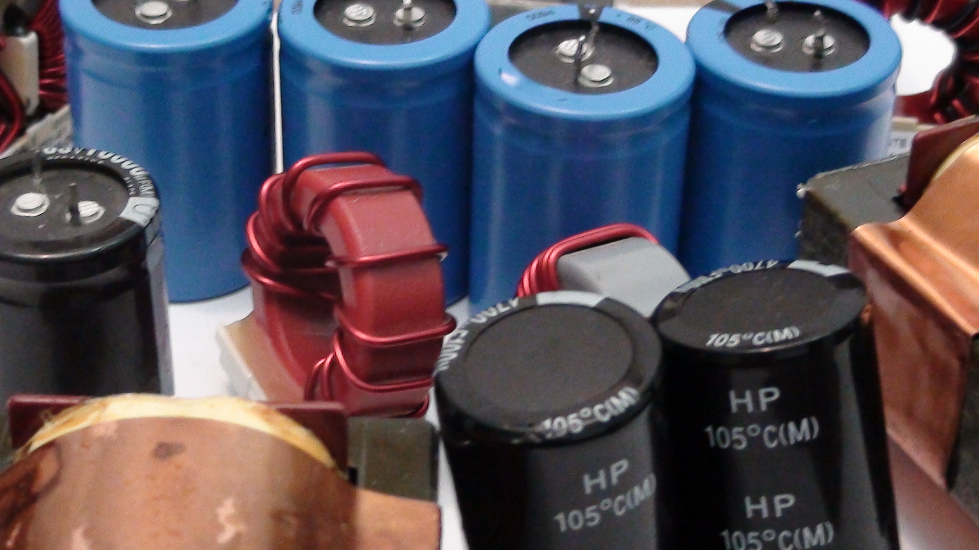

I would say, on the photo is NOT a smps with LLC resonant tank. For me it is more like a smps with series resonant LC tank, like in prototype by AndyF... 🙄 For me "LLC" means, that the resonant tank contains two separate inductors and one capacitor, additionally to the output transformer. Sure, there are topologies with weak coupling of the secondary in output transformer, so that the transformer's primary acts like a separate inductor, but it is already more complex variation, I think... 🙂
About various resonant topologies: http://scholar.lib.vt.edu/theses/available/etd-09152003-180228/unrestricted/Ch4.pdf
EDIT: it seems to be patented: http://www.freepatentsonline.com/6344979.pdf 🙁
