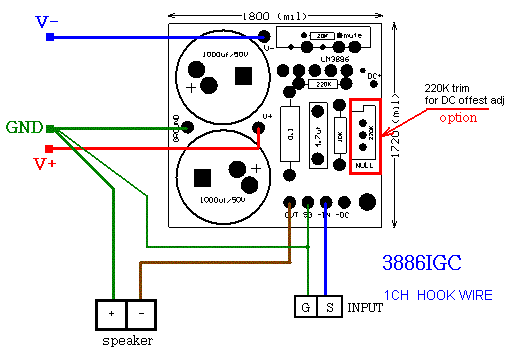

I think he was referring to the three holes with the silkscreen rectangle around them labeled "NULL".
The place is next to the mounting hole.
My guess was a 10 turn pot since it is labeled with an Ohm value and has 3 holes.
Thanks,

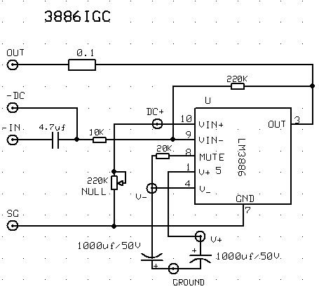

one newbie question about your design, which BTW I think looks really very nice: what goes into the null pads and what does it do?
thanks
"null" in chinese sounds like "turn".
you can put a 10 turn pot(220k) on the "NULL" pad.it is set up to adjust output dc drift.can short it in normal used.
here are sch file:
here is 3886 gianclone partlist:
2 PCBs for stereo amp:
3886igc PCB *2
1000uf/50v *4
LM3886 *2
220k 1/2w *2 (gain setting)
10k 1/2w *2 (gain setting)
20k 1/4w *2 (mute)
0.1/5w *2 (option,can be shotr.for output)
220k trim *2 (option,can be shotr.for dc offset)
heat sink,screw,hook wires.

Mils is standard in the pcb cad business and is 1/1000 of an inch.
1.8 x 1.72 inch 😀
... and the reason for using mils is that the programs in the early days had 32000 x 32000 or 32768 x 32768 as max values of the coordinates. This gave us 32 x 32" as max board size. Worth noting is the program "Boardmaker(?)" or something had 4 x 4 billions in max values. The resulation was 0.1 um and was used for silicone chips. It ran on Mac in the 80's and could be connected to a mainframe. Those where the days.
