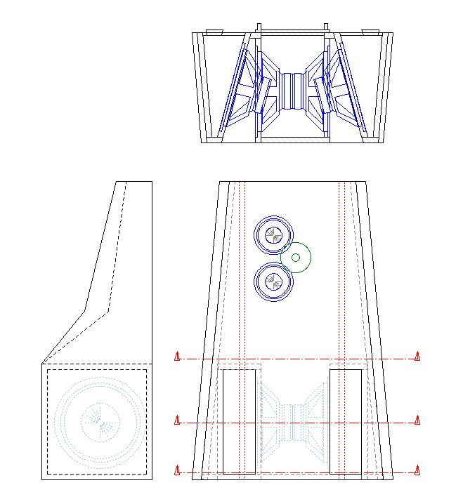

Lousy sketch of my thoughts so far

Here is a quick & nasty to get across what i'd do with the woofers ... since i'm stealing time from what i should really be doing, i just grabbed a concept i drew sometime ago... for your ap, i'd forgo the angled bits for the woofer (original was for a pair not a quad), and the other fancy bits (althou there iare a lot of conceptual detail in the drawing to be borrowed)
Forget the woofers up top ... try to make them appear as a single driver.

Dave's idea is interesting, but a bit of a complex build, being lazy I'd do something simple like the Visaton 'No-box' with the woofers down one side and the MTM beside them centred at around ear level. Another option is to consider the layouts that Lynn is thinking of in 'Beyond the Aerial'...

In this case, i'd chop the top half off, and flip one of the pairs around to get push-pull

having discussed this with SWMBO I am probably going to go with the simplest layout of all, a shallow "U" frame maybe 100/150 deep.
AND just because I have everything I need to do it, it will be actively crossed to the sub at 40Hz and I'll actively cross to the Vifa mids at whatever frequency sounds best keeping it as suggested around 200Hz.
This way I can get a little more power handling from the 12's without blowing them out of the gap when I forgetmyself and turn the volume up to 8 on Carmina Burana.
I'd cross to the subs lower but 40 is as low as the CX units go.

Will the woofer get any real benefit from offsetting from the baffle centre-line I could do 35mm easily enough and if I do does it matter if the mids are offset on the opposite side or should I keep the offsets the same??
That question has not arisen for me before as I've never played with a baffle wide enough to allow more than 10mm before, but in the past I have always offset to the same side of the centreline.
I know I'll be loosing something by not using a "H" frame but I get huge gains in WAF

You could consider making it a bit deeper ((at the bottom anyway ) and narrower and mount the bass drivers on the 2 sides.

Hi Rudolf, in a previous interchange you were letting me know of the advantages of the "H" baffle for bass in these types of speaker drivers, I decided on the simple "U" frame for WAF reasons, how-ever my beloved has said that I can build something a little bigger 'with-in reason' to make these acceptable they have to be nice furniture as well as sound good and I respect and understand her feelings here.
does it matter if I mix both a U & H baffles in the one speaker??
If I use an "H" baffle for the lower two woofers it will look better in the eyes of herself and I think myself that this wold also look better.
So here is second proposal,2 lower woofers H baffle 200mm either side of centre then a "U" frame for the mids, tweeter and top 2 woofers.
It would look like a flat board sitting on a box but I can pretty it up some, and similar in a lot of ways to OB mids sitting on a box the "Blackwoods" come to mind.

I would try to avoid using "complex" solution. Simple baffle is always the best sounding and looking. So perhaps it doesn't have to be 4 woofers but 3. WWWMT. I think that would still put the mid & tweet at the correct height.
On experiental level perhaps try to arrange the Woofers like CS1? So 2 in front, 2 at the back. I'm not sure how they sound.

It's all a matter of perception, I don't feel that this is actally a "complex" speaker, really it is a clone of dozens of other designs and really the only difference between this and my last one is the number and size of the woofers.
While I agree that simplest is often the best I think this is pretty simple.
Chosen baffle size is luckily very close the one that modelled best, these woofers are very smooth and well behaved way up into the late teens, I used a first order XO on them in my second last practice baffle and no problem so I should have fewer problems using LR4 electronic, the Vifa P-13 is very well behaved and comparitively easy to work with and the change to a D27 has been documented my dozens of others in this forum and others.
I am lucky that I can stand on the shoulders of others.
As for using 3 woofers in parallel, I like the idea a lot, I've never made it sound good unless all the drivers were in parallel, which means rewinding the voicecoils.

With H-frame on the woofers I dont think you need U-frame fore the mid/tweet...actually I suppose it would be best with a plain ordinary OB baffle fore the mid/tweet

Hi Moondog,
since St. Cecile is the patron of all musicians we really have to give SWMBO some pretty speakers to rest her eyes on, don´t we?
I could not imagine how a symmetric WW MTM WW or anything else with such large woofers above the midrange could look good. But then I remembered some weird towers featured in those hifi mags of my youth:
You could build a 4-woofer line along a baffle of may be 140-150 cm heigth. Don´t space them too even (like on my sketch), but leave more space between two drivers where you want to put the MTM baffle. WWW MTM W would be fine too. Put all woofers to the outside edge of the baffle and the MTM on their own baffle to the inside edge. You could even let that sub-baffle protrude from the inside edge of the large baffle, perhaps in a bowlike shape.
It is paramount to have the MTM sub-baffle close to one side of the wide baffle and NOT in its center.
An U baffle could be made of two tapered wings. You may even fold them inwards up to 20° to keep them "out of sight". If the position of the MTM needs a cutout in the wing to clear the driver baskets - don´t hesitate.
It may look really freaky on my scribble, but I can imagine very beautiful ways to integrate the sub-baffle and let it really shine.
Let me know what you think about it.
