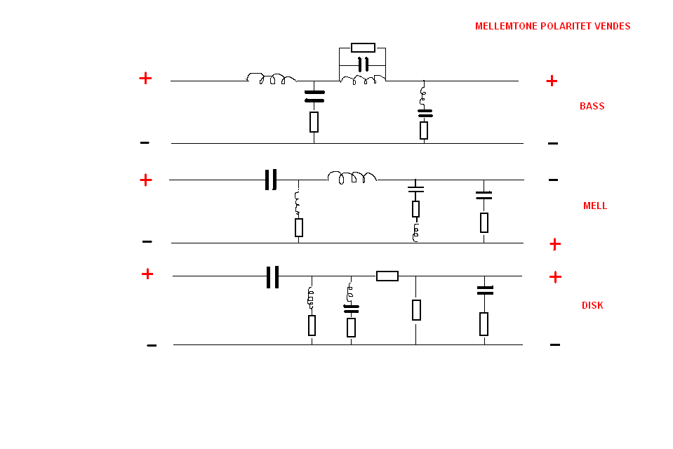

hello philiprej
there are a few important things for me :
- First, as it has been said before, you must take care of drivers time alignment, the higher order your crossover is, the more important this is for sure. This can be done by physically offsetting drivers or by using all pass delay filters. for tweeters, a small waveguide is a very good bet. If you don't , music will loose coherency, what you could call "life".
- Also, i guess from your previous statements that your bass and mid drivers have cones made of paper or polypropylene, because if not, it would be very unlikely that you like the sound of a first order crossover on them. If it's the case, using 24db slopes is clearly overkill. The advantages are not so big, except on stressing the drivers less, but if you chosen your crossover frequencies carefully this should clearly not be a problem, especially in a three way.
So my advice is, bypass 2 poles of each sections of your crossover. if you made it linkwitz they are identical so you should have a 12 db crossover , and see if it sounds better for you
- also if i understood it right you bypassed your mid driver in the first order config you like ! this is a huge information, maybe way more important than crossover slope !
in fact , maybe it's a very important factor in your appreciation, may it be for the reason that your mid driver sucks
more seriously, midrange coming out of a bigger driver is clearly not the same thing, the distortion and breakup topics have been covered but do not explain anything about why you should like it better Without your mid driver.
the fact is that the dispersion pattern of your midrange will be much more narrow if coming out of a bigger driver (wich i assume is the case) depending on the space you are listening in, having a narrow dispersion pattern in the midrange could be a clear advantage, bringing information back into the music
anyway, we seriously lack information about your system, your room , the drivers you use. the modification you made is huge and there are many things that could have led to your preference, so please enlighten us !

First off this thread really belongs in the Loudspeakers section, imho.
A few thoughts:
The TL082 is not a particularly good sounding opamp. I'd expect to hear its effects, period. Don't judge ur results unless you run the control situation through a TL082 as well. I'd pick a much much better opamp myself.
Secondly, as someone noted in passing, the acoustic response is what counts, not only the electrical response of a filter. Get the system correct as a whole.
