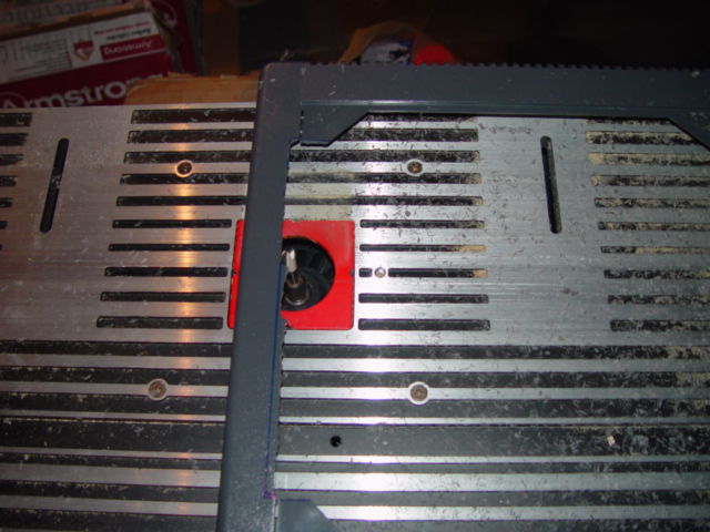

Glad you're on the right track. First off, depending on your screen size (mine is a 15" diag.- leaving a 12.5" horizontal length), one may need to mod the size of the stage so az to reveal the entire fresnel on the horizontal- which is 12". I can live without the .25" on either side. The vertical is not a problem, and does not need cutting. In my case, I have the reduced jacket MH @ 400w, and it fits snugly where the original lights were. However, I removed the entire section containing bulb brightness, fan, and switch- basically, the only plastic parts other than the cover- all the rest is metal. I am actually still using the fan which came with the projector as it can suck a damn good volume of air and it still fits nicely next to th bulb. In most cases, you will need to remove the internal components section when retroing the standard MH. The ballast can easily be placed behind the mirror, or right next to it so as not to obstruct the light reflex. I don't know how it is in your case, but my projector doesn't use a condensor lens system, it just reflects light directly from the bulb. So, perhaps not enough light was making it efficiently to the fresnel- i am certain this is my prob. I will post some detailed pics of how I had things tonight.

if you look at sweetrobot's post #2 he is saying he moded the stage to achieve the 12" i also did this on my 3m 9800 but you need a bigger fresnel
i am using one from an elmo a305sd ohp
but u loose a very small portion of the active area on the lcd
i have orderd a new fresnel that is supposed to display the whole lcd but i havent recieved it yet i will post a review on this fresnel when i get it
look at the pic below so you can get an idea how to mod your ohp
for the 15" lcd
hope this helps
for the 15" lcd
hope this helps
