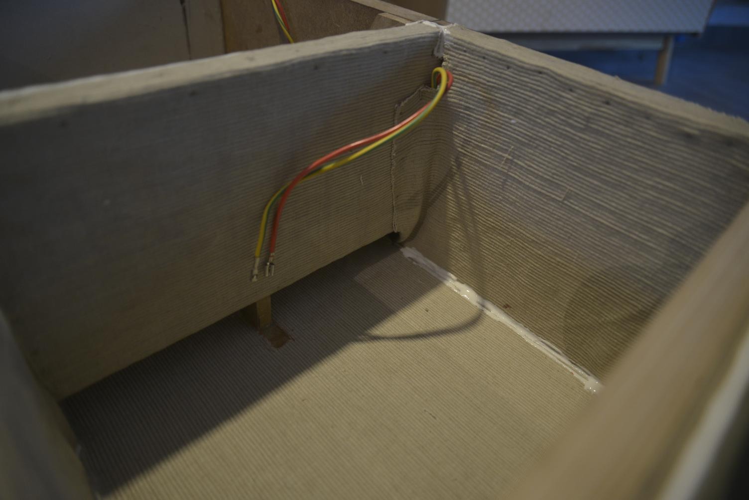

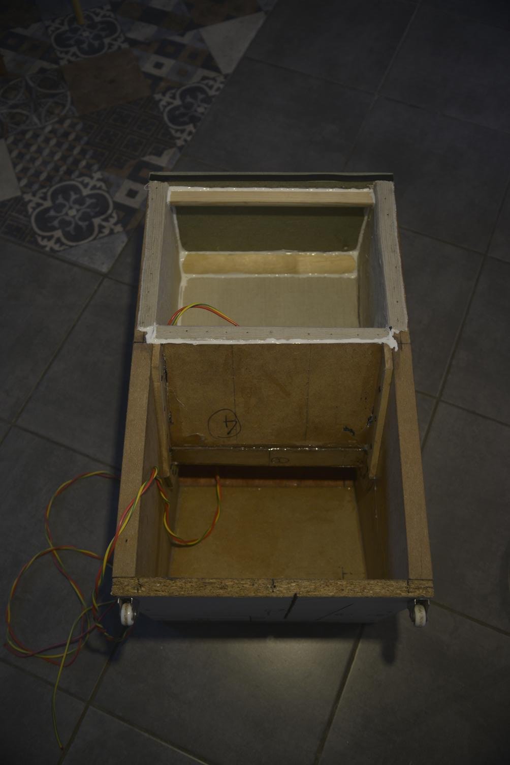

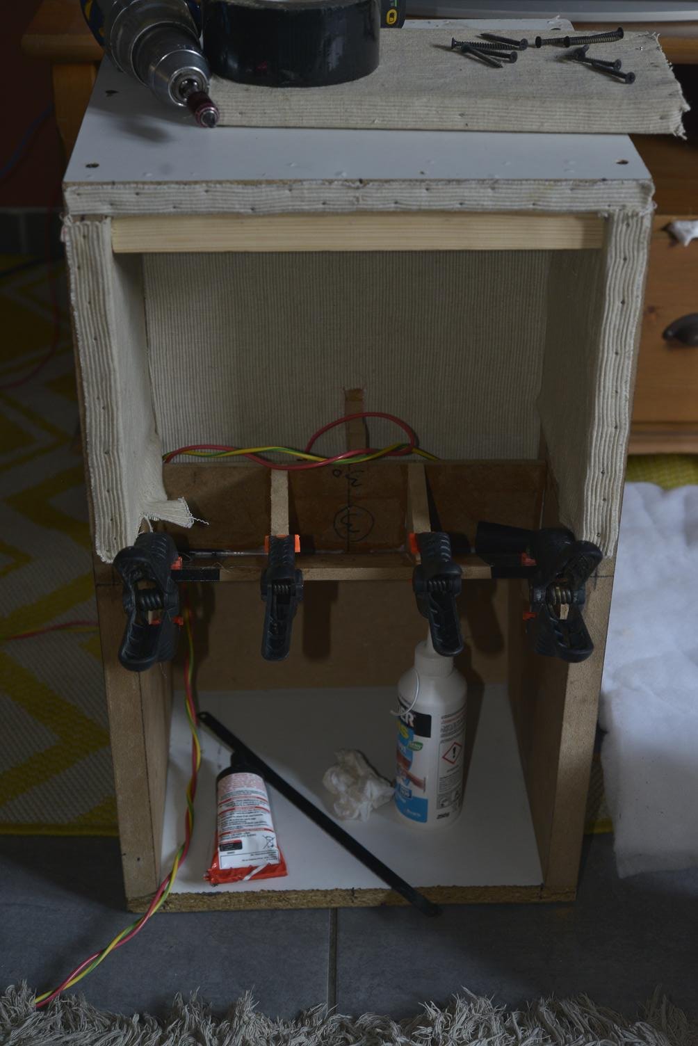

I've found a 8" speaker for 5€ and I need more SPL for my bass guitar, so i've
tried to do a low-cost woofer. It was like a DIY frenzy... I've learned about TS
parameters far too late during the process, and I'm not sure what the design
really is: my inspiration come from rear-loaded horns (cool wood-work exercice),
but with a 12L "box" before the horn. Maybe it's a labyrinth but my "horn"
section increases. The "horn" length is the only one thing i've done on purpose:
1m13 is 1/4 wave length of 73Hz, the speaker Fs.
You can see the idea with "tobo1.jpg" to "tobo5.jpg" that show it during its
construction.
It's already a "win" for my learning process, but I found the result not too
bad for "loud hifi", and even quite good as a bass guitar cabinet. So I
share this there.

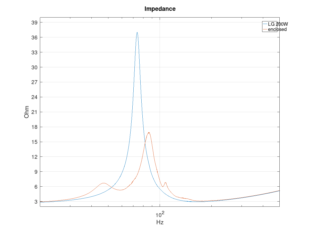

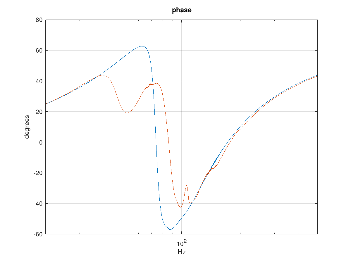

The speaker is LG branded, 3Ohm, 200W, impedance measurement give me Fs=73Hz,
Qts=0.82, Vas not done. Impedance / phase measurement attached, with the speaker
in free air, and in the 1st cabinet build.

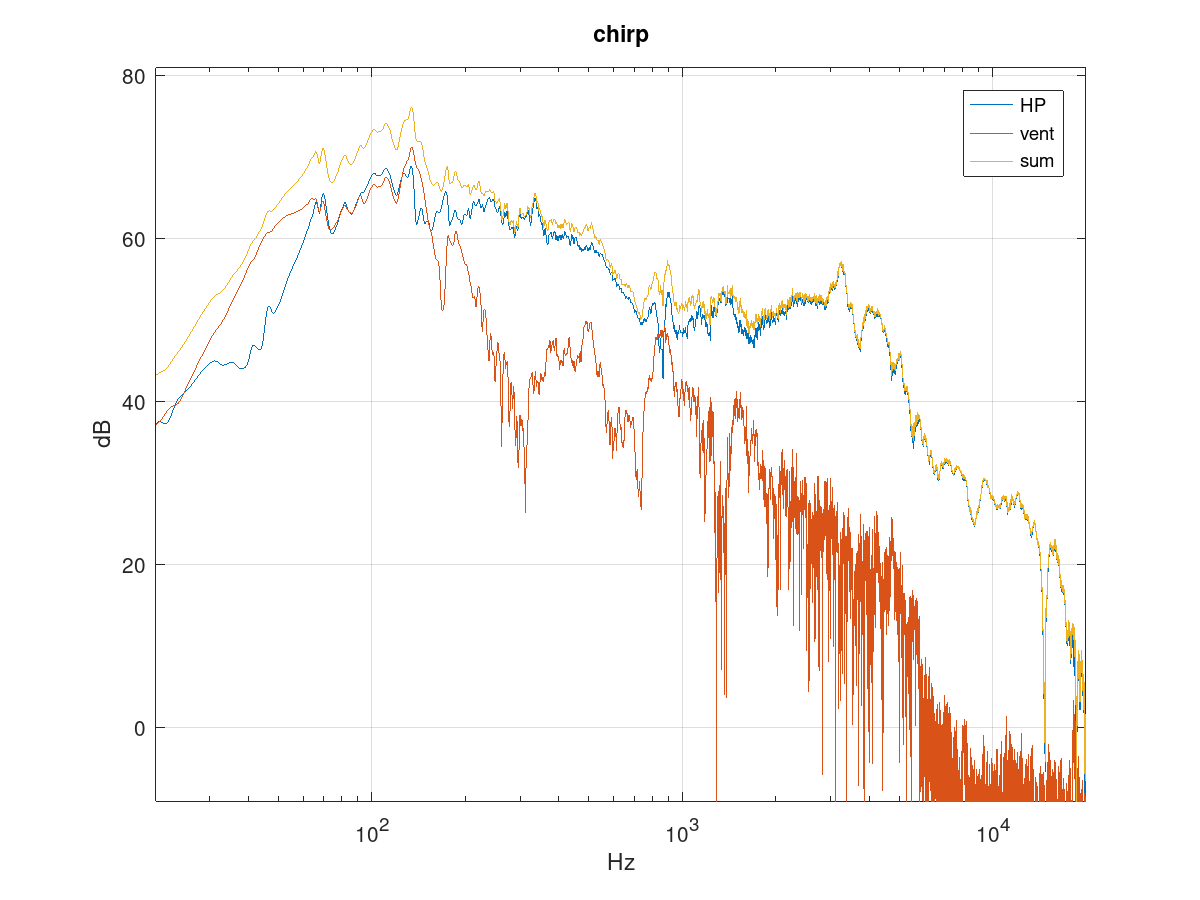

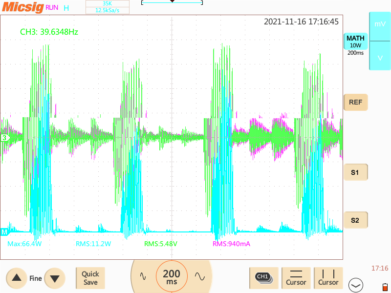

With my 1st attempt, I have 92dBA SPL at 1m, for 80Wpeak measured (snapshot from
my scope "scope_first.jpg" attached), above this level I can ear noises from the
cabinet (leaks and vibrations). I've done a quick SPL measurement, in
"chirp_sum.png", I've captured response from the speaker and from the event.
After some screws, glue and work, the 2nd attempt is louder: 98dBA SPL in the
same conditions (100Wpeak, see "scope_2nd.png")... Now distortions come from the
speaker that reach its Xmax, and things in the room that vibrate. No time for
now for more measurements on this version (impedance, spl...).

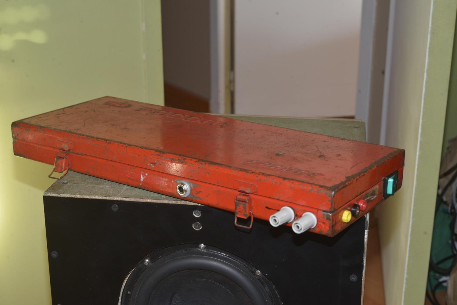

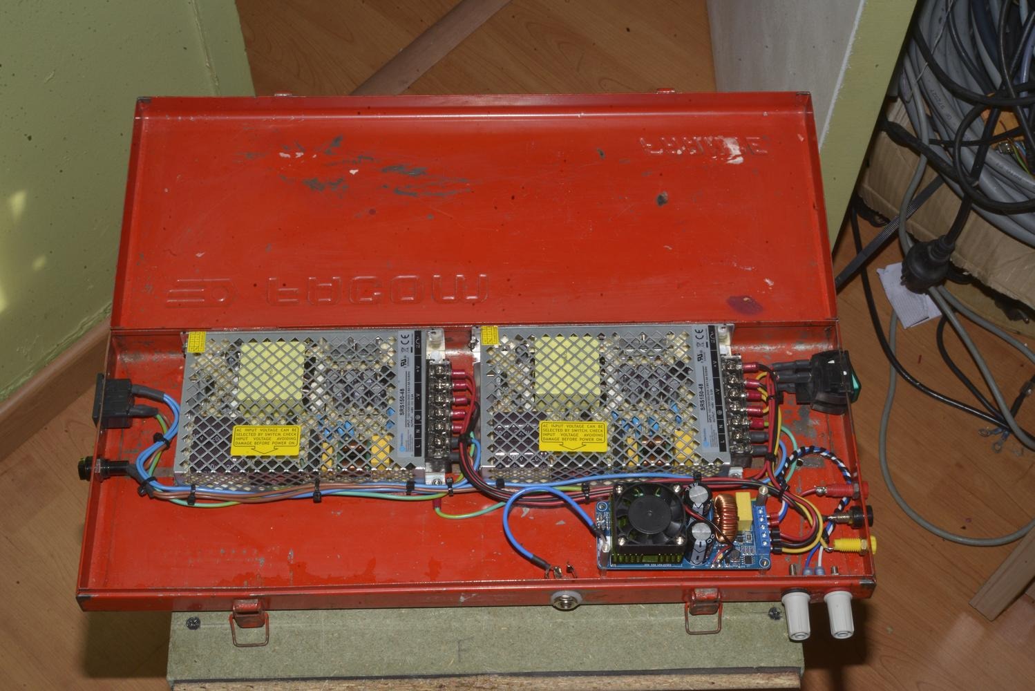

Power amplifier is an IRS2092 class-d module, found on ebay, given for 500W,
measured at (least) 80Wrms in 10Ohm resistor, no heating.
Two 48V 3A SMPS to supply the module and some wiring later...
My bass cabinet alone can't take it full power, but this is an upgrade for
later...
Now I need a preamp and a limiter, the power amp start clipping for an 0.3V
amplitude input.
1st stage is done: see fig 4 at https://sound-au.com/project152-1.htm
Any idea to convert +/-48V into +/-18V or less, to supply my op amp based
preamp ? I guess the voltage diff rule out 7815 or the like ?

Lm317 lm337 will work. There is also a High voltage version of the lm317. The lm317/337 are floating regulators. As long as the output voltage minus the input is less than the max rating you are ok. Look up lm317 for high voltage application notes. Generally you put a zener diode across the lm317to protect it. I use 317/337 for a +/- 75 volt regulator.
