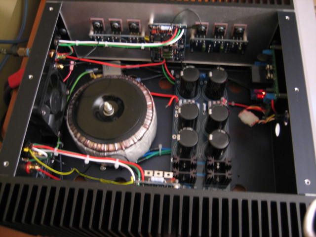

Well I'm finally done... almost. The Antek transformer buzzes something aweful, you can hear it across the room and the right channel hums at the same resonance as the transformer.
Other then this last item, everything is working perfectly. The sound is more laid back like a tube system. The imaging is unbelievable. It sounds like there is a large monoral speaker in the center of my listening room.

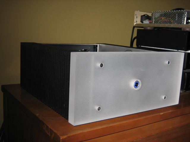

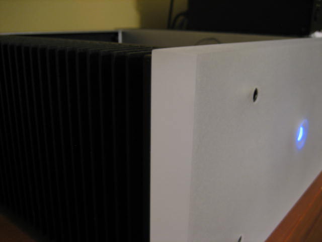

The front panel is 1" thick lexan that I frosted with an orbital sander using 120 grit paper. The recessed holes are drilled with a forstner bit on my drill press.

I found the source of the loud buzz. I traced it back to my front porch light. Who would have thought!
I still have a slight hum on the right channel. I'm trying to trace back to the offending part or a possible ground loop.

Very nice job! I really like the front panel. It gives me something to aim for in my aleph in progress. What is your transformer rated at? It looks like you switched from two to one?
Yes I switched from 2 transformers to 1 based on recommendations here in the forum. I think I have gotten good advise which is if you are using 2 transformers you need 2 bridges, and I only planned on using 1 PSU.
The transformer is an Antek 45+45 at 800VA. I hooked up the primaries for 230VAC to run off 120VAC to get 22.5+22.5VAC. The transformer is not very expensive on eBay. It does hum however, enough so that you can hear it in a silent room about a foot away.

What is the BIAS current and the rail voltage of your amp?

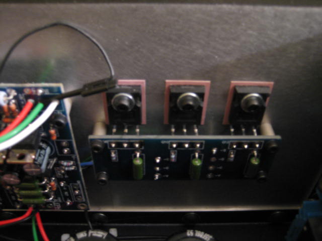

The bias and voltage are set to stock values for an Aleph30. The stock values worked well with the largest MF350-151.5 heatsink from www.conradheatsinks.com . I can leave my hand on the heatsinks for about 5-6 seconds after 3 hours, and about 4 seconds after 5-6 hours of use. A pretty decent temp range.

That's a nice chassis. How do you like the power on/off power kit?
Thanks Jason for the kind words, and especially a BIG thank you for pulling the parts tGB ogether!
I'm using Maxhawks power on kit. It works really well with some very nice design touches. I particularly like the jumper option to configure the power on state. I have mine set to power on automatically when AC power is applied. This works great if a person use a line conditioner to power on a system as I do.
The recessed blue softwitch creates a cool blue glow in the Lucite front panel in the dark.

There are a couple of errors for part orientation on the underside of the PCB silkscreen. The errors are documented in the GB thread. Mine fired up the first time.
