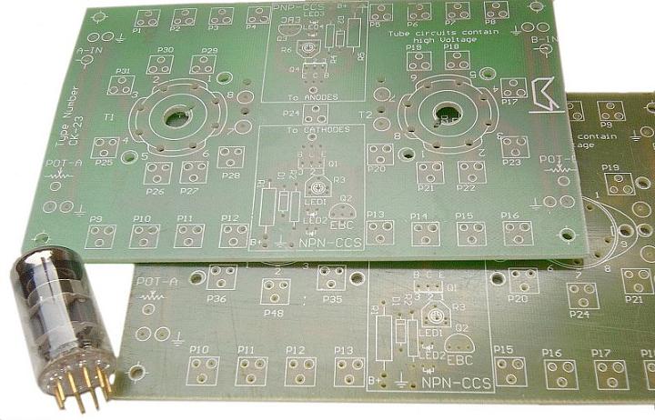

CCS means constant current source. IXYS is a manufacturer of solid state devices.

Prototype Boards
For those interested, there are a couple of other prototype boards around.
This I saw on Ebay:-
http://cgi.ebay.co.uk/VERO-BLANK-PR...4196279QQihZ002QQcategoryZ50423QQcmdZViewItem
But I went for the one from ( Classic Valve Design ) pictured below.:-
www.classicvalve.ca
This features spaces for anode and cathode CCS.
