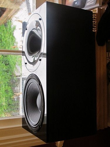

Hi all,
The project is back on track after some bad experiences with USSpeaker and a faulty DCX unit. Pic attached of enclosure finished last week. Enclosure is matt black enamel painted MDf with a gloss black acrylic front cover. I will be taking the first measurements tonight and start setting up the xover.
Over the last few days I have been running a 3rd order butterworth xover with BSC and waveguide correction (by ear) and at first impression I have to say that the DE250/DDS combo sounds excellent. It is as clean and transparent as the planar tweeters I have listened to but much more dynamic. The DDS is also alot cleaner and less coloured than a damped dayton 12" waveguide I tested earlier despite the latter fairing better in measurements.
I am having some issues with severe colouration from the woofer that I cant solve. I am starting to think that its positioned too close to the enclosure walls which is causing the problems.
I ran a slow sweep to try and isolate the offending frequencies and was surprised to hear large peaks and nulls from 150 hz to 1000hz of about 8-10db. I placed my ear up the woofer to ensure it wasnt room modes I was hearing. When certain frequencies are hit the woofers ring like a bell over a window of about 15-20 hz.
Enclosure has copious amounts of polyester stuffing. I have tried adding more, plugging the port, even removing the back at one point to "let it breath" none of which seems to help. Internal box dimensions in mm are 530H x 260W x 210D. The woofer cutout is about 15mm from the side and bottom enclosure internal wall. I have not the bevelled the cutout yet but I doubt that would cause the problem - its not a little resonance, its big and bad.
