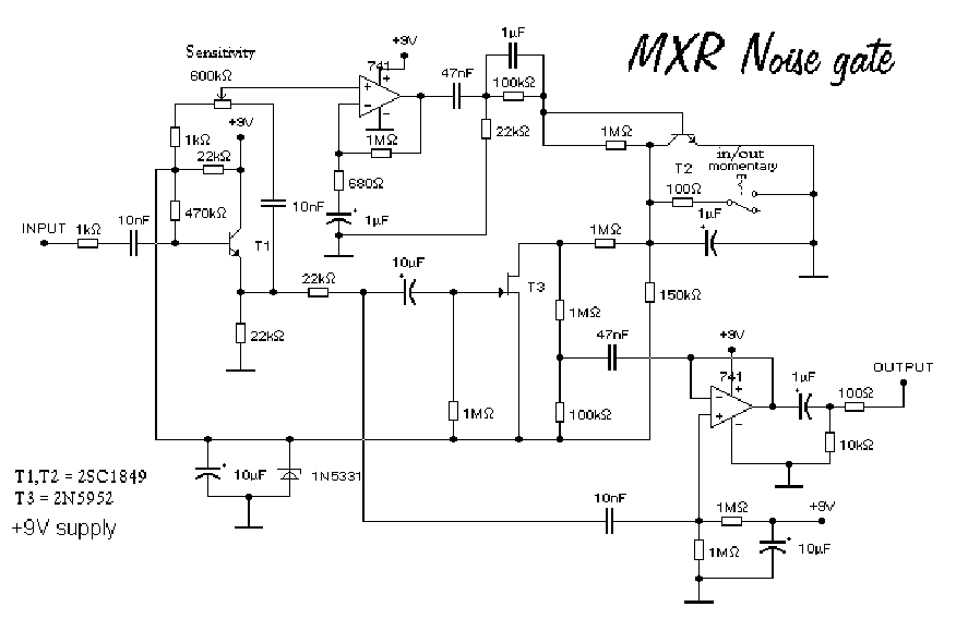

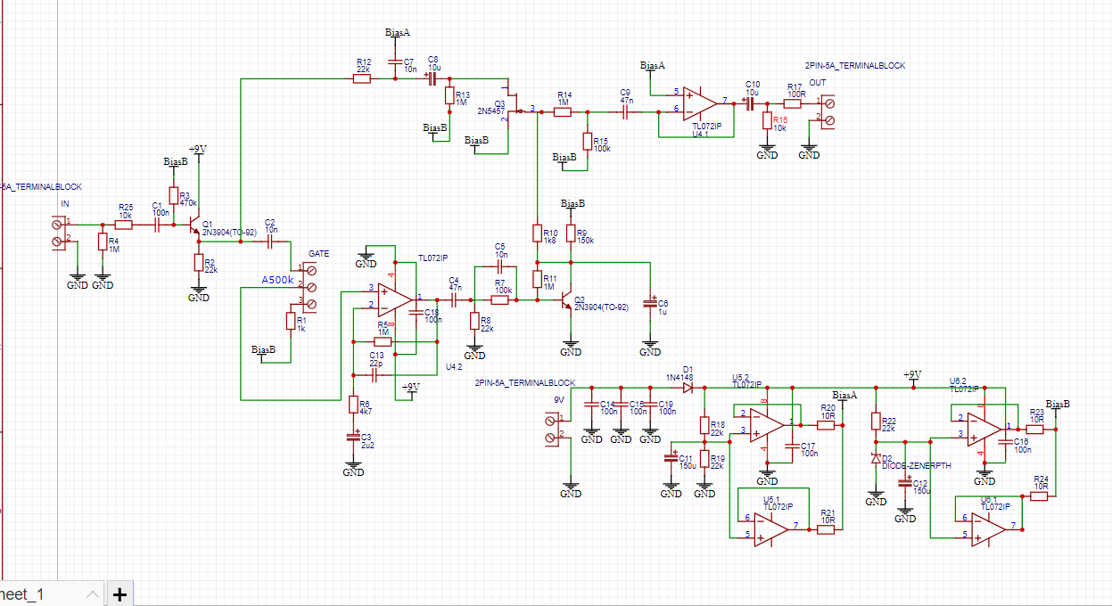

I've been working on my MXR Noise gate clone recently, but I found one issue and can't figure it out by myself. The Noise gate works, except that the last op amp U4.1 doesn't do his job. When the Bias A voltage is aplied, the bias voltage apears on both the pin 5 and 6 so then it doesnt do his job. When the bias voltage isn't aplied, then there is signal coming out of it. I added those improved active bias generator with 2 op amps. I tried to remove them so the bias voltage was taken from the resistor voltage divider but with no change. I would really apreciate your help. Thank you very much🙂. The first image is schematic of my circuit and the second one is original circuit.

That JFET must be drawn wrong, and I don't see how that output stage ever worked with no resistor in the NFB. I don't understand why the bias need four opamps?
Can you point to where you are getting these plans?
