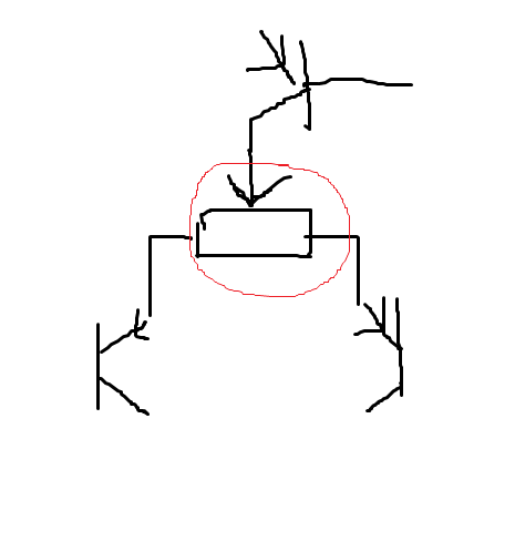

So if I change r19 and r21 they need to match so if I change it to 120ohms the other one has to be 120ohms as well correct ?
No, you need to unmatch them to trim the offset. For example 93 ohms for one and 107 for the other. Whatever it takes.
Ahhh your picture confused me so for example I would just change out r19 with a 200ohm trim pot correct ? And I would leave r21 as a 100ohm resistor ?
The single trimmer replaces both resistors with the wiper going to the transistor above. You would use either a 200 or 220 ohm trimmer.
I'm not recommending you even attempt this because if you get it wrong it will probably not end well...…. an offset of even -/+100 mv causes only 1.25 milliwatts in an 8 ohm load.
So let’s say an offset of 50mv is that enough to kill a tweeter. Cause when you initially connect the speakers to the amp that voltage goes through mind you my tweeter is a 4 ohm I really don’t want to burn another tweeter they are extremely hard to find and very expensive . I know the crossover blocks dc but the initial connection lets some voltage through that momentary voltage is that enough to burn the tweeter ?

Also I got the dc offset to 6mv by just swapping and matching the bc556 transistors
