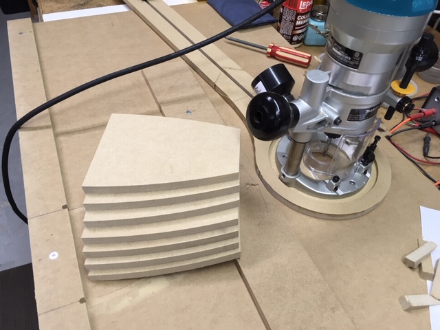

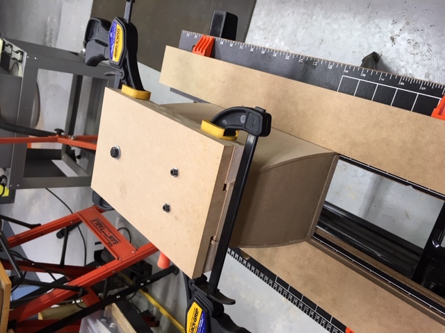

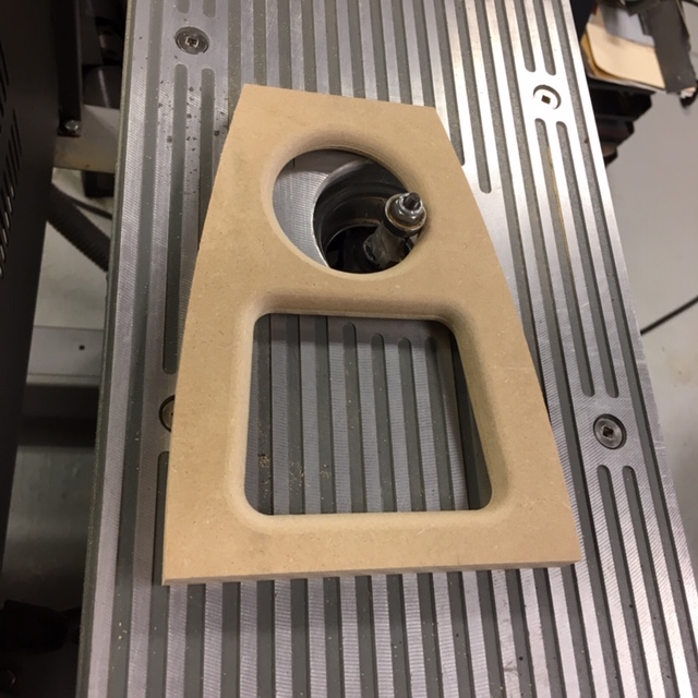

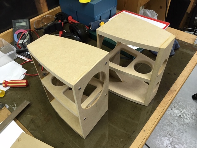

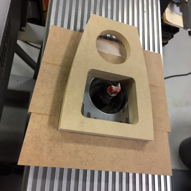

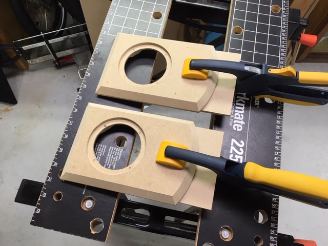

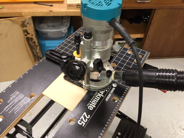

This is a very small scale project I'm working on to try out making curved side speaker cabinets. If it works out well I'll try using the same approach with these drivers.

Thanks for the info! For now I'm just bending layers of thin sheets over the formers.

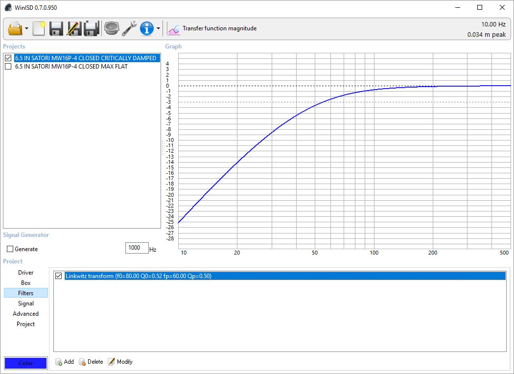

I just started to investigate this. Are you talking about this miniDSP biquad functionality:
Linkwitz Transform
and this sort of crossover:
https://www.diyaudio.com/forums/multi-way/277691-harsch-xo.html#post4402917
Joined 2009
Yes minidsp have a Linkwitz Transform biquad fonction ( you can apply it using other ways, usually it use one or two parametric eq band, sometimes more...).
You can simulate it using winISD ( the freeware have a dedicated tab in the eq/filter section and it will give you valuable simulation including xmax and power requirement). I suggest you try it (to have an idea of limitation and compromise).
You could try simulate here too:
Calculs d'une enceinte close avec ou sans transformée de Linkwitz, 1/6
It is in french but you should understand what it is about. In case of i can help.
Yes for the crossover too. Xrk did an extensive use and study of it. For your case i suggest you stick with the definition he gives in the first paragraph (below the first OB picture). That said you may not be after a 'quasi perfect transient' crossover type.
You can simulate it using winISD ( the freeware have a dedicated tab in the eq/filter section and it will give you valuable simulation including xmax and power requirement). I suggest you try it (to have an idea of limitation and compromise)...
WinISD FR plot attached. The excursion is scary so it looks like this must be used in moderation to extend low frequency response. The transfer function looks good. As a first thought, might it be best to make a critically damped enclosure alignment and start from there?

How high in freq your sub are acceptable quality wise?
Well that's a good question. I don't currently know!
The crossover is at 90Hz but this will be re-evaluated when I start using REW. There are two subs. I have some room treatment (a Helmholtz passive absorber for example) and have spent hours and hours finding good locations for the subs with respect to obtaining smooth audible LF chirps. The re-positioning effort resulted in a large improvement - so large it seemed like I had just invested $$$ in a new system. It was amazing how this alone improved the overall sound - seemingly not just the low frequencies. But anyways, the result is the subs are not close to the main stereo pair and will be localized if I cross over too high and/or have a shallow low-pass slope.

Ok you discovered the limits of LT in case of low end extension which is a worst case scenario.
Now lets contemplate this case: a satellite and sub use satellite down to 80hz and sub from there.
There is reason for that: below 80hz we have difficulty to locate sound ( and this is even more true in a room and given you are in modal zone it can even be true up to 150hz ime), so if you can locate your 'satelite' within 1meter from the sub center* everything should be fine ( as we are in the enviable position to be within 1/4 wavelength center to center where there is acoustical coupling, sub and sat behave as one and only source).
So try to simulate the satory 7" for 80hz and 0,577 Q and check for spl and excursion. You'll see this should give you much less scarying results and this will be all needed for the high pass part for a Harsch solution ( you'll need a bit of delay for your 'sat' and a 24db butt lp on the sub). The 60hz 0.5Q example is the response if you block your port on the 17l box without a LT.

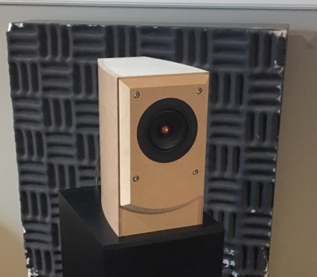

The shipment just arrived! I now have most of the items needed to build and test this project. I have to be disciplined though and finish off my current speaker project or it won't get done. I'll be able to play with REW a bit while the glue/paint is drying. :)

Yes! The pair is working subjectively well so I sort of paused the development to make time for other projects around the house. I need to objectively confirm and tweak with better measurements. Basicly what I have at the moment is 2nd order LR crossover at 1900Hz and baffle step superimposed with a bit of a Harmon curve.
