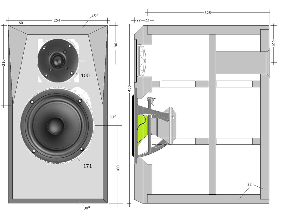

In general, if your amplifier easily drives a 4-ohm load, the 4-ohm MW16P-4 will give you greater dynamics than the 8-ohm version. You will also get superior sound from your tweeter because it does not require extra resistors in the signal path for 8-ohm compatibility.
A 4-ohm MW16P-4 can be used in the slanted-baffle SB_Acoustics ARA, if you want to experiment with a free passive crossover.
TW29R-4 tweeter.... you can swap the lower cost SB29RDC-4 tweeter with little sonic difference. Measurements from serveral websites prove this.
With DSP you can use a flat baffle and insert a delay function. Genius Troels Gavensan has construction an excellent low diffraction cabinet in the Illuminator Monitor website. Simple cuts.. just two compound angle bevels. If you already have the DSP + amps, you could ONLY build this cabinet and ONLY invest in DSP.
If your amplifier can only drive an 8-ohm MW16P-8, I would recommend building JUST the Illuminator Monitor cabinet and ONLY investing time on learing how to create a DSP crossover. ALWAYS FORWARD

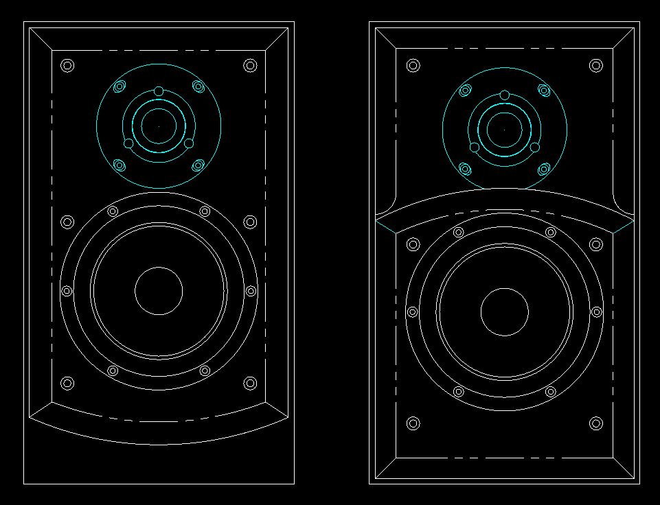

That Illuminator cabinet baffle looks functional and attractive. I was playing around with baffle designs and to this point had come up with the items pictured. The one on the left is flat with beveled edges for an active design with DSP and the one on the right has a .75" (19mm) step to bring the midwoofer forward similar to the amount of offset obtained with the Ara slanted baffle. I think this would make it suitable for the Ara passive crossover from a phase alignment viewpoint. But perhaps it will sound slightly bright on a stepped baffle with the tweeter being on axis to the listener if I am understanding this correctly. 🙂
It would be simpler to make the flat baffle and I may never resort to a passive crossover. I can make a flat and a stepped baffle and compare them too. I have amps but have not obtained a DSP (miniDSP 2X4HD) yet.
I was planning on re-purposing a Hafler DH-200 for the LF drivers. If memory serves, this is a robust amplifier that can handle load impedances as low as 2 Ohms.
1) Hafler DH-200 datasheet confirms very safe 4-ohm operation. Unless you plan to use other amps, the 4-ohm MW16P-4 should have some sonic advantages.
2) Medium quality passive L-R-C for the ARA will cost about 2 x $65 = $130 for the pair. If you do not have a junk box of crossover parts, purchasing just a $250 MiniDSP looks like a reasonable incremental cost. Skip a passive crossover.
3) MiniDSP supports the time delay required to compensate for the tweeter - midrange offset difference. A flat baffle will perform best.
4) DSP cannot remove cabinet edge diffraction distortion. From your cabinet CAD drawings you appear to have very good wood working skills and can cut/route the edge bevels or rounds required to reduce diffraction. Edge bevels seem easier than spending $150 for a 1.5" radius quarter round bit for your router.

BTW. The baffle width (8.5 - 9.0") and tweeter position in the CAD layouts currently mimics the Kairos. The Ara has a narrower baffle (7.5") but is asymmetrically faceted. I'm not sure how that affects diffraction but the baffle steps for the two will be different which will affect the location of the shelf in the crossover if I understand correctly.
Yes, I think I'll start with a flat baffle. I can make another if necessary...

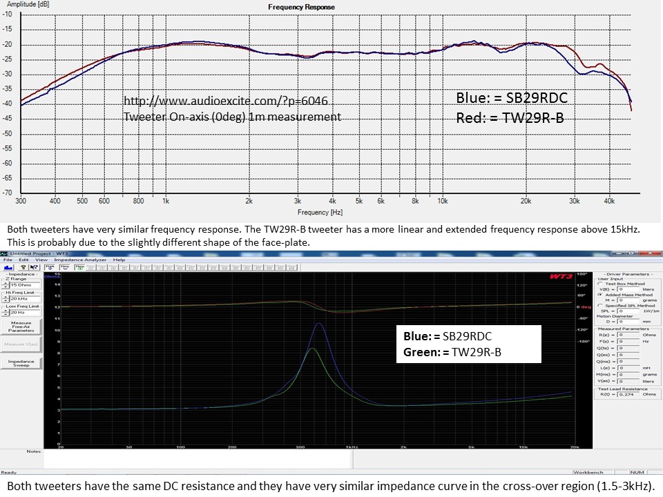

Simply not true! SATORI TW29RN-B is way better than the "standard" SB29 ring dome. And the standard SB29 is good as is. It is not a little sonic difference.
Can the implied large sonic difference be described quantitatively or qualitatively? Like LineSource, I have found references that indicate subtle differences and areas where the Satori is slightly better, but I haven't been able to find any large differences. And in my case, if the differences are at higher frequencies then I won't be able to hear them.
Disagree, i have both tweeters side by side and similar crossover points and slopes, the Satori is always preferred by all listeners and the difference to me is rather huge and more than justifies the price difference. 😀
"Both tweeters have very similar frequency response. The TW29R-B tweeter has a more linear and extended frequency response above 15kHz. This is probably due to the slightly different shape of the face-plate."
www.audioexcite.com >> Blog Archive >> SB Acoustics SB29RDC vs. Satori TW29R-B
The Genius engineers at SB_Acoustics have made sonic improvements in the $122 Satori TW29R over the $51 SB29RDC which can both be measured and heard under the correct conditions. The SPL and impedance measurement data show minor differences, but also support enough compatibility to swap tweeters in most designs.
With a limited budget, many will spend the extra 2* $70 difference for Satori midranges, or for MiniDSP over passive crossovers.

I see there is some disagreement on whether or not the TW29R is worth 2.7X the price.
I could start with the SB29RDC and upgrade later. I'm trying to stick within a spouse-approved budget. I don't have to tell you how critically important that is.
