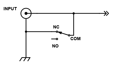

You could try a simple muting relay across the output of the preamp, one which is normally short to ground and opens after a delay. That way there is no signal degradation due to contacts etc. Dead easy to do with a relay, a FET and a C/R delay. Nothing else needed.
Have a look a the muting circuit of DCB1/Mezmerize that has a muting circuit like a quality device should have but there are others. A handful of parts. The point is to use a micro relay shorting outputs to GND (like the invention of Herr von Doofenstein was) and not relay contacts or even semiconductors in series with the outputs as that can have negative influence on sound quality.
Muting circuits can be a simple or complex as you wish.

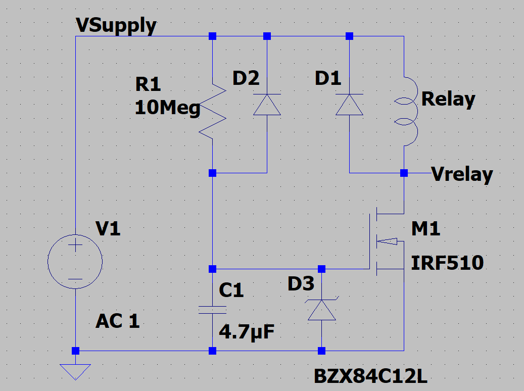

Here is a super simple idea using a single FET (a 2N7000 type would be ideal but you could use a bigger power FET). The cap would have to be a low leakage type, not an electrolytic. The Zener is not needed for 12 volt supplies.
Supply appears 10 seconds in here and goes off at 40 seconds.
Looking at your circuit and you could use the 24 volt supply and a small 24 volt relay which would have a high coil resistance. That would need the Zener to protect the FET but might be better than a low voltage version pulling relay current from the resistor/Zener supply of the buffer.

This circuit worked like a charm! Only had 9V relays on hand so used a 2N700 with a 9V supply.
I used a 4.7uF electrolytic cap and got 15 second delay, before the relay engaged and moved to the NO contacts. A 10uF electrolytic got me 30 seconds of delay. Why did you suget not to use elctrolytic?
Going to wire it up so common is the audio signal and the NC contacts are the ground.
It is because the leakage current would tend to dominate and might even prevent the cap charging enough due to the high value of charge resistor.
Lets say the cap has reached 7 volts on a 9 volt supply. That means you have only 2 volts left across the 10meg (in my example) and that only gives an available current of 2/10,000000 which is less than the leakage current of a typical small electrolytic. So the cap would never even charge.
Ok I will make sure I once again breadboard with the exact components I use to make sure they will work in the circuit once built. Going to pick up a 12V relay today.
I guess the play would be if using elctrolytic to use one that has the lowest leakage current, right?
Definitely trial and error to get your timing values if using an electro. A tant might be usable.

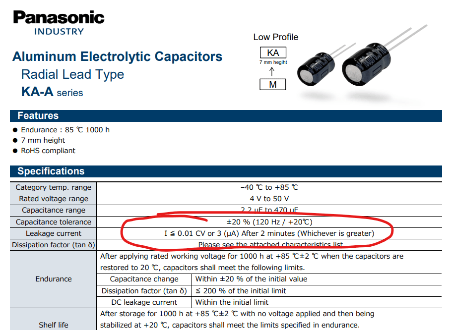

Here is a typical data sheet. 3uA or 0.01CV, whichever is highest. 4.7uF with 10 volts across it is (4.7E-6 * 10) * 0.01 which is 0.00000047 which is 47uA. That is worst case, presumably with the cap at its max temp rating.
So lets say we have 5 volts across the 10 meg resistor. That gives us just 0.5 microamps of current available. So the cap could never charge, The leakage dominates. As the voltage across the cap rises (as it charges) the less voltage (and so less current) is available across the 10 meg to charge it.
So trial and error. I would begin with a good quality film cap I think

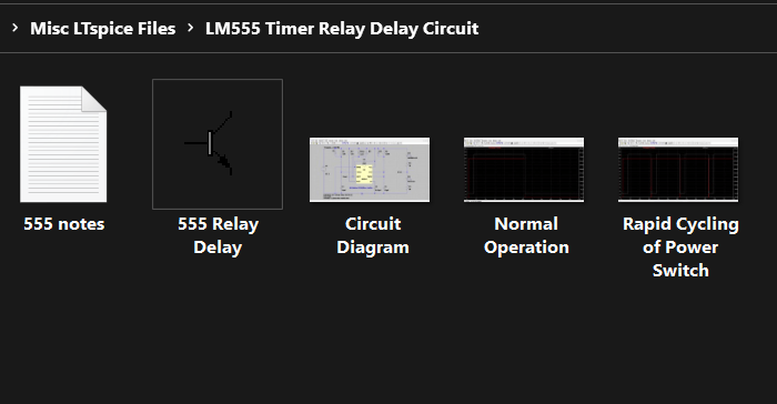

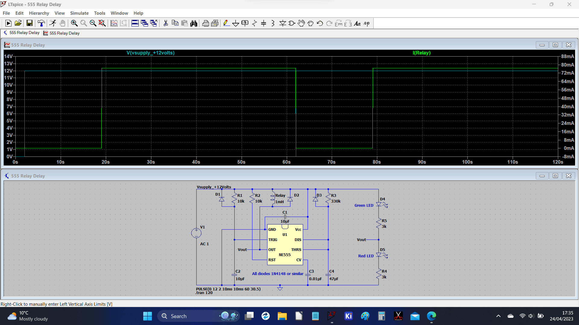

The 555 is a great chip to play around with. This is a circuit I did a couple of decades ago to give a delay to the output of a preamp. The circuit also generates the full delay if the power is cycled on and off quickly and it also has visual LED indication.
The zipped folder has some notes along with the sim.
Contents of folder:

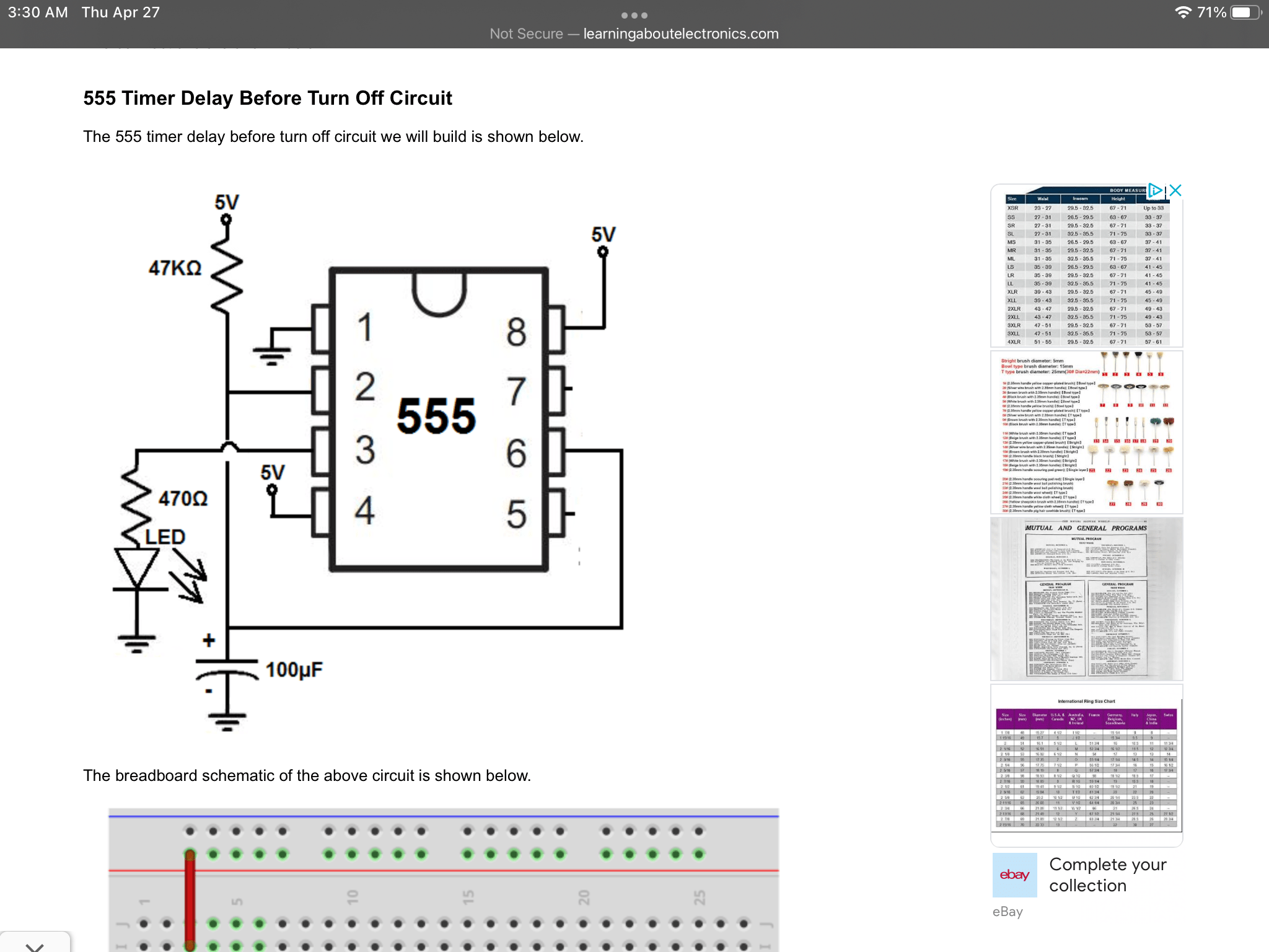

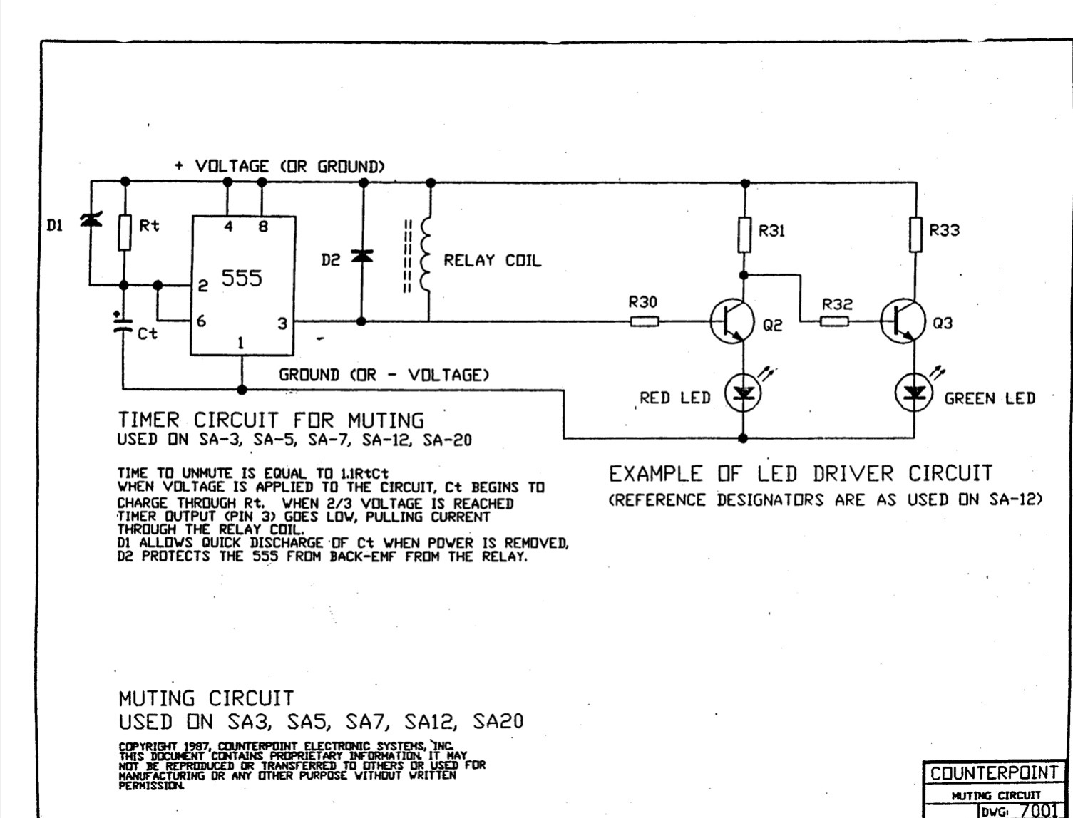

A very simple mute circuit to use is this delay before off setup using a 555, Counterpoint used this, but added a LED driver, and relay.
