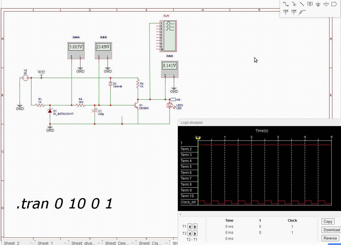

Hi everyone,
I am hoping to implement one of the solutions presented on this thread :
I have entered the first circuit into EasyEDA (standard Windows install version 5.4.46) because I have all the parts already.
In the second photo from the thread we see the simulation working as desired, with 3.6V for one second and then dropping, however, in my EasyEDA, the simulation does not turn on the LED and the voltage at output is 0.6V.
Can anyone see the problem? What must I add to for it work?
I tried adding a 1M resistor in parallel with C1, and then the LED does light up and we have 1.86V on the output, but it never drops.
Thank you for any help.
EJ

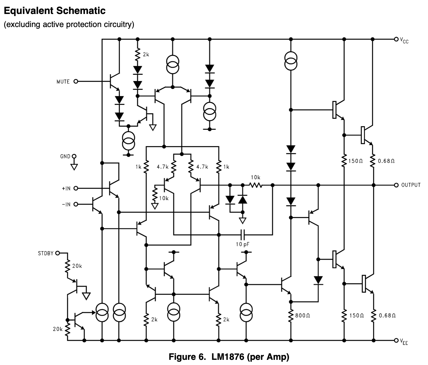

Hi all,
I am currently working on implementing LM1876 based amp and ran into the issue with the mute and standby pins.
From the datasheet, if a logic high (1.5 to 5V) is applied to the MUTE pin, the amp will be muted.
The goal is to mute the amp during the turn on (and turn off).
For that a logic high needs to be applied to the MUTE pin when amp is turned on, but after 1 or 2 seconds wait time the MUTE pin should be pulled low (< 1.5V).
EJ

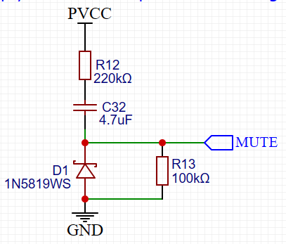

I have recently been working at TI amp in the TPA31XX range. They also use a logic low MUTE function. I have implemented, simulated, and tested on a PCB the following mute circuit that seems to work.
My design was a based on a 24V supply (not the 25V you show) and I was driving for around 2s to reach a 2V logic level. You can play with the resistors and capacitor values to get to where you want for your 1.5V. This design shows about 2.5 seconds to reach 1.5V at 25V supply. This one wont help with power off, but making a circuit to do both would be much more involved.

The LM1876 is MUTED at above 2.5V, so this looks close as it.

I’m wondering if the EasyEDA simulator is working correctly. The original poster used TINA-TI which is free via TI. Try simulating in that program. The only item you MAY have to add is the 5V zener diode, but there’s lots of examples online of how to add the spice models to TINA. I’ll see if I can make it this evening as I like this circuit as well.
I didn't have time to model this up last night, but I did some calculations and I think that 30K resistor is too large. For a collector current of 25mA, you'll need more base current to turn on the BJT. Lower that resistor to 16kohm and see what happens in your EasyEDA simulation. Again, it'll depend on how accurately the simulator is modeling the BJT, but my review of the datasheet (and a refresher on my BJT basics from 20+ years ago in school) show you need more Ib.
