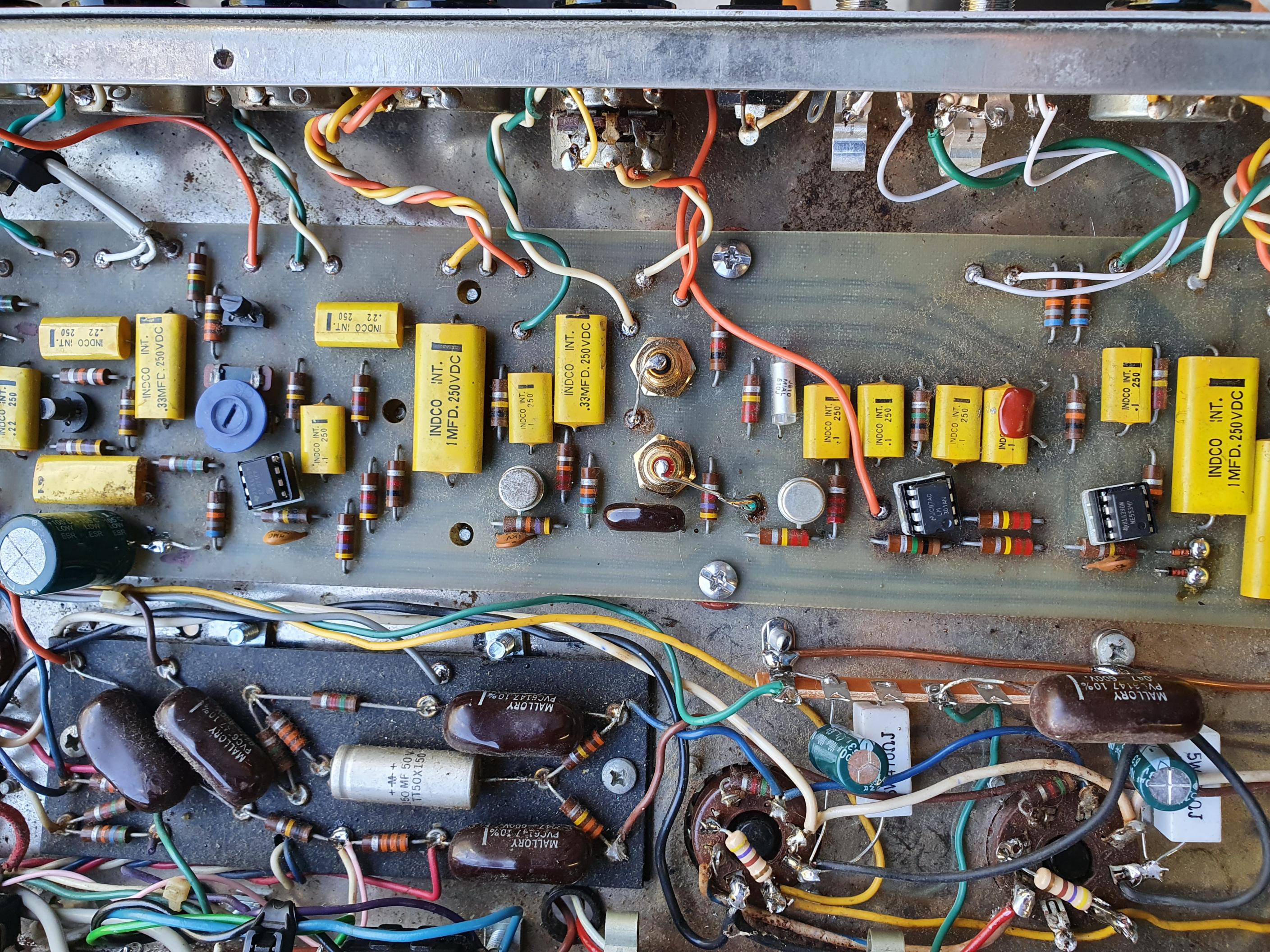

Im not offended at all Kay , this is not the tube amp section so I expect this may not be the place for tube topology .......its more about the op amps...
it would seem they are cascading ... the first two seem to amplify cleanly then depending on how much gain you place on IC number 7 is how much it will get over driven...I could be wrong though..
so would an alternative chip be capable of handling the excessive drive....I wouldnt know where to start looking or it anything like that exists

The preamp section basically consists of three gain stages for both channels: The first stages' gain is 23, the 2nd stage's is about 6 in the 1st channel and about 5 in the 2nd one, the adder provides a gain of about 20. As there aren't diodes or other devices to add some distortion, this design exclusively relies on the LM307's distortion, which some may like, others not so. If you replace these with other single (!) opamps, the amplifier' total sound surely won't be the same anymore.

Please, don't tear anything out yet. You mentioned a 470R cathode resistor on the 6V6's -- what's the DC voltage across that? That seems like an awfully large value to me. Do you have all 4 sockets occupied, or just 2 6V6's? How about voltages on the 2nd 12AX7 stage?
Even without an oscilloscope or proper signal generator, there are lots of operating point measurements that you haven't yet reported. If we can get those sorted, it will be time to take advantage of some of the online resources for test signals.
Sure sounds like a power amp problem from the symptoms you're reporting; bet Kay Pirinha's note about the 6V6's having much lower gain is dead on. Also suspect your 6V6's are operating too near cutoff.
As for gain improvements, maybe start with a Cathode bypass capacitor on the 1st 12AX7 stage. That is something notably different than the Weber schematic you posted, and the phase splitter cannot provide gain without wrecking symmetry.

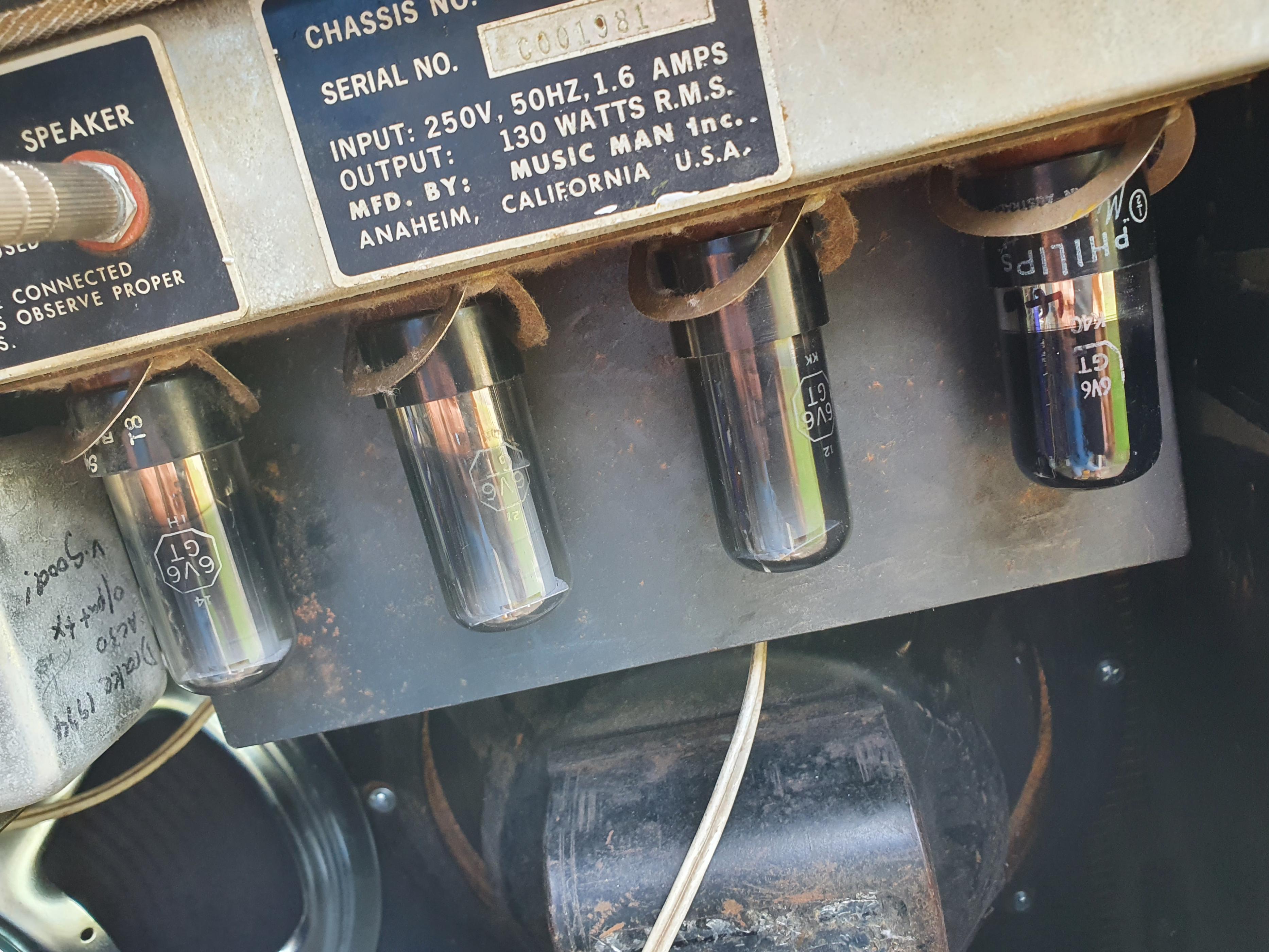

Hi again , all 4 sockets are occupied ... I measured the voltage across all the cathode resistors and got just on 20vdc on high and 13vdc on low settings (plate voltages of 360 and 250 vdc)
On the gain stage of the 12ax7 the cathode is measuring 1.6vdc .....there is no bypass cap on this as it is still in its original MM format...same topology differing values to the Webber...
The value of 470 ohms would be too high a value if all four cathodes were attached but in this case I have gone the safer option of having a resistor for each tube so that if one fails the others remain stable ...the one and only drive from the single triode seems to be where it should be...

I went to do an A/B with the LM307 on IC number 7 but when I pulled it out I couldn't get another one to go into the holder....I messed with it a bit but just ended up bending pins so I guess I'll be upgrading that one as well ....

Thats a problem I have encountered many times due to the IC sockets of those old IC,s "stiffening up " due to "metal aging " ( molecular change in the composition ) .
A grid bias of -20 V, as per the voltage drop at the four individual cathode resistors, appears to be ok with a plate supply voltage of 360 V.

Though it may be safer for the tubes, 1:1 / cathode:resistor, may not please the output transformer. Some do not well-tolerate DC imbalance so happily -- you may have some saturation.
The reason I wondered about the phase splitter voltages is, it seems a tall order for a 12AX7 to be trying to drive four big power tube grids -- especially at the thin currents likely resulting from the 1k5 Cathode bias resistor.😉

Hi folks well the board stayed close to where it was as before ....I did some replacements on three of the old TO-99 sockets and taste tested the chips to see what could be done without too much effort...one channel I left untouched and the other , chip one is a NE3354 , chip two is a LM301 , and they sum into a TLO-71
I must say the new chips sound much better than the older LM307h's
This gave the cleanest result with the most amount of drive ......but the 6V6's were still asking for more , so I installed a 6C4 tube with a modest amount of drive and took the amp from cathode bias to fixed and I'm happy with that ...a few extra volts helps...
I also disconnected the feedback , this gave me some more noise with no significant changes to the tone ...
My feelings are is that the output transformer is a little inefficient .....I put some voltage through it and done the maths and came up with 3.6K.....its in the ball park for 6V6 but being AC30 I thought it would have been 4K....
I would be happy to do my next gig with this amp ....
Maybe this will help another adventurer along the way in future ....
