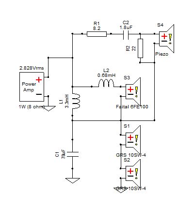

First, the box. You’ll need about 50 Litres (1.77 Cu Ft, if you must use those antiquated colonial units) for both the GRS drivers, plus another 10L (0.3 Cu Ft) for the Faital. Note: The Faital requires its own internal box. A front panel of 12” wide by 32” High should accommodate all the drivers, and with an internal depth of 10”, will give the required volume. This will give a 1.5dB hump at around 88Hz, which should be OK for your style of music, and an F3 of 50Hz, which is good for PA.
2nd, the crossover. Attached is the simplest I could come up with. Notes on the parts:
C1 – a non-standard value, use 68 uF + 10 uF in parallel, they should be Bipolar, with a 100V rating
L1 – Use the best air core inductor you can afford, probably the most expensive component. Go for the lowest DC Resistance
These are designed to crossover at the Baffle Step Frequency (380 Hz), so keep your front panel at 12” overall width.
L2 – air core
C2 – polypropylene 100V
R1 & R2 use 10W rating
3rd, access to a tool shop is all very well, but if you don’t have experience with those tools, find someone to show you how to use them safely – it’s very easy to loose body parts

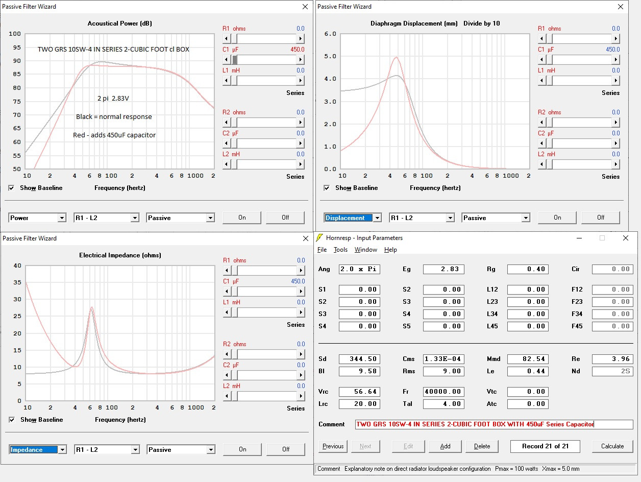

HI - looked only so far at the GW "subs" - seems like a real good driver.
I used Partsexpress specs and assumed a closed 2* cubic foot box (* 1 cubic foot for each driver) will be about ballpark. The drivers are in series and that eases my idea of converting that to a "3rd order closed box" as the magic capacitor value for 8 ohms is usually around 450uF. The capacitor: flattens the bump; extends the low end; and reduces excursion below cutoff. The small penalty is increased excursion in the area where the lows are extended and that comes from pulling more power from an ~constant voltage source due to lower impedance in that region/ (look at the red traces on these graphs)
Two 10 per side should move some air.
Hey Pete - can the 450uF cap I suggested for "3rd order" be incorporated in your crossover scheme? It might be best not to do it as another part to worry about.
Can he use a 3.3mH steel I-core choke in place of the air core to save money?
Partsexpress has pretty nice I-core: $5.88 for 3.5mH. If worried about saturation, then two 1.5mH (0.24 ohm dcr each) could be spaced and placed in series for a half ohm 3mH choke. That's less than 10 bucks for the woofer choke. (parallel combos could be used too - but too expensive)
Dayton Audio 1.5mH 18 AWG I Core Inductor Crossover Coil
add a 2mH for "3.5"mH and that's pretty close to your 3.3mH spec and still around $10 for both chokes
Dayton Audio 2.0mH 18 AWG I Core Inductor Crossover Coil
There's absolutely no need to worry about the saturation of an I-shaped core. Since there's a big airgap between its ends, it's just not going to saturate, ever.

Hi Freddy, re:'can the 450uF cap I suggested for "3rd order" be incorporated " sure, why not, probably the best place for it is in series with the woofers. Either that or between the amp and the rest of the crossover.
re:'steel I-core choke' sure, it'll be cheaper, and at most volumes should be OK, I was just concerned how it would behave when driven hard; Newvirus has a good point.

Here's a quick design for the GRS 8" with a piezo tweeter: This needs a largish box, I went for 40 L (1.4 Cu Ft) sealed, which will give an F3 of 49Hz, and a 1.5 dB hump at 86Hz. Both this and the previous design may need a reasonable amount of internal stuffing.
Crossover attached:
S1 is the Piezo; S2 is the GRS 8"
