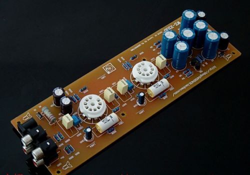

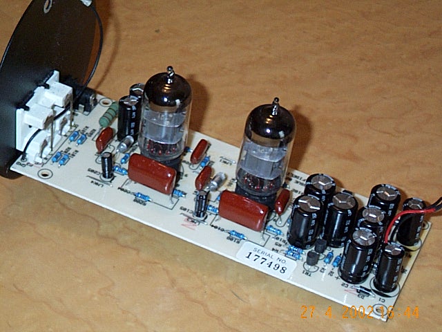

Here are some pictures, two of the original and one of 'your' board:
Cheers Mike. it does look like they've made a clone, judging by the looks of the thing. Good valves and some cap upgrades seems easy enough, what do you recommend for good valves - some old NOS like Mullard or Brimar, or NOS Russian/Soviet ones?
