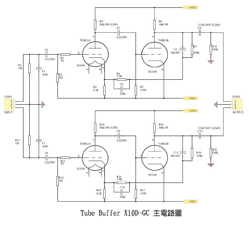

tube buffer x10-D with 6n23p-EV
Hi all!
If you replace this 6DJ8 in bafferu with Russian tube 6n23p-EV ate some changes are needed in the schemayics?😕
Here is the seed buffer X10-D
Thanks for your help!
