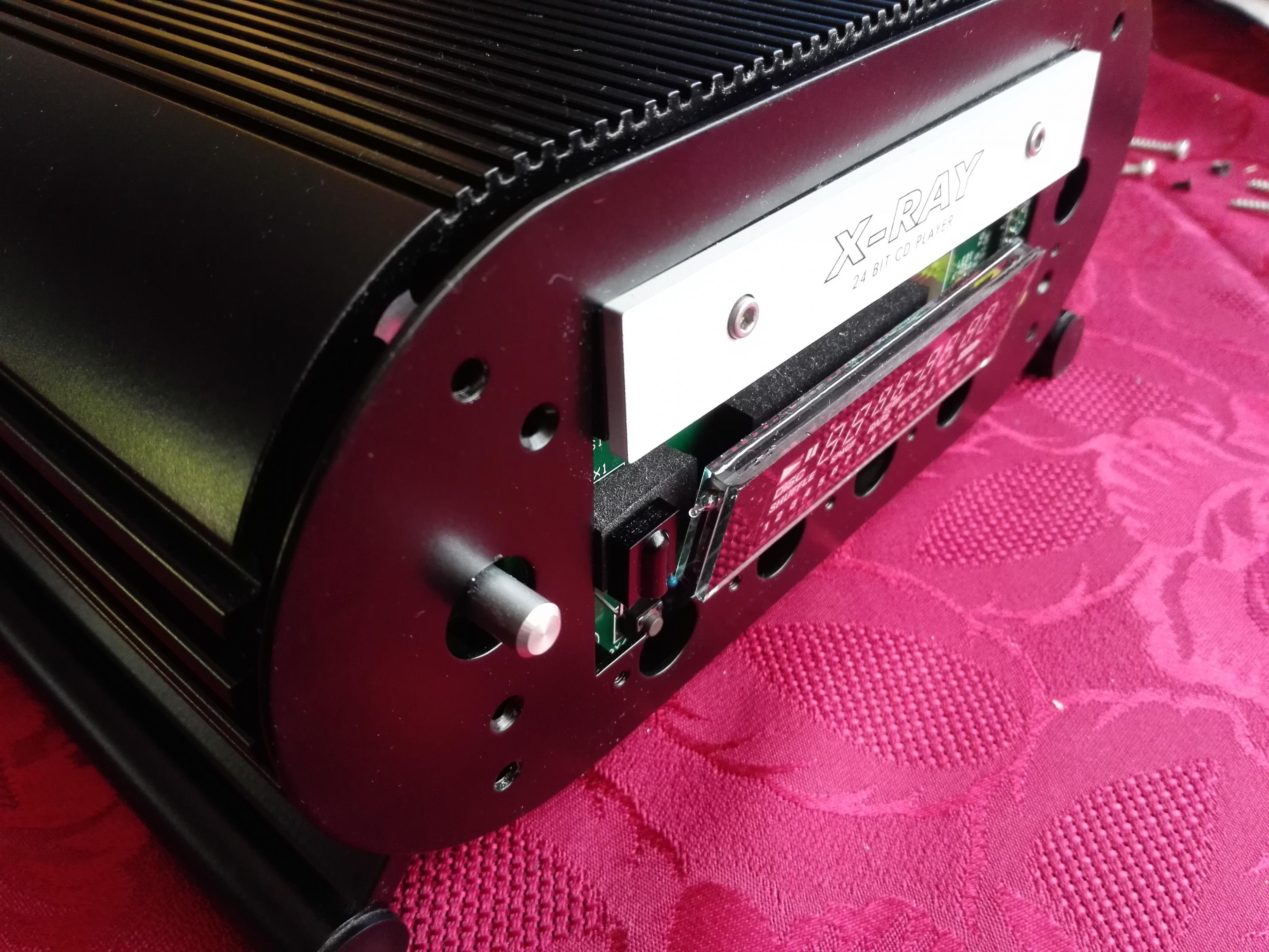

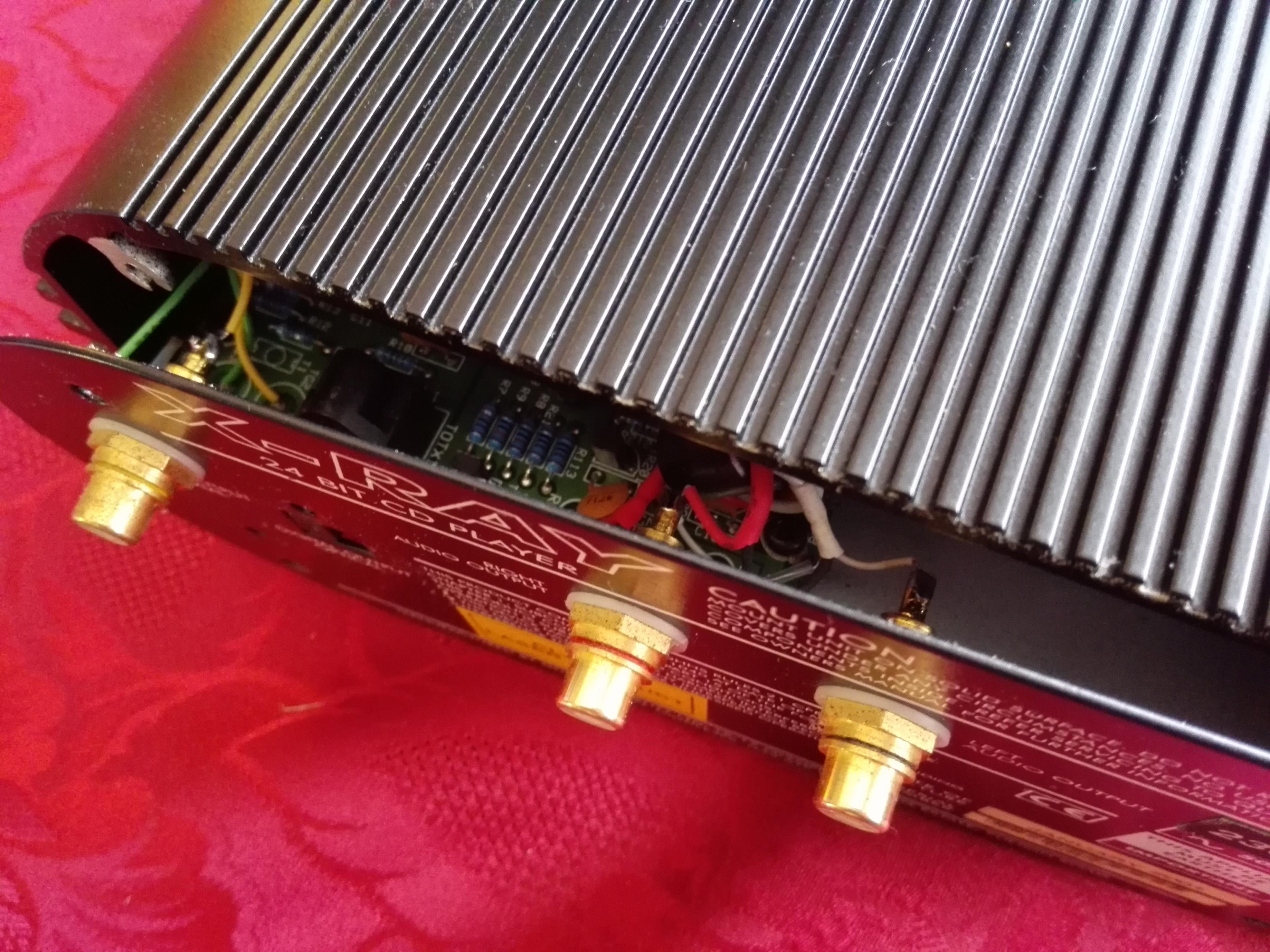

I am trying to take your advice by opening the X-Ray but am unsure how to proceed. I have undone the 6 screws at both ends and have come to a stop as I don't want to force anything. Please advise.........
Many thanks

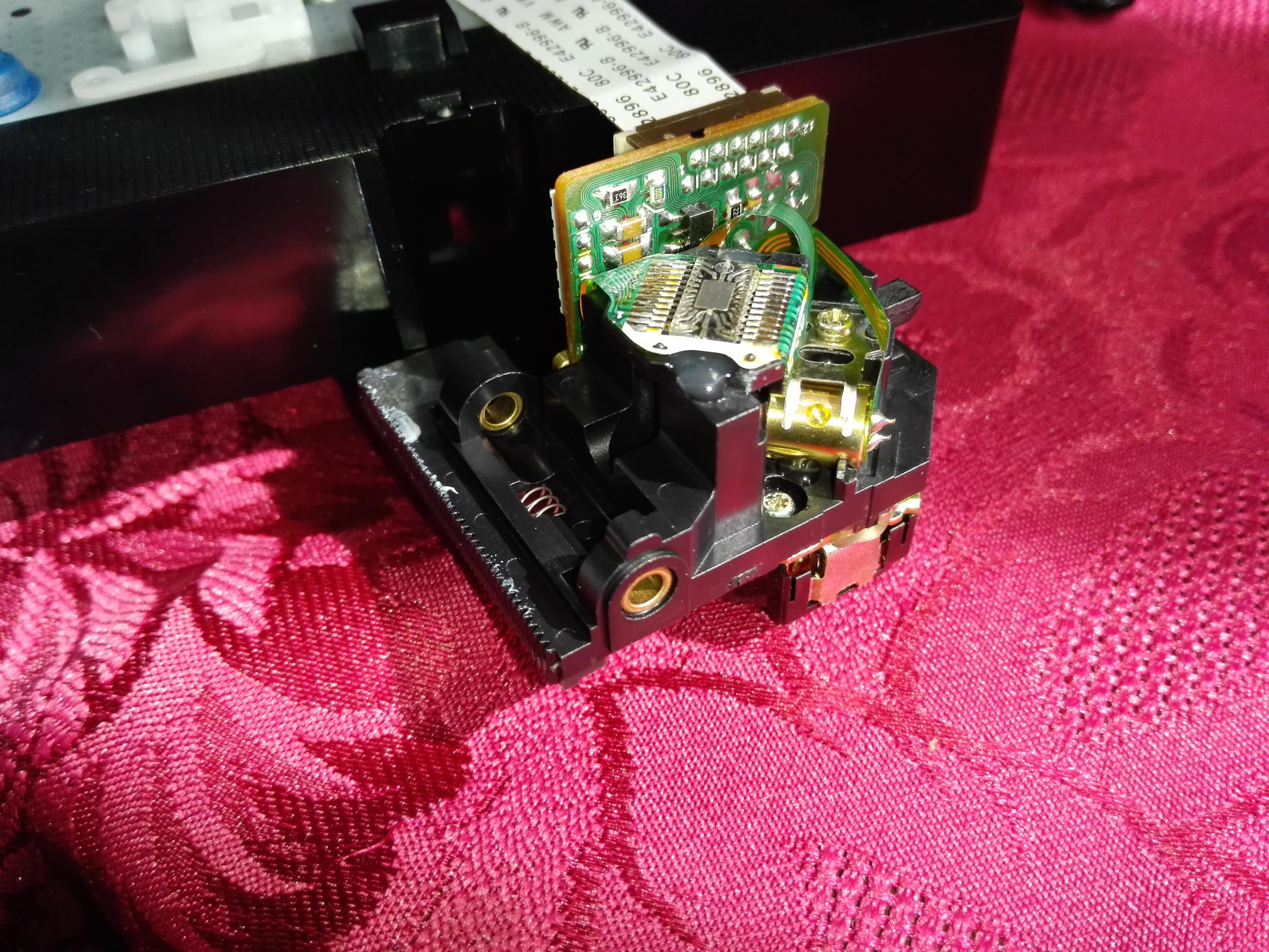

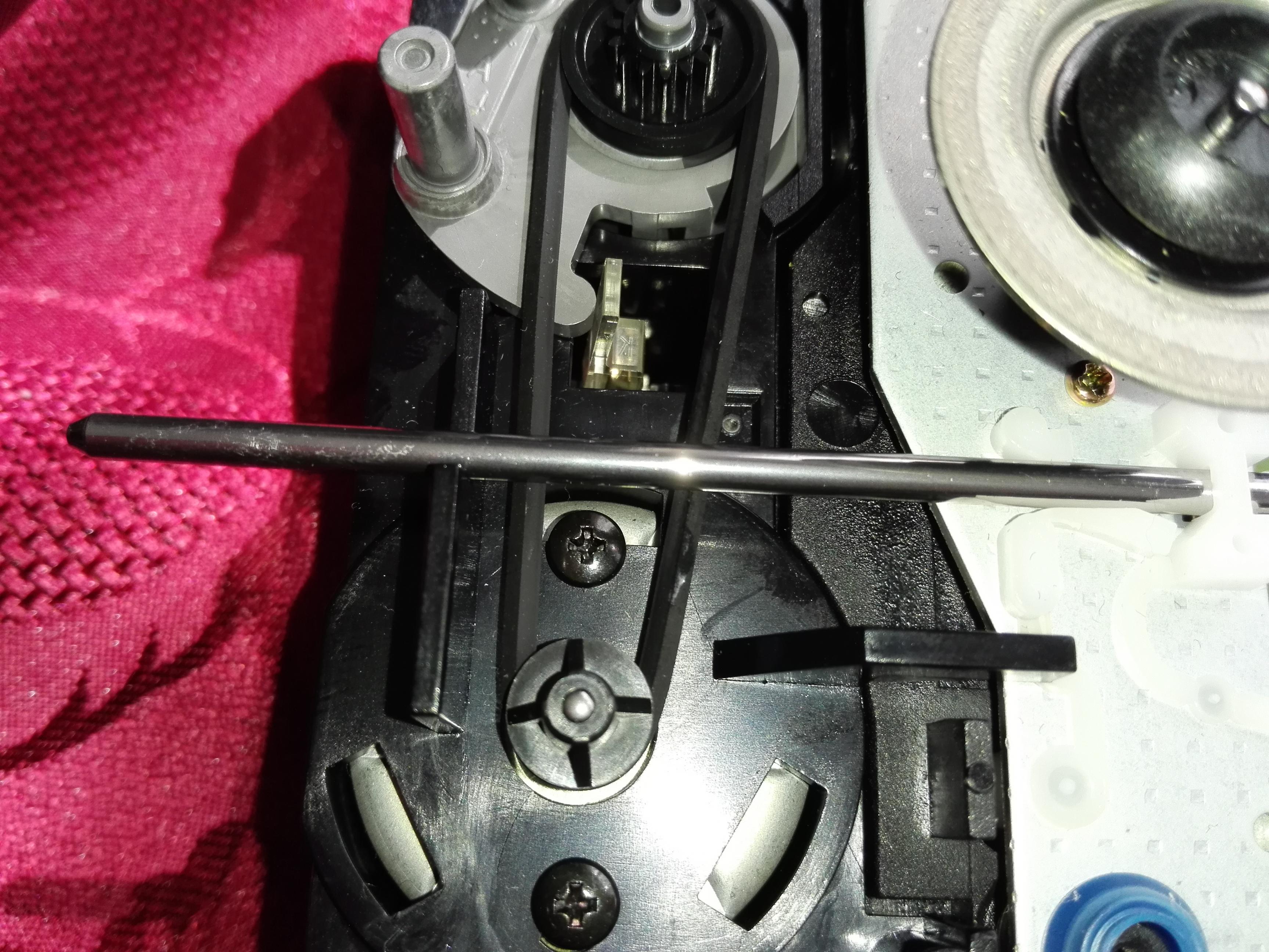

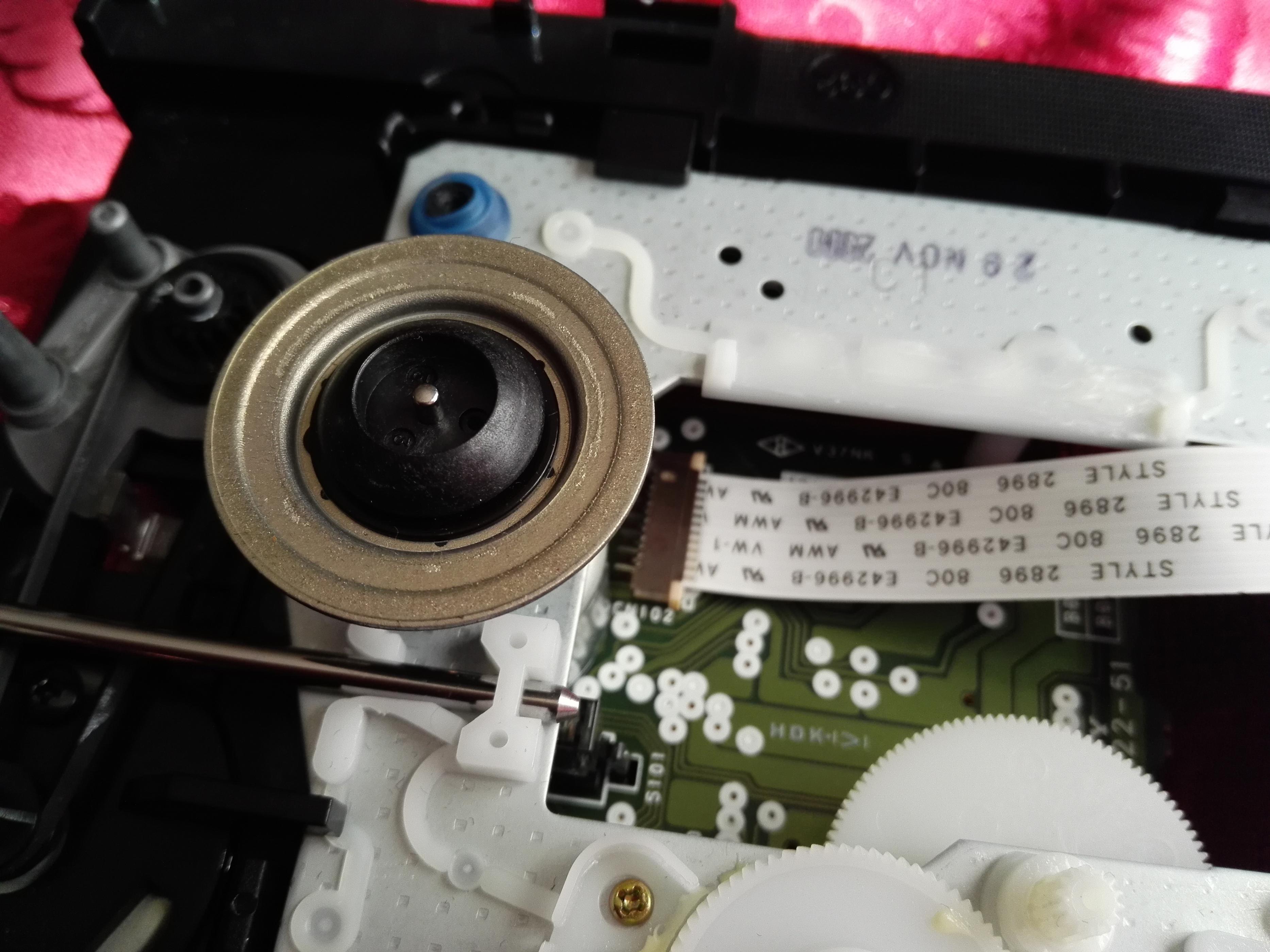

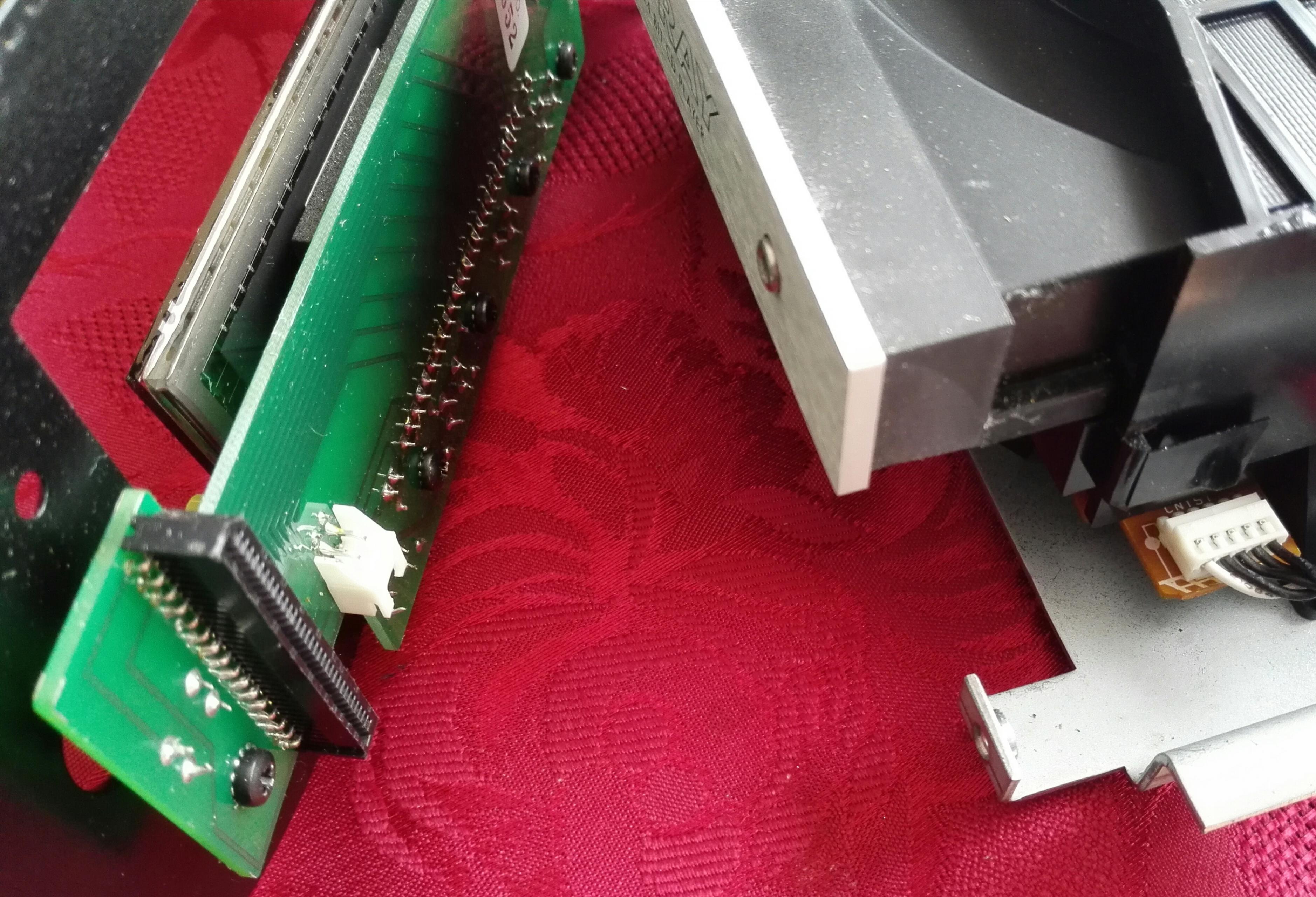

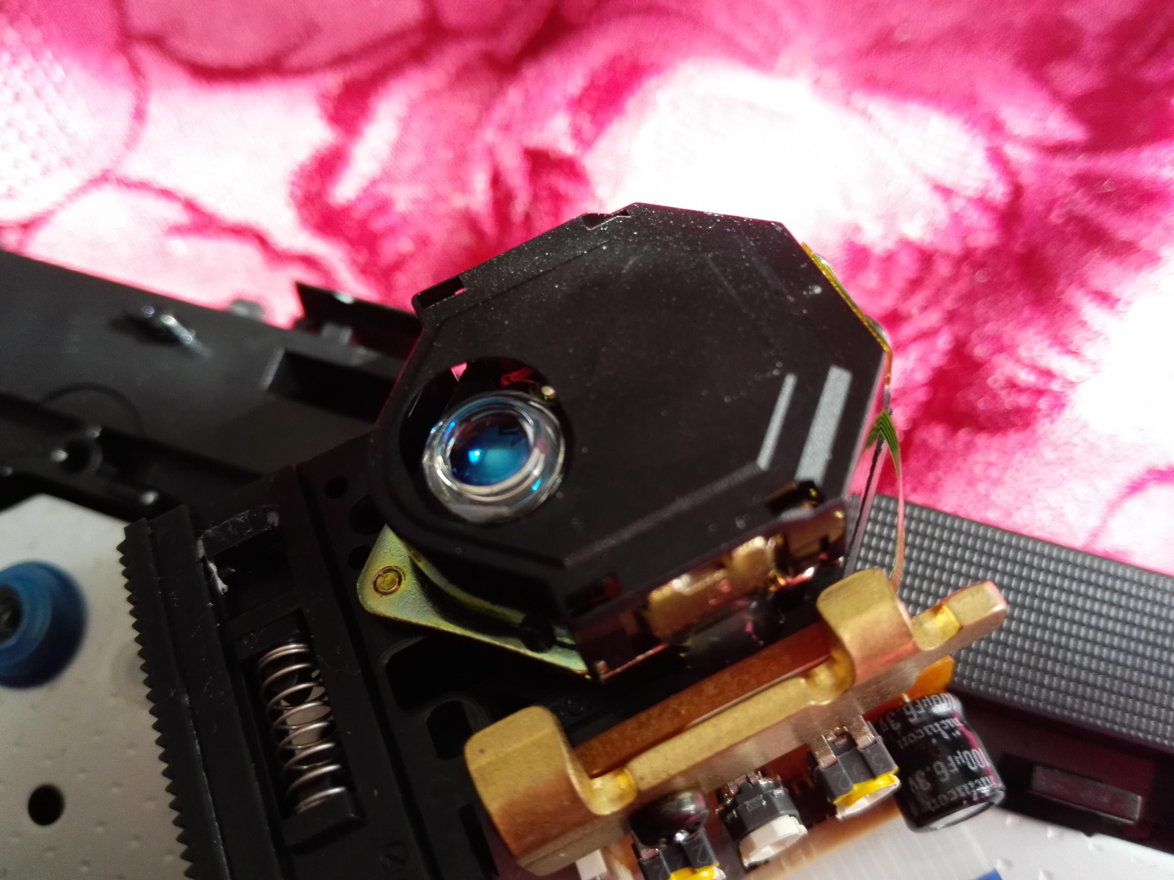

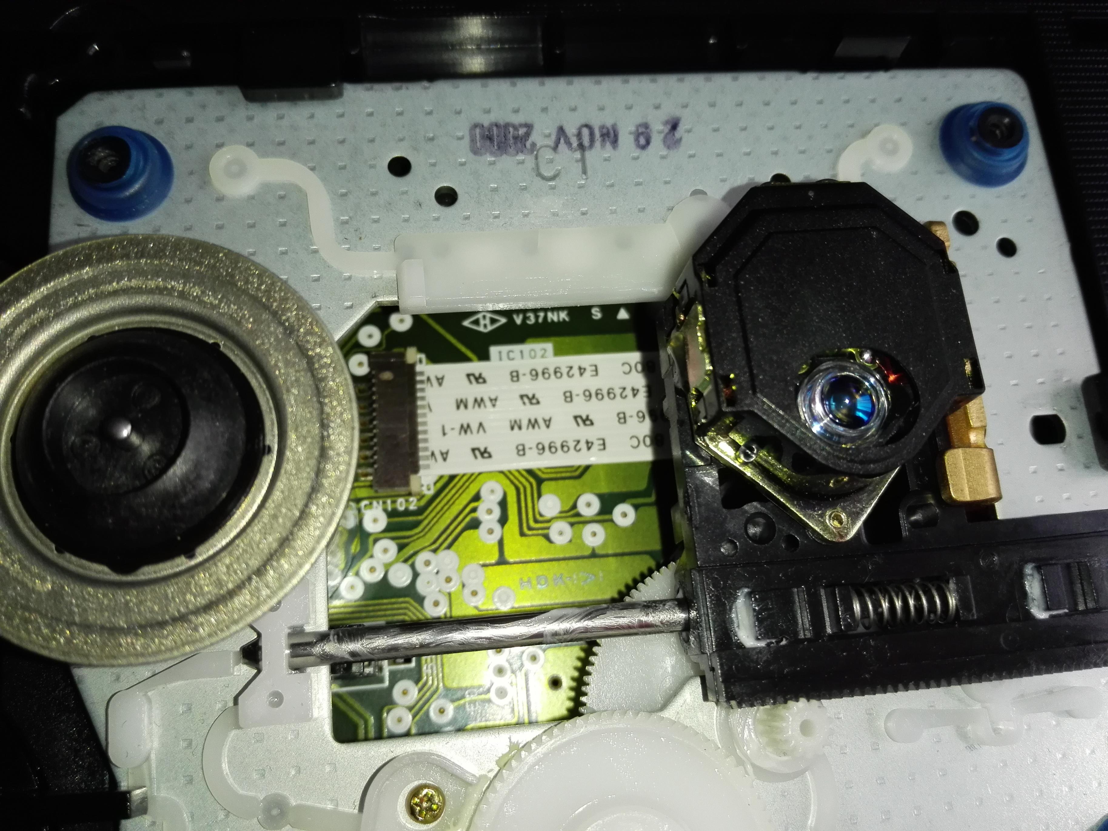

Got it. The whole internal assembly must stay forward towards the front. No need to remove the two SMALL screws from the rear. Then the front board which the readout is attached to can be moved over the threaded part of the chasis, remove the ribbon cable, put the readout panel aside and push the whole assembly out backwards............

Exactly the wrong stuff. Lenses need to be cleaned with water and a tiny drop of mild detergent (dish washing soap). Q-tips are excellent for this. just turn circles on the lens with a very small amount of the water-soap mix. After cleaning please do it again with a dry Q-tip.
Oh dear, too late. I hope I havent done any damage. Though I did read elsewhere (sorry can't remember source) that dish washing soap is mildly abrasive (which is also why it shouldnt be used on car bodywork) and therefore unsuitable:confused:

Have a read at this which was all about the KSS240 in Sony player:
Sony CDP790 and KSS240 Restoration Project
Some KSS240's suffered with lens suspension problems and unfortunately there is nothing you can for that apart from replace the pickup.
ISO is very harsh for lens, in particular the coated optics. Sony in the early days of CD issued a bulletin to that effect and warned against using it.
Having exhausted my supply of official Sony fluid I find that a mix of around 80% water and around 20% ISO together with a single drop of washing up liquid (same idea as Jean Paul) works brilliantly. That's a single drop of wash-up liquid to around 15 to 20 ml of fluid. Cotton tips only, not polyester one and I tease the end to make it much softer. Twirl it around the lens to clean and once dry the lens should look bright and sparkly if lit with a bright torch.

OK, I won't do it again, I just hope I've not made things worse!
Thanks for the link, what a massive subject. If the X-Ray doesn't play nice after testing I might buy a laser assembly from CPC and see if it fixes the problem. For the price it is worth a go to try and save what was in its day an £800 player.
